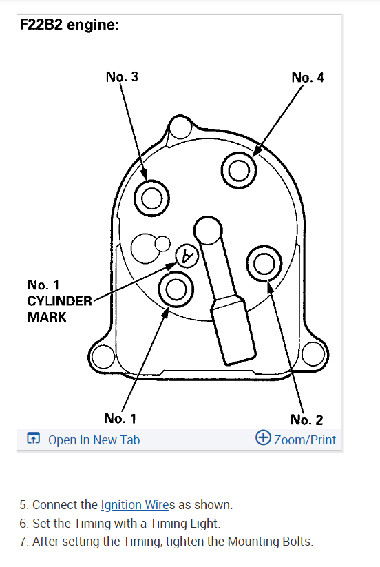

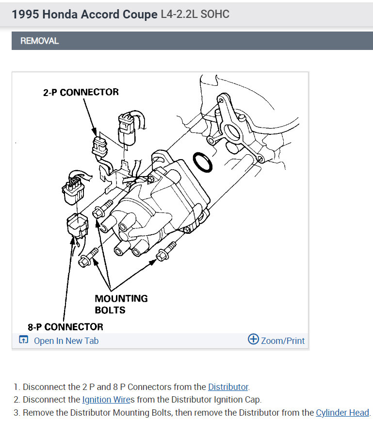

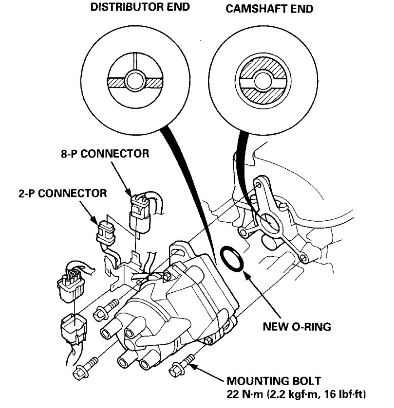

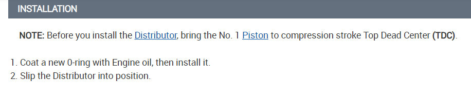

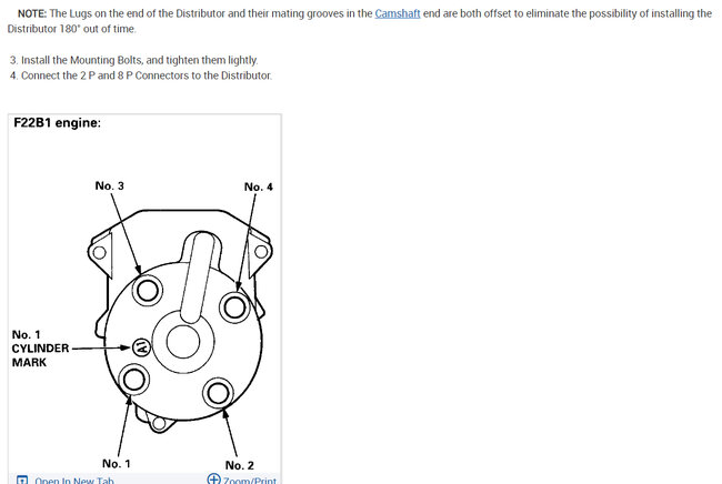

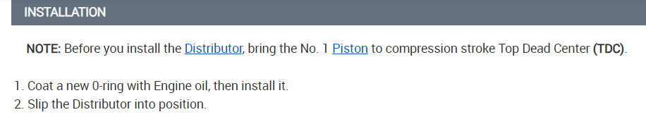

It sounds like the distributor is defective which is common, the fuel pump is triggered by the ICM inside the distributor housing. I would get a replacement and install it. Here is how the job is done correctly in case you need it. Check out the images (below). Please upload pictures or videos of the problem so we can see what's going on.
