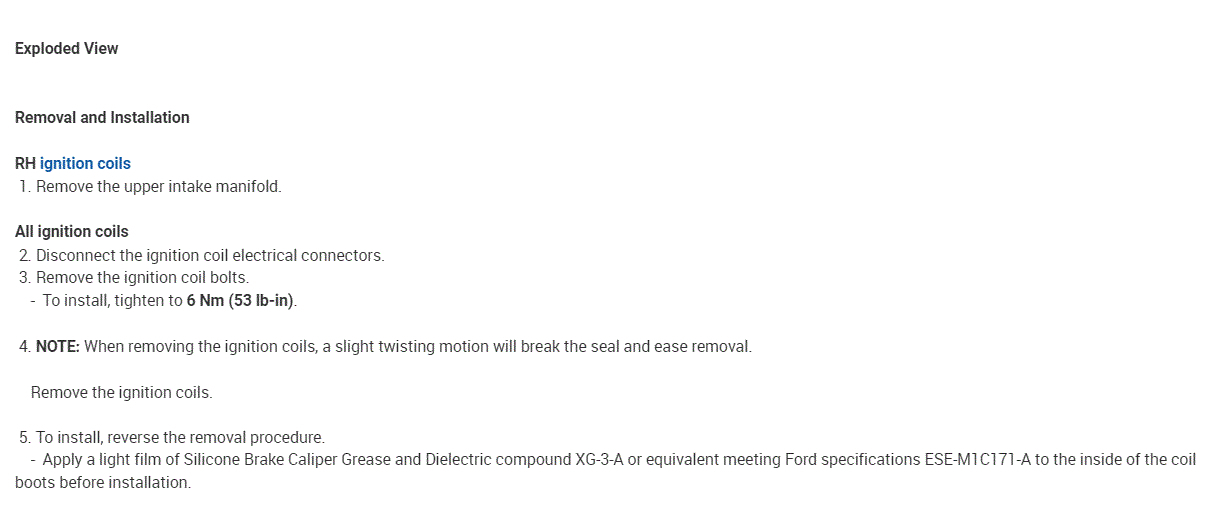

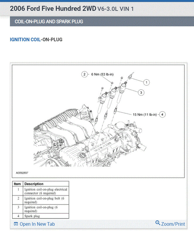

Checked spark plugs no spark and my coils are corroded. What do I need to buy to replace all of my spark plugs and ignition coils?
Mar 5, 2022 at 5:25 AM
  • CAR REPAIR CONTRIBUTOR
  • 110,190 POSTS
Nathan, did this happen all at once? If so, I don't think all the coils would have failed at the same time.
On this vehicle, each cylinder has its own coil pack. So, that means you would need six coil packs and six spark plugs. My concern is that it won't make a difference. Also, to access all coil packs, you need to remove the upper intake manifold.
By chance, do you have a live data scan tool? Or does the vehicle have a tachometer? If you have a scanner, see if there is an RPM signal when cranking the engine. If you don't have one but the car has a tachometer, see if it moves a bit when the engine is cranking.
I did attach the directions for replacing the coil packs. Once they are removed, you will have access to the spark plugs to remove them.
