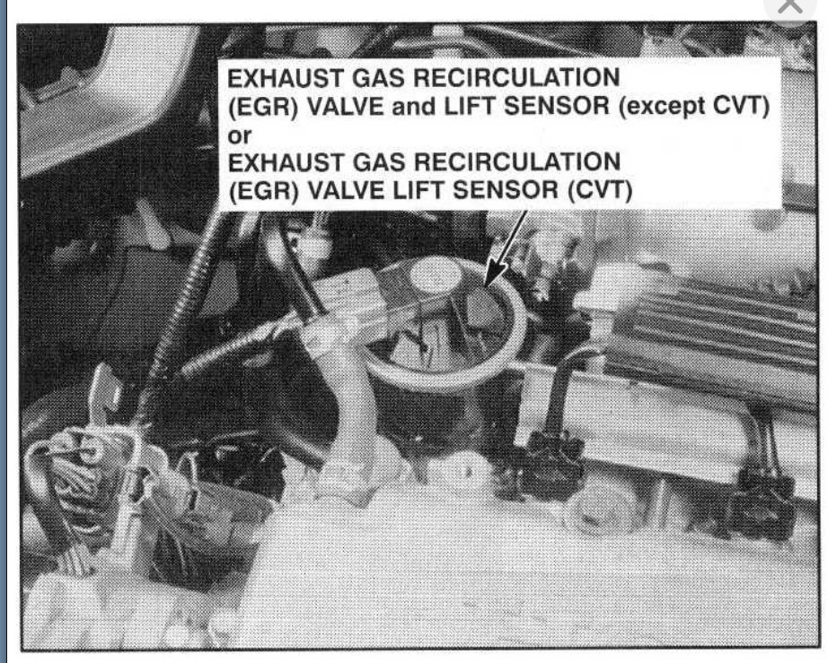

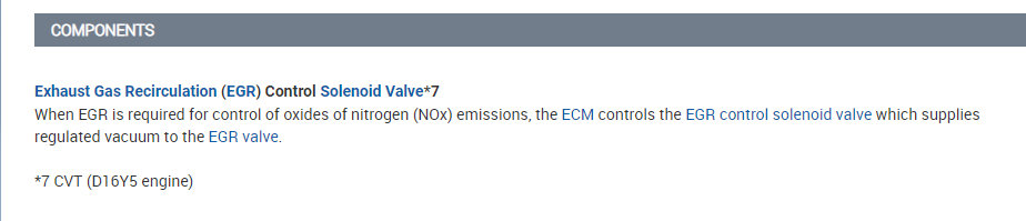

The only other thing that I can think would cause this at this point is the EGR is opening and sticking causing the engine to run rich and stall then it will not start again until it cools down.
I attached the testing that we need to run through in order to figure this out.

This might sound stupid, but my trim model is a DX. did those come with EGR?
Mar 10, 2021 at 10:15 AM

Yes. A video would be great. Also, your vehicle does have an EGR. The DX is just a trim package and doesn't alter any major engine components.

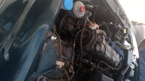

Here is the video of the car idling good:
Mar 12, 2021 at 3:48 AM
LUIS MEDINA
  • 27 POSTS
And here is a video of it turning off:
Mar 12, 2021 at 3:50 AM

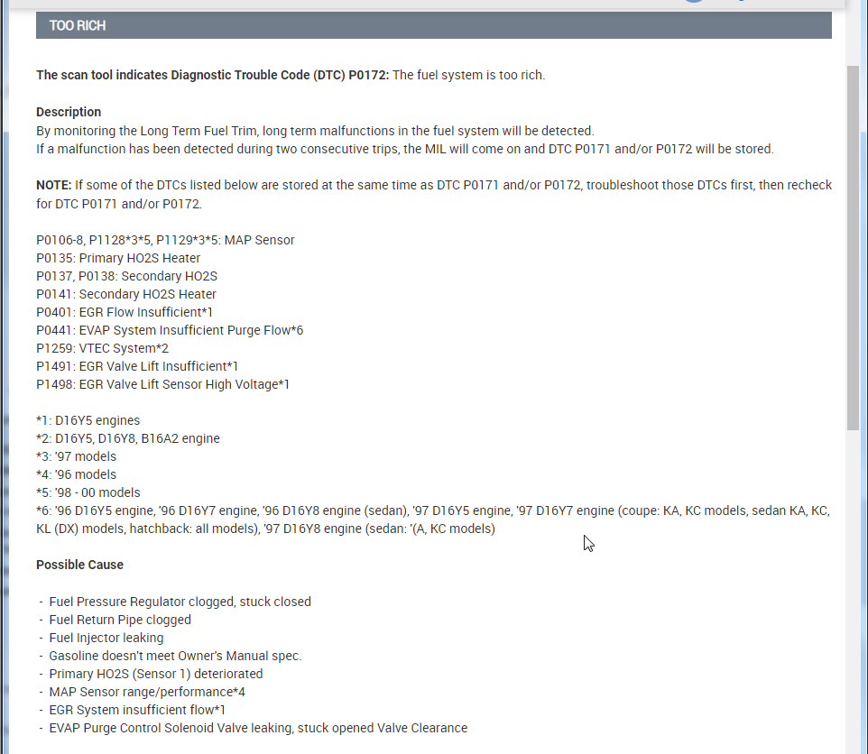

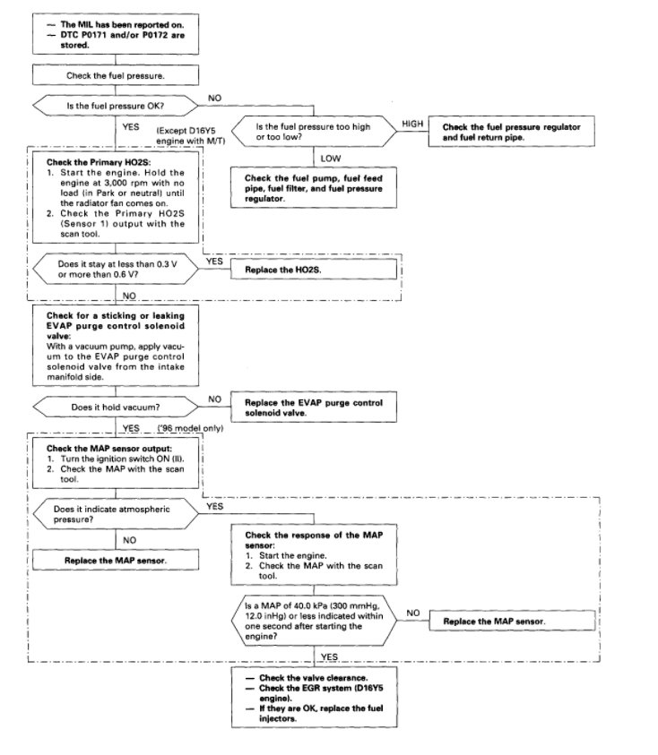

That does help. Clearly the issue only happens when the engine is up to operating temp as you mention. So that means what happens when it is hot vs not? The main thing is it switches from open to closed loop. That means when it gets hot the ECM starts using the sensor data to adjust the fuel and ignition.
If the o2 sensors are not accurate then it could cause performance issues resulting in a stalled engine.
Next we need to monitor the o2 sensor information with a scan tool if you have one. That will help confirm this.
Also, the purge valve is not opened until the engine is at almost 170 degrees. So if the ECM is opening the purge and it is sticking open once open, it will flood the engine and it will stall and not restart until the fuel evaporates.
Less likely could be a valve adjustment issue so was there any recent work done to the engine and this issue started afterwards?
Are you able to keep the engine running by giving it more throttle?
Lastly, let's run some injector cleaner through the engine. If the injector(s) are hanging open then that will flood the engine as well.
