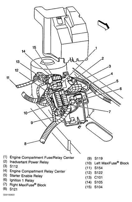

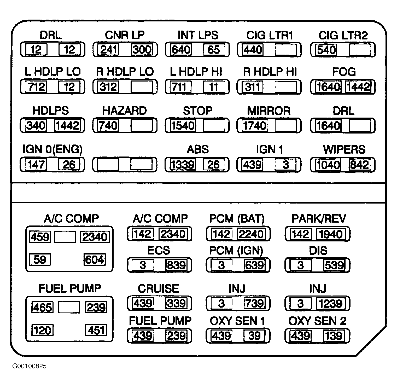

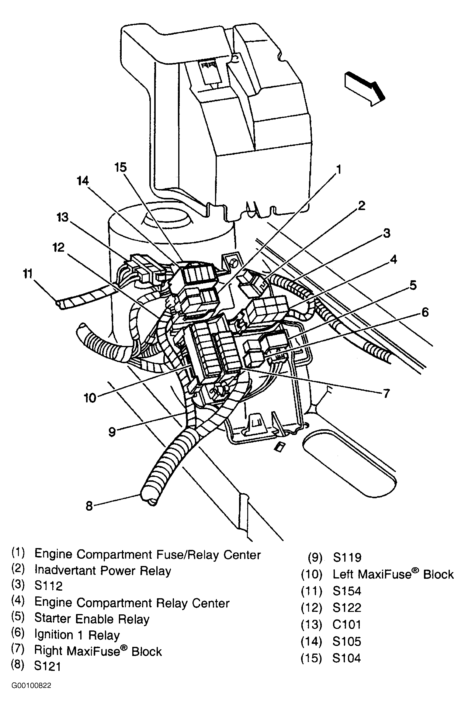

If you are wanting to check the fuel pump fuse it is under the hood in this fuse box and the fuel pump fuse is shown at the bottom of this second diagram in that under hood fuse box.
