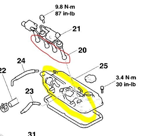

Hi Joe, I forgot to mention that the tech told me on Sat 5/25/19 that I needed a valve cover gasket. He said that could have been causing an issue with the spark plugs and wires because oil was leaking in a tube. I don’t know what tube he was referring to. I had a new valve cover gasket installed. The engine light has not came back on as of yet.
May 28, 2019 at 9:47 AM
  • 110,251 POSTS
Welcome back:
Honestly, he is correct. I attached a picture for you to look at. I circled the plug wire boots in red and in yellow is the valve cover. The boots go down inside the cover to reach the plugs. That area is referred to as the tubes. There are o-rings in there that prevent oil from leaking into the tubes. If it does, over time it will damage the spark plug boots causing an arcing. The result is usually a misfire.
Take a look at the picture and let me know if you have other questions. Also, if you get me the 500 series codes, I will help you get that taken care of.
