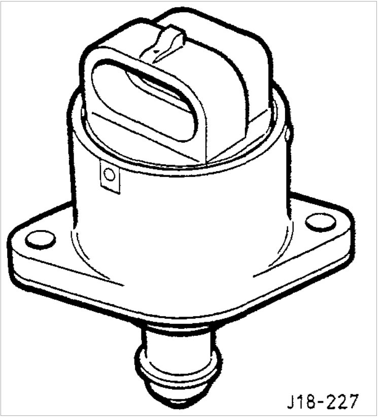

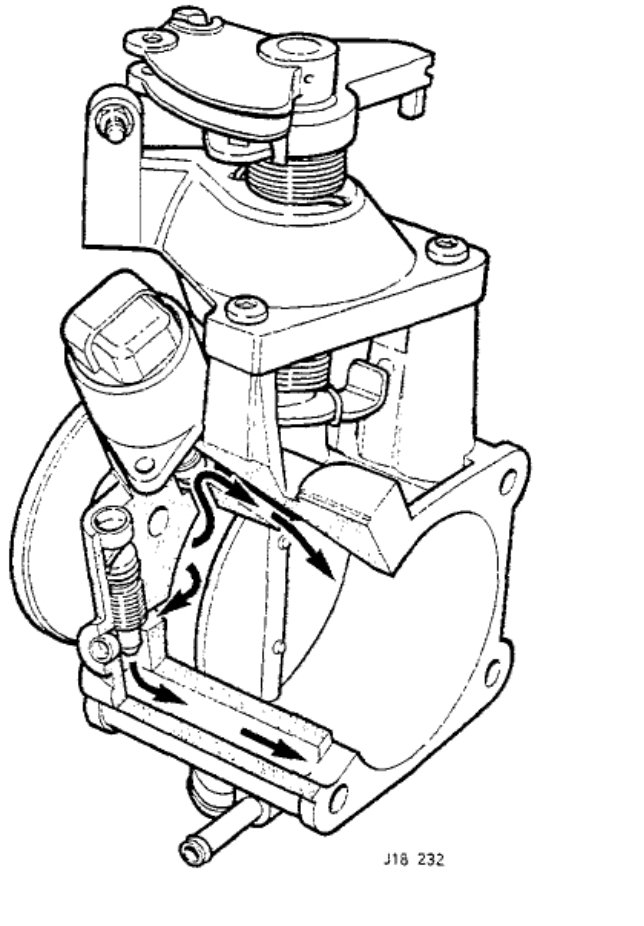

The car must be having a problem with the IAC control valve must be sticking open. Can you try disconnecting it to see if you have the same problem? The engine may stall at idle. Do you have a check engine light on?

I talked over your suggestion with the service adviser at the Jaguar dealership. It turns out that this car (perhaps all other models of cars that experience the same condition) has not had an IAC control valve since 1992. I asked them to check whatever took its place to see if that is the problem. I would suspect that this is what causes the sudden acceleration in all these later model cars, whether they be Jags, Toyotas, Jeeps, or whatever. I also asked them to recheck the motor mounts as you suggested in an earlier suggestion.

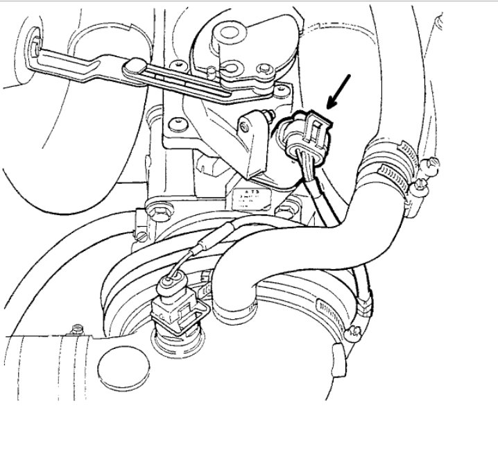

I don't know why He would say that becasue there is an IAC valve in your car. Here is its location (below). Also I noticed a cruise control servo connected to the throttle linkage. I would temporarily disconnect that as well
Please let us know what you find. I'm interested to see what it is.

Just as a quick update, Ken, I went over to the dealership and spoke with my "regular" service adviser. We took a look at the car, and you are absolutely right . . . it does have an IAC valve. So now their mechanic has to check it to see if that is the problem and if that resolves it. Thank you, and I'll write once I hear anything.
