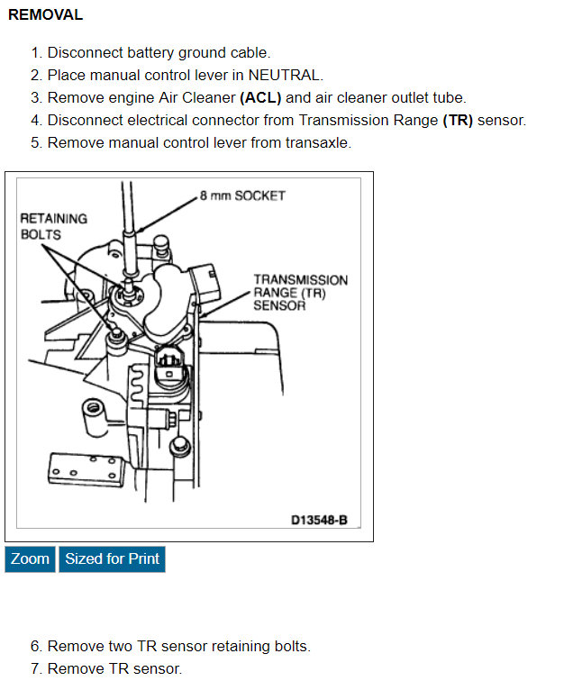

No codes shown on my code reader. Though, sometimes when it rains I will get a transmission range sensor too high code, or something like that.
Other than that, seems like Ia m just due for a service? I know these Ford AX4N transmissions are not good and act weird, so I am just worried.
Tuesday, April 13th, 2021 AT 6:46 PM
KEN L
  • MASTER CERTIFIED MECHANIC
  • 47,643 POSTS
Yes, that will do it. The transmission range sensor tells the transmission what gear it is in so if it fails it will go out of gear. Here is the location so you can change it out.

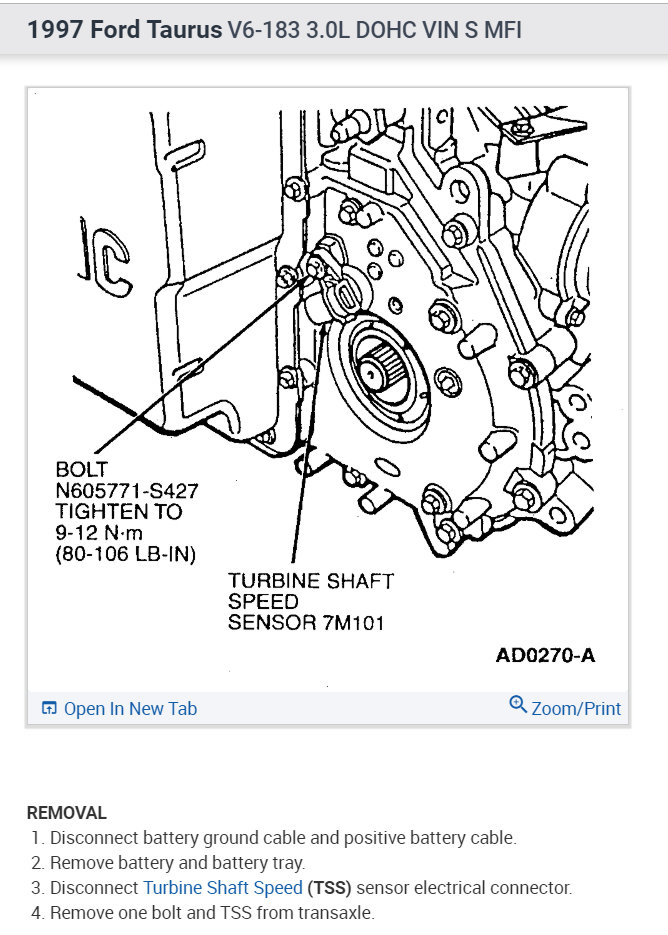

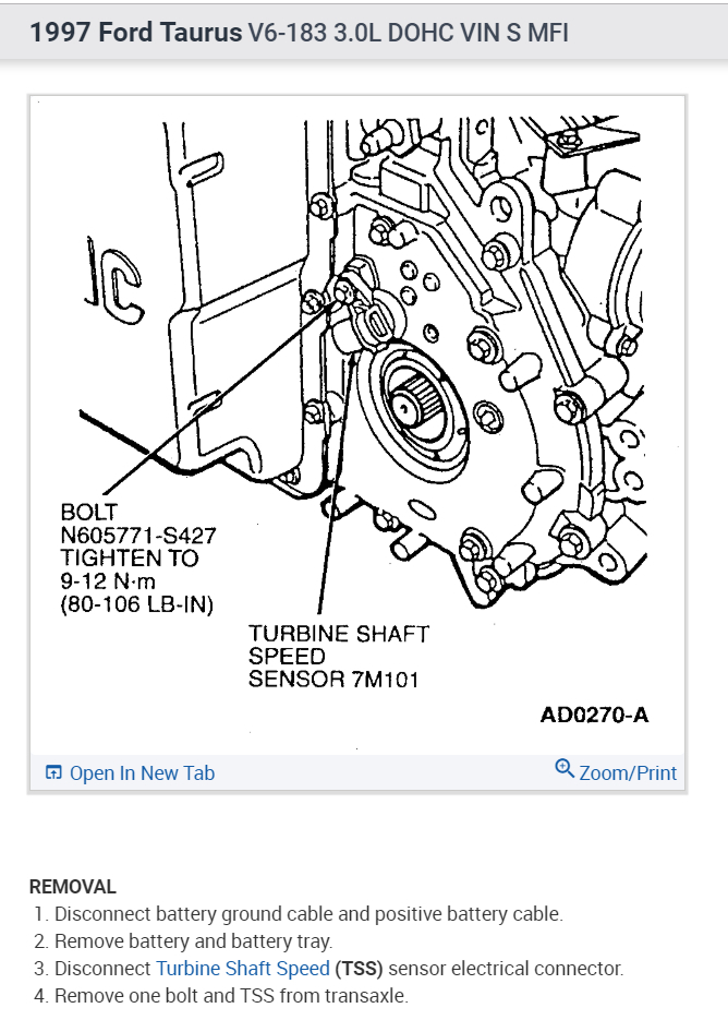

Reviving this thread because I changed the transmission range sensor on this car maybe 6 months ago after getting a code for high voltage. Engine light stays off and has been shifting okay, but last night the car would not get out of 1st gear. I turned O/D off and then back on and it has been fine since. Could be related to the sensor?
KEN L
  • 47,643 POSTS
Not really. It sounds more like the turbine shaft speed sensor is not working correctly. Here is a diagrams of the location so you can change it out. Check out the diagrams (below). Please let us know what happens.
