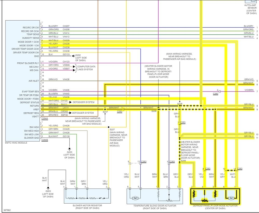

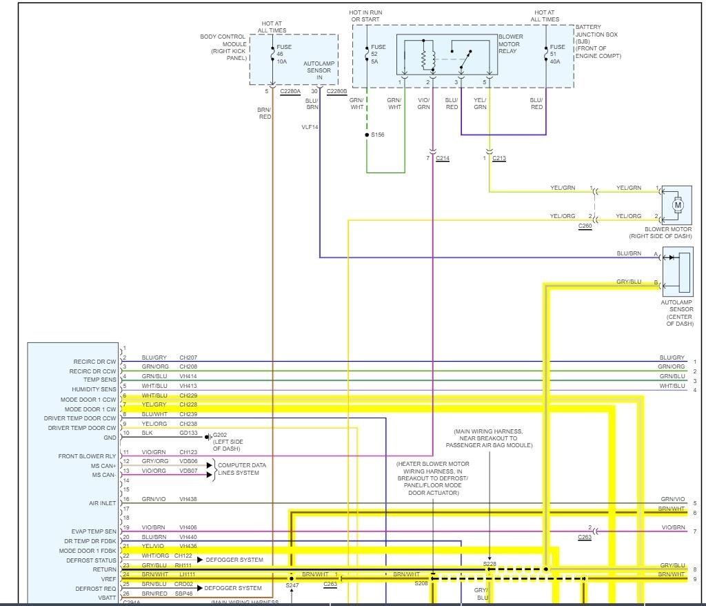

When I change the selector from dash vents to defrost it still blows out the dash. XLT package that doesn't have dual zone heat/cool.

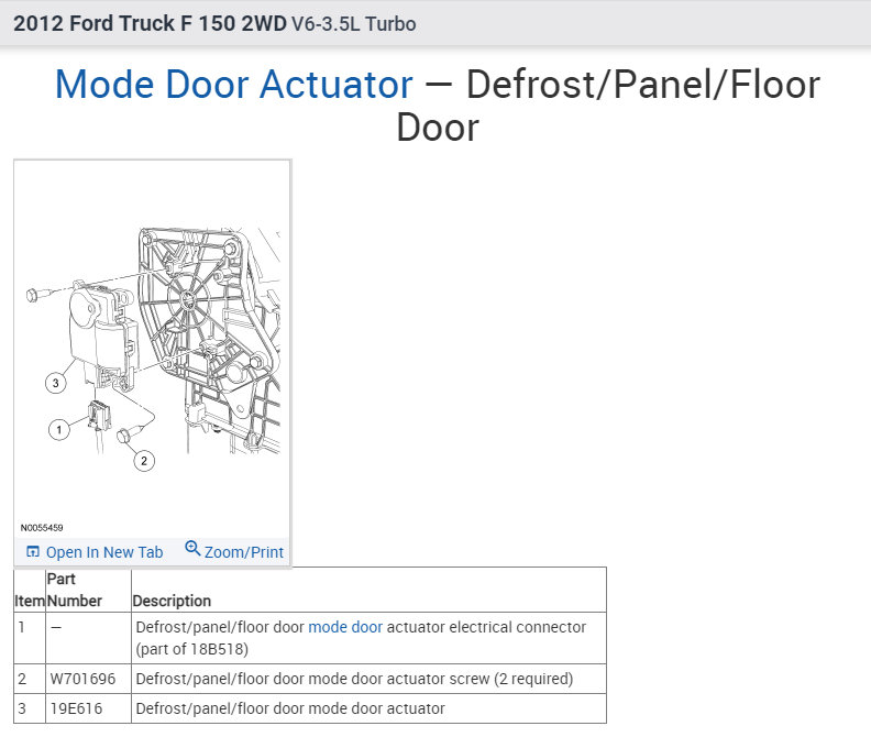

It sounds like you might have a faulty mode door actuator. The mode actuator is what changes the air flow from vent to defrost to floor.
It is likely stuck in the "on" position.
The mode door actuator is located under the dash on the driver the side footwell. Up towards the center console.

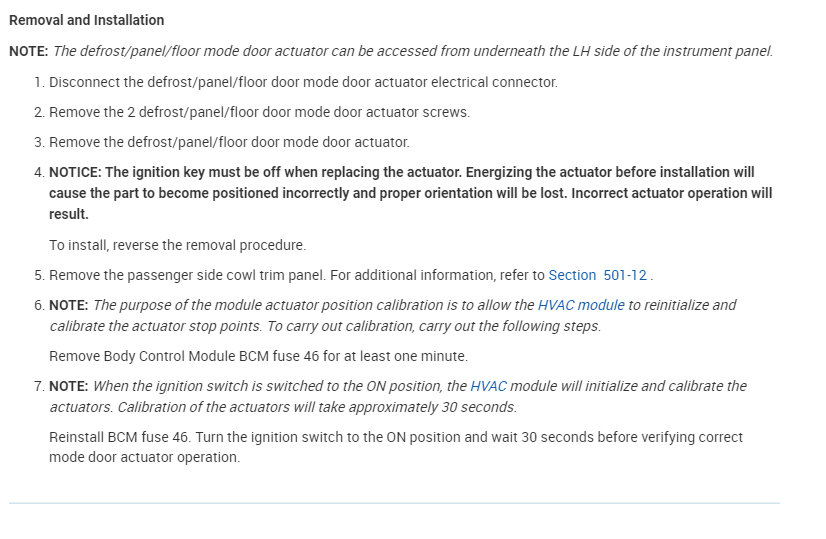

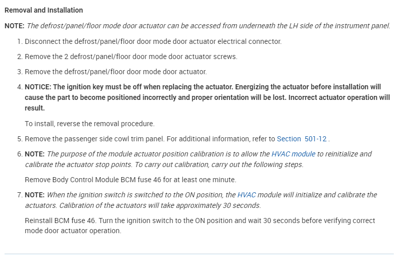

Install a new actuator and it still does it.

The new actuator needs to be initialized properly; without it, it will not work correctly.
The ignition key must be off when replacing the actuator. Energizing the actuator before installation will cause the part to become positioned incorrectly and proper orientation will be lost. Incorrect actuator operation will result.

RMOMMER
I followed all steps for initialization so it must be the actual door. I suppose it's behind the dash.

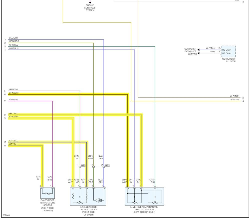

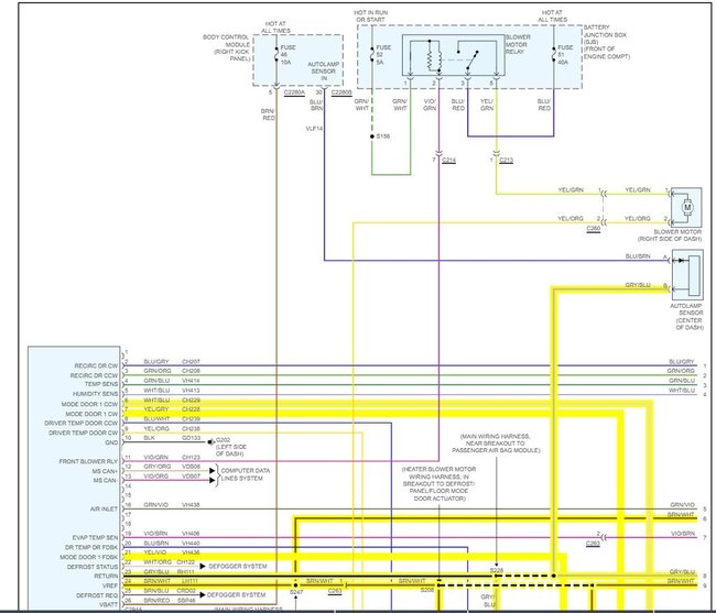

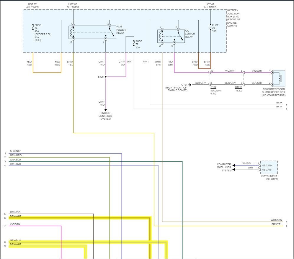

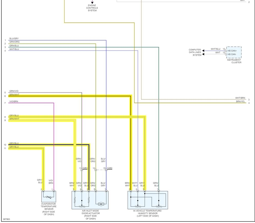

You will need to do some pinpoint checks to be sure the voltage is getting to the motor.
I attached the diagram for you to view. Check the connector for power with the key on.
