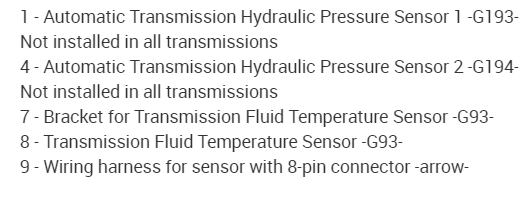

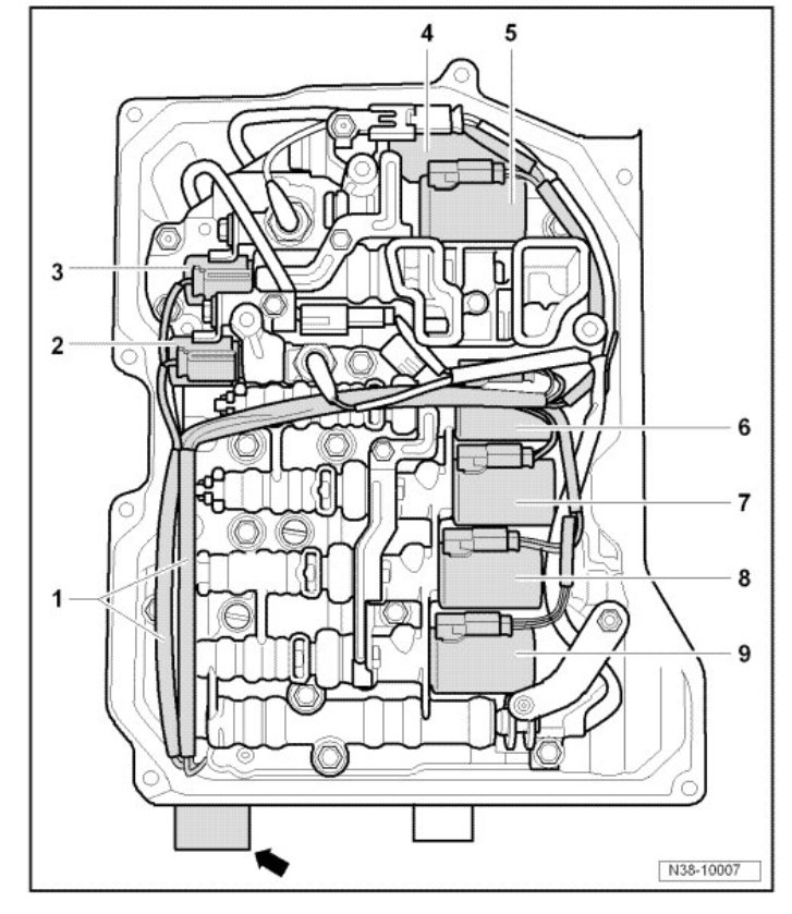

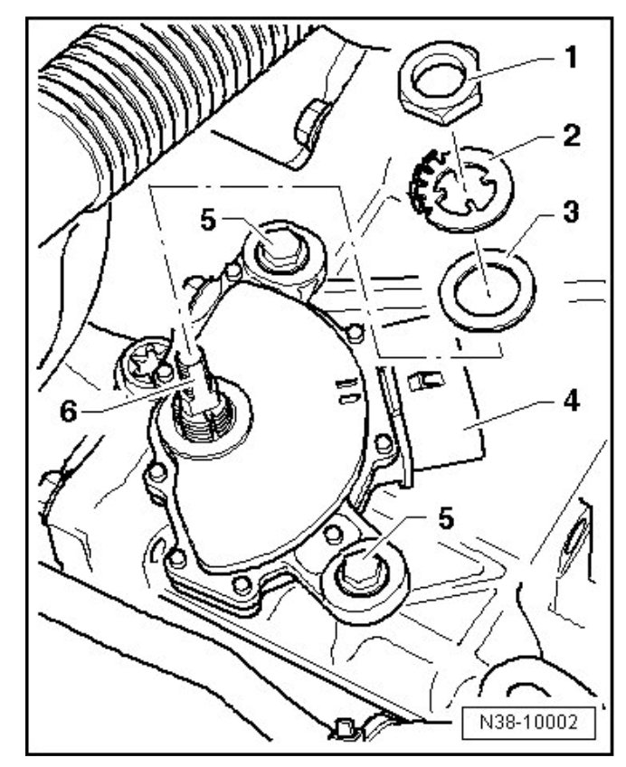

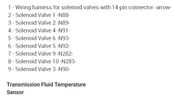

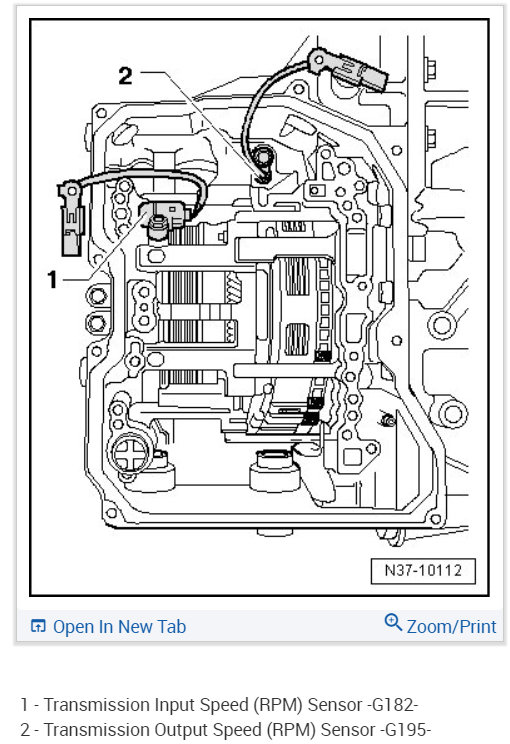

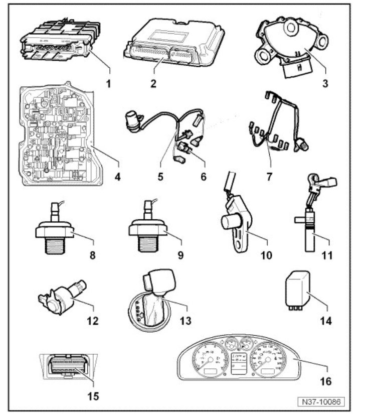

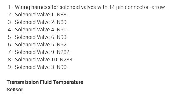

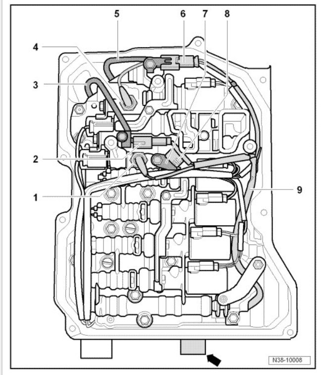

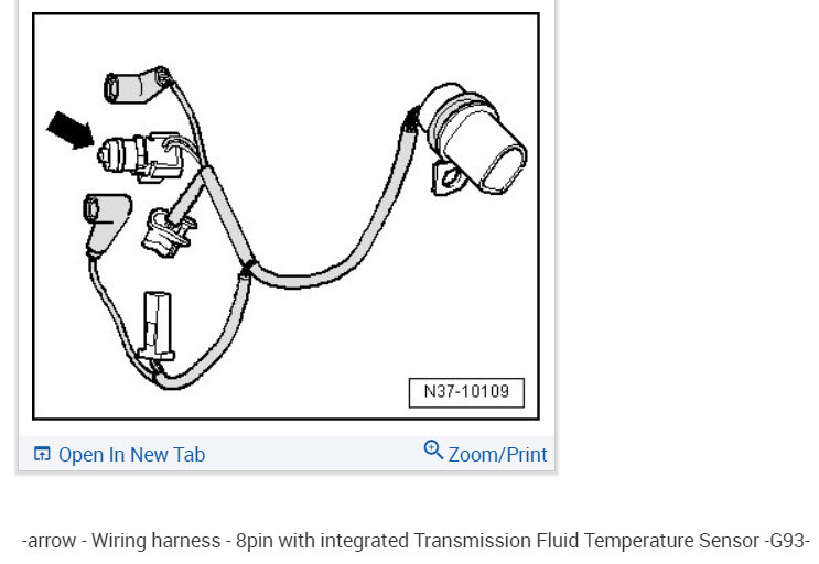

We should run the codes to see what comes up it. Sounds like you have a turbine shaft speed sensor that has gone out. Here is a guide to help us:

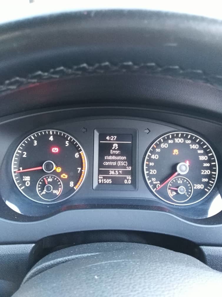

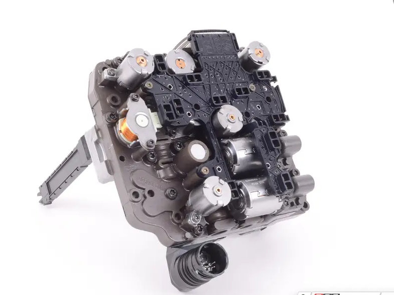

The problem was resolved by replacing the DSG Mechatronic Unit. Apparently it had cracked/worn out thereby leaking gearbox/transmission oil/fluid.
I have now encountered a new problem, "Error Stabilisation Control", this has resulted in gear lever not shifting from Park (P). Now the car displays the steering wheel error and engine light (see attached).

There is what the DSG Mechatronic Unit looks like in the image (below). Glad you got it fixed. Please post your new question here, you must be logged in.
