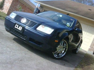

https://www.2carpros.com/forum/automotive_pictures/486954_untitled_1.jpg
(isn't she a beauty..)

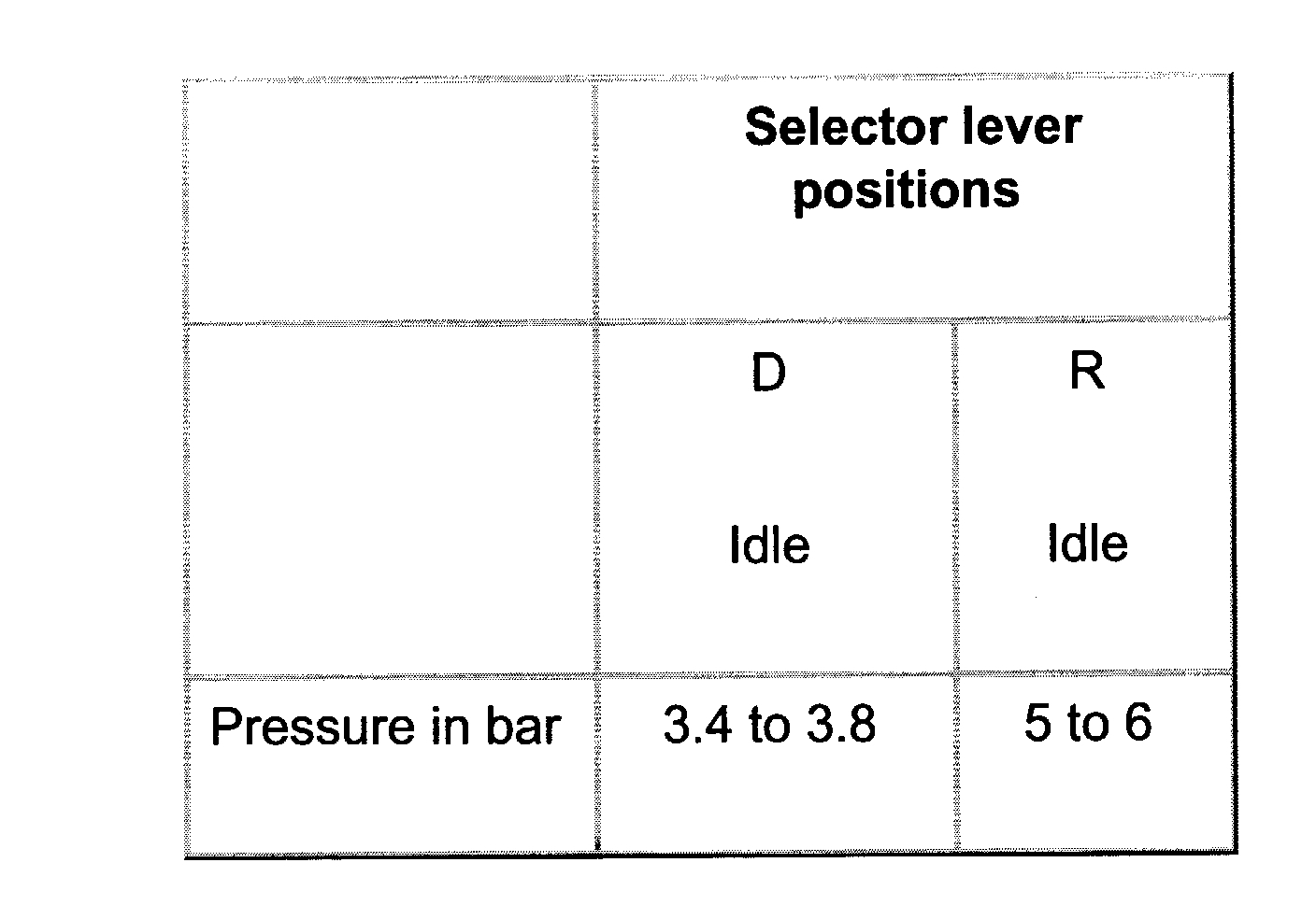

  • 109,867 POSTS
I suspect that when the vehicle is warmed up and driven that far, there may be a loss of line pressure in the transmission, That can be caused by a couple things. First, make sure the transmission fluid is clean and full. If it is and there are no diagnostic trouble codes specific to the transmission issue, I would recommend checking transmission line pressure. You will need a pressure gauge and VAG software to make checks. Here are the directions of how it is done. The attached pictures will correlate with the directions.
_______________________________________________
2003 Volkswagen Jetta Sedan (9M2) L4-2.0L (AVH)
Main Pressure, Checking
Vehicle Transmission and Drivetrain Automatic Transmission/Transaxle Testing and Inspection Component Tests and General Diagnostics 4 Speed Automatic 01M Main Pressure, Checking
MAIN PRESSURE, CHECKING
Main pressure, checking
Conditions for performing check

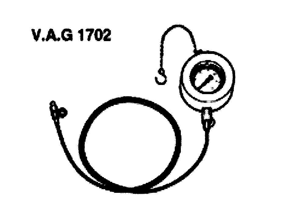

Special tools and equipment
pic 1
- V.A.G 1702 Pressure tester
pic 2

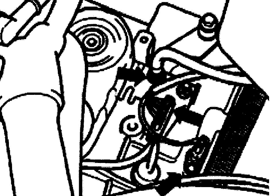

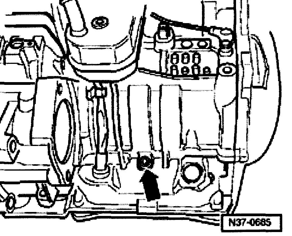

- Remove bolt -arrow- for main pressure port. Always replace bolt.
- Connect pressure tester V.A.G 1702 and tighten thumb screw.

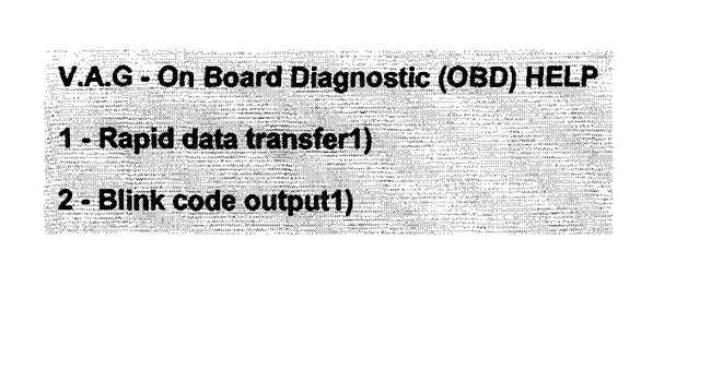

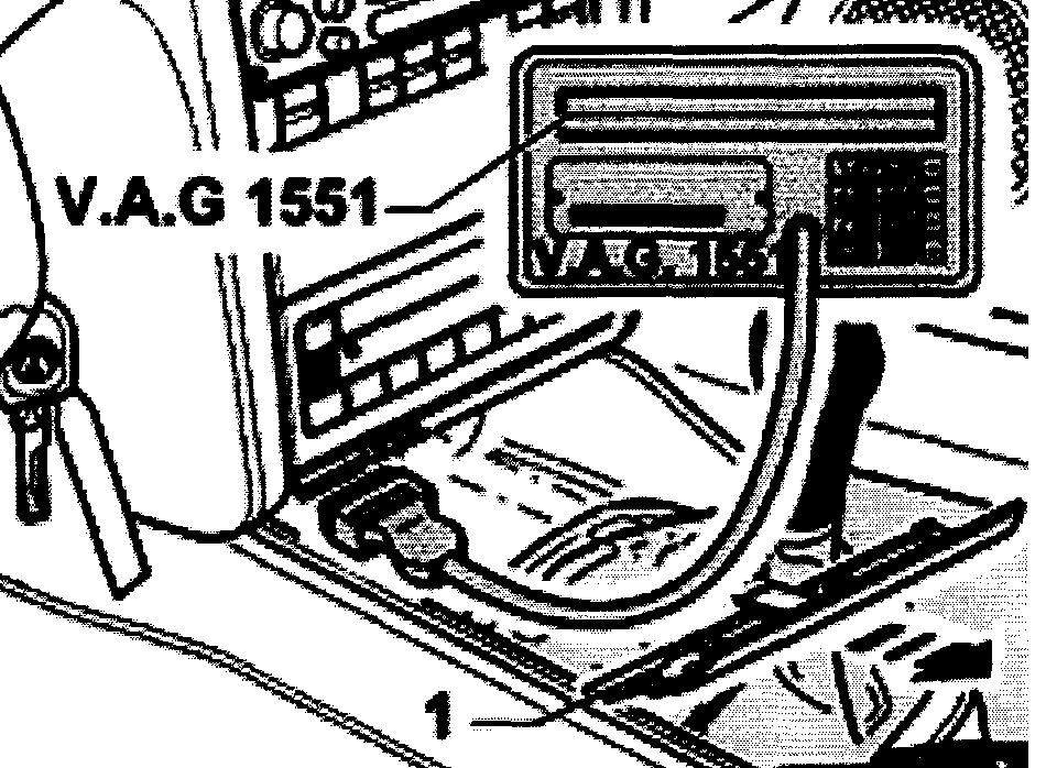

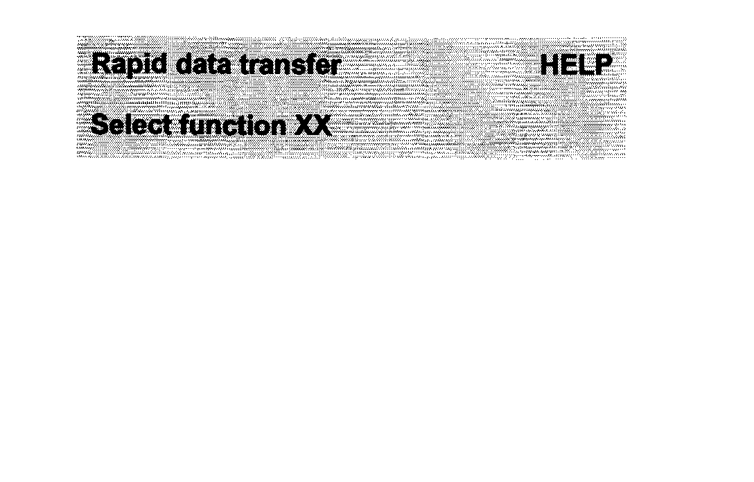

If V.A.G1551 is used:
pic 3

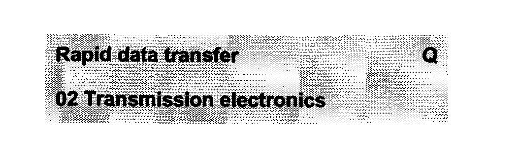

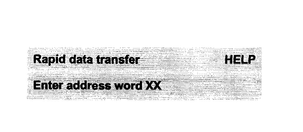

- Remove Data Link Connector (DLC) cover -1-.
- With ignition switched off, connect V.A.G 1551 Scan Tool with diagnosis cable V.A.G 1551/3A.

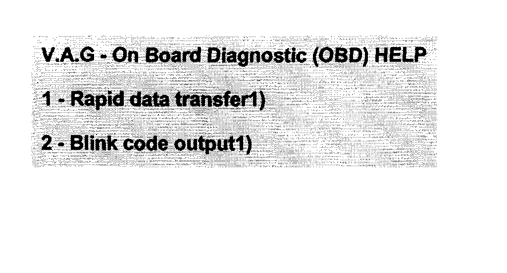

Pic 4
Indicated on display
1) appears alternately
- Start engine.

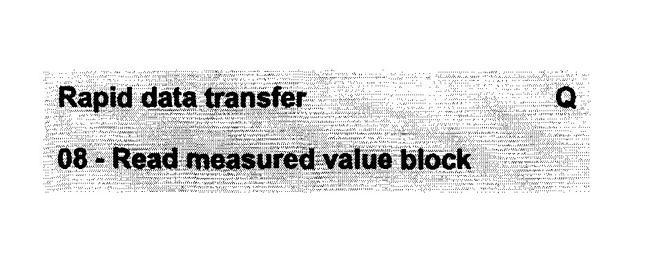

- Press key 1 for "Rapid data transfer" mode.
Pic 5
- Press keys O and 2 to select address word "Transmission electronics".
Pic 6
- Confirm entry with key Q.
Pic 7

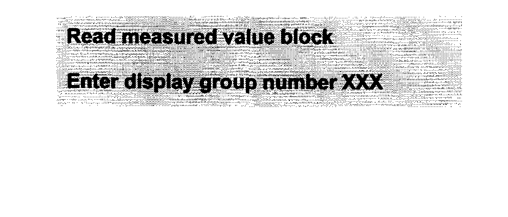

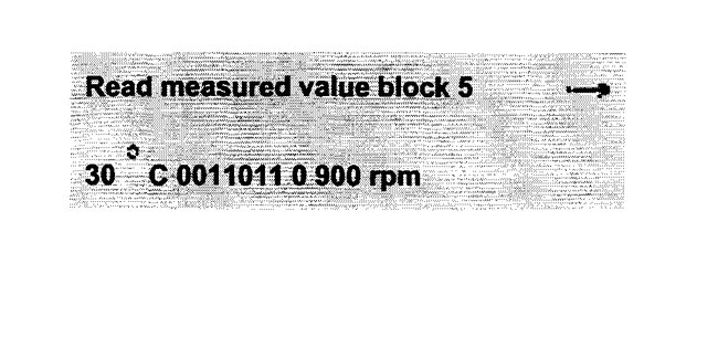

- Press keys 0 and 8 to select function "Read measured value block".
Pic 8

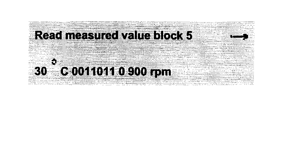

Pic 9
- Press keys 0, 0, and 5 to select "Display group number 005".
Pic 10
The first display zone shows the ATF temperature.
- Allow ATF temperature to rise to 60°C.

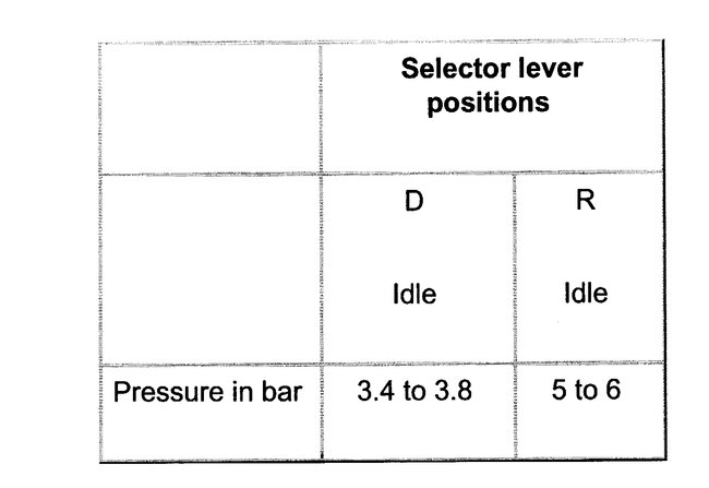

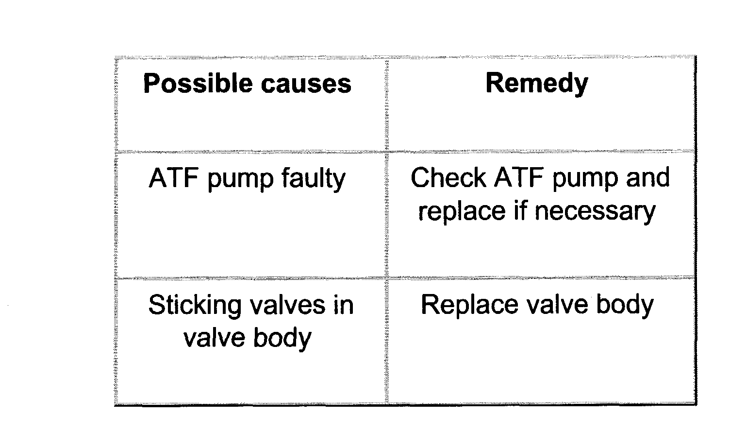

Main pressure specifications at idle
pic 11
pic 12

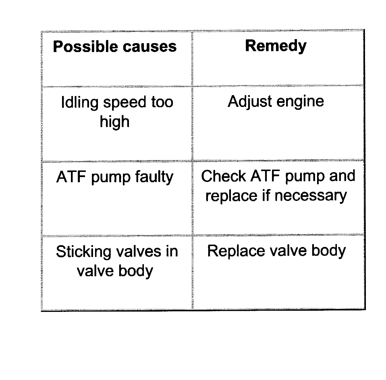

If there are deviations from the prescribed values, the following could be the cause:
- Switch engine off.
Pic 13
Solenoid valve connector
- Press fuse together and pull off connector.
- Start engine.

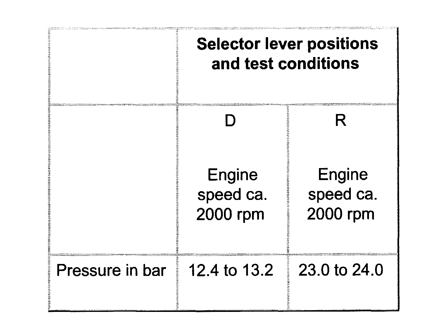

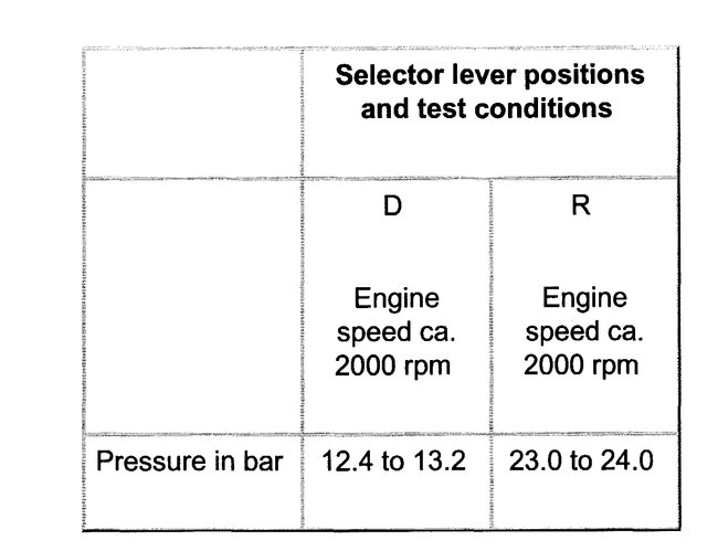

Main pressure specifications at 2000 rpm
pic 14
If possible, the main pressure test should be performed on a rolling road.
Pic 15
If there are deviations from the prescribed values:
- After test is complete, disconnect pressure tester V.A.G 1702.
- Install new bolt for main pressure port and tighten to 15 Nm.
- Fit solenoid valve connector.
- Once connector has been fitted, check and erase DTC memory.
- If necessary, install sound insulation.
