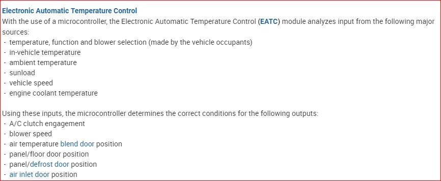

Okay. Do you have auto HVAC system? I am going to assume you do because that is the only thing I can seem to connect these things with.
See attached for the detail on this system. In short, the EATC module uses various input sensors to control both the clutch engagement and blower speed.
Let me know if you do and we can go from there because if you have manual system, then I am going to have to dig pretty deep because I don't see how both are related as it seems they are.

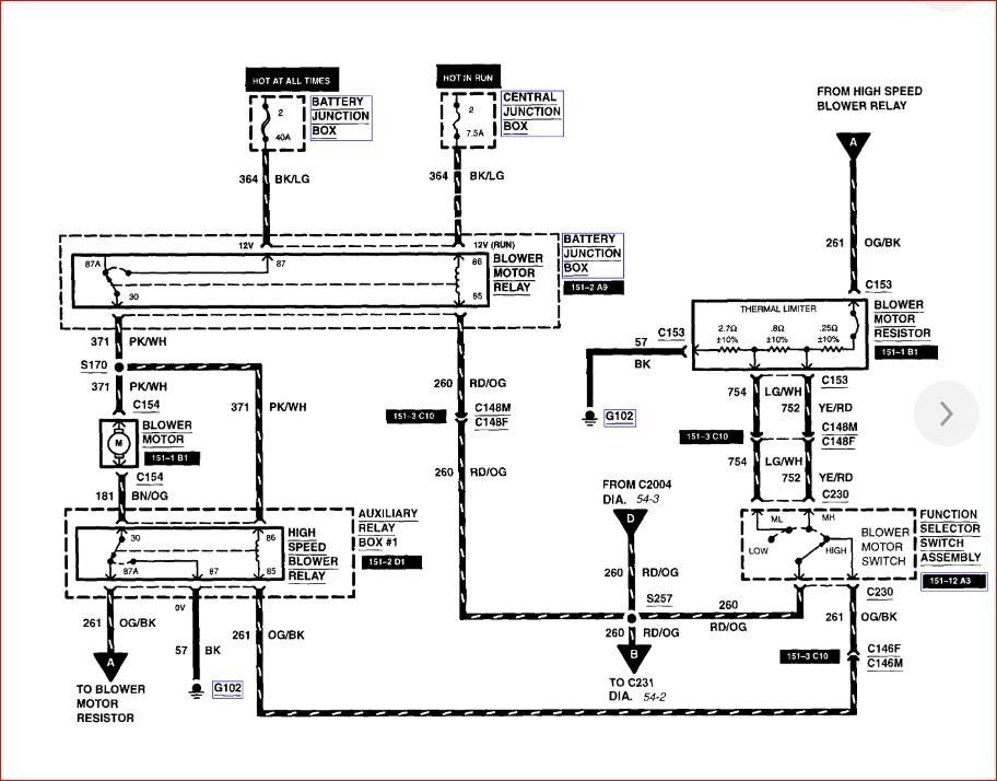

There is absolutely no correlation between the blower motor and the AC compressor on a manual AC system. When you turn the blower motor speed switch from low to high, it simply sends voltage through a resistor and that regulates the fan speed.
The AC compressor is controlled by the PCM which looks at various input sensors. However, the PCM does not control your blower motor. Again, that is a switch input directly to the blower motor.

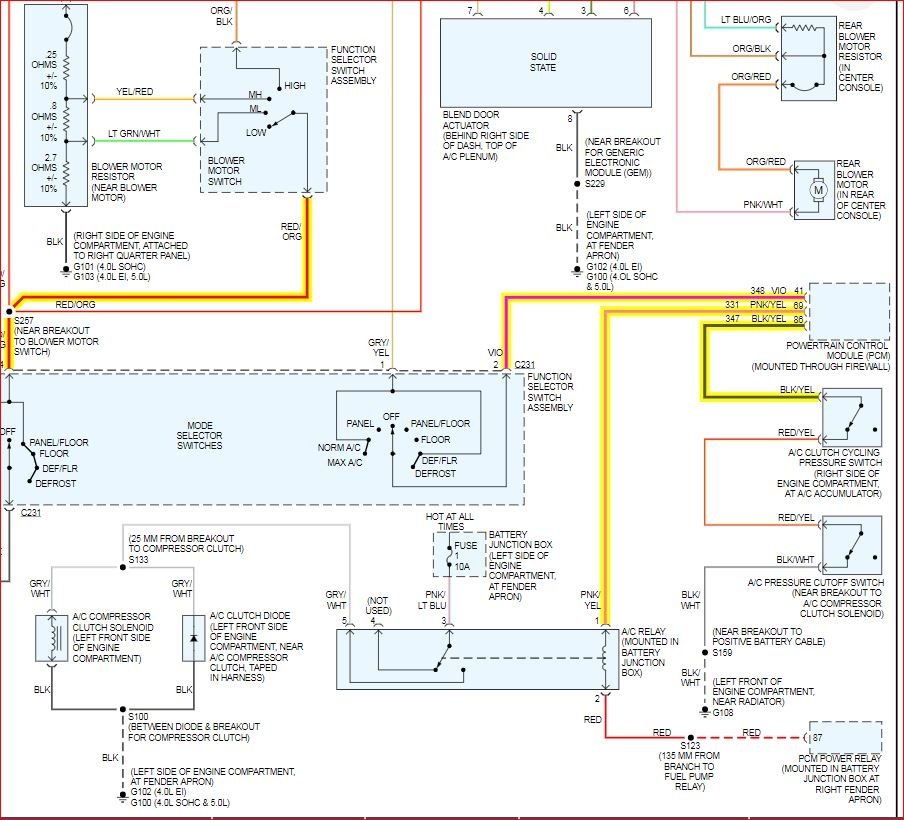

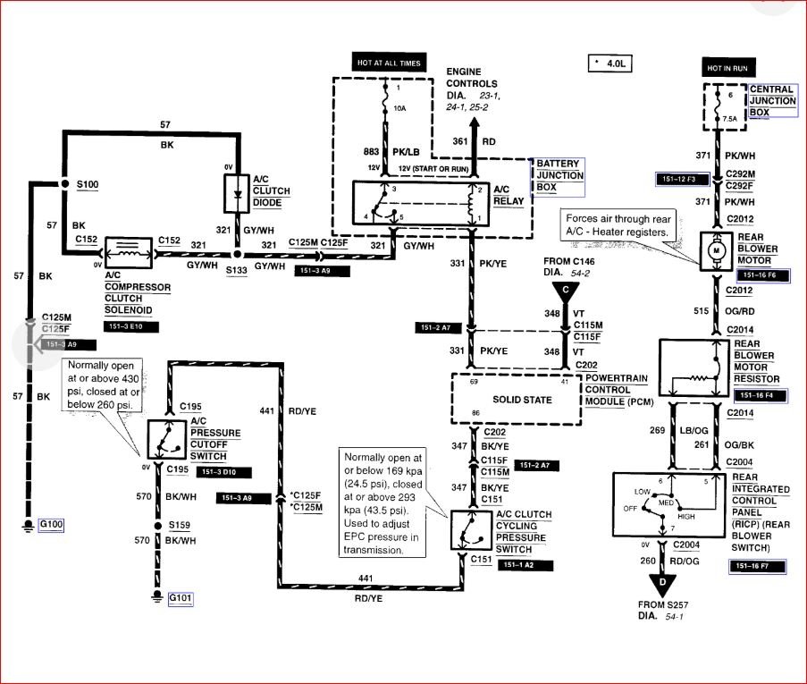

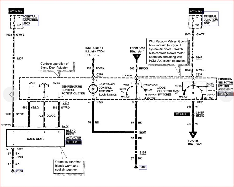

I may have been mistaken. It looks like the blower info is an input to the PCM but it look like the PCM is a pass through. The blower switch uses the Mode Selector switch as a pass through to get its info to the PCM. The PCM then controls the AC compressor.
This is a stretch but if the PCM has an issue or one of these input sensors to the PCM has failed, it is possible to have the blower fan and compressor inoperable. The rear blower is completely separate which makes sense as to why that still worked.
It would be a new one on me but it is possible that the PCM is causing this issue. I just don't see how a sensor issue would cause this.
