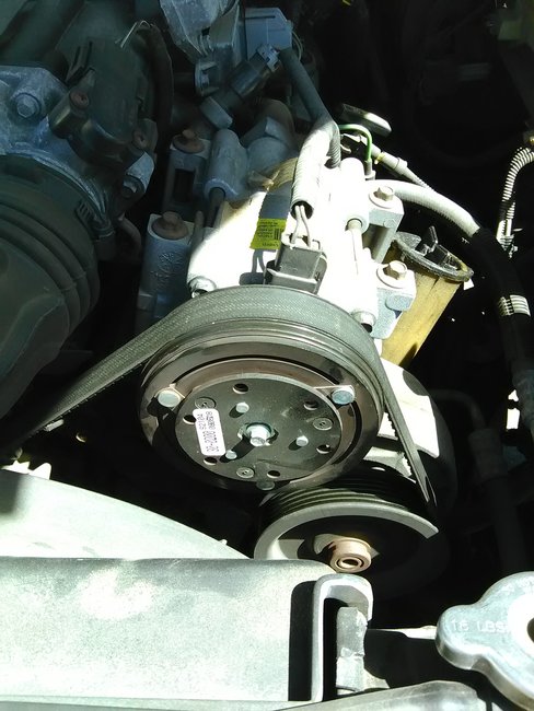

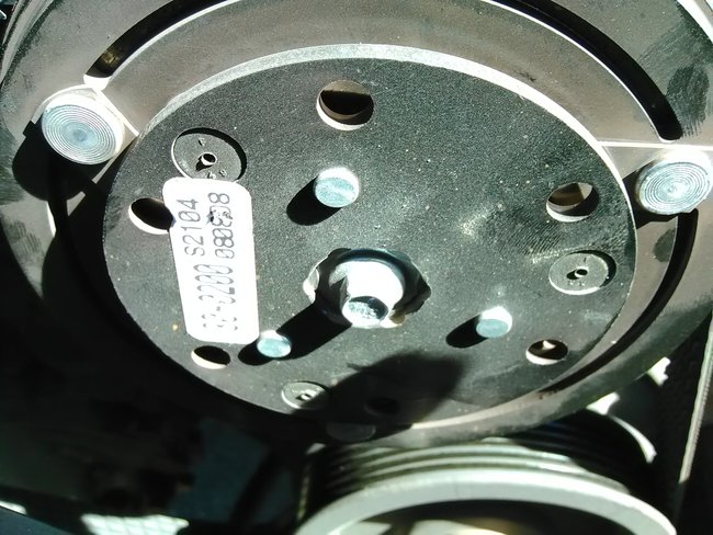

I have seen AC clutches go bad and kill the engine when they engage. But the SC compressor is fine. Can you take s picture of the AC clutch and post it.

The center spins free.
