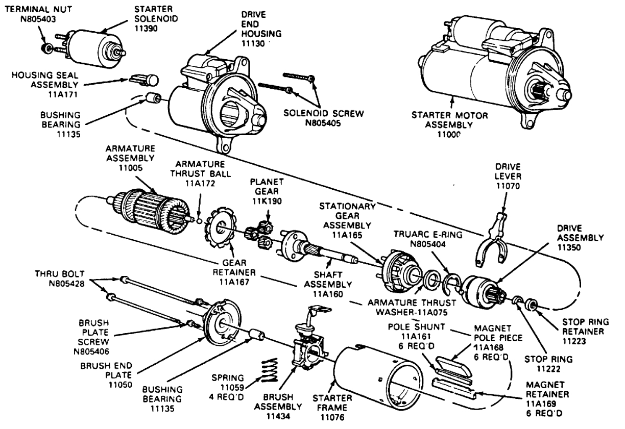

Can I use a starter from a 1986 4L in a 1995 3L?
Aug 25, 2024 at 6:49 PM
  • 55,447 POSTS

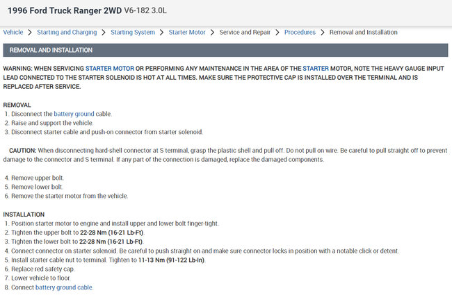

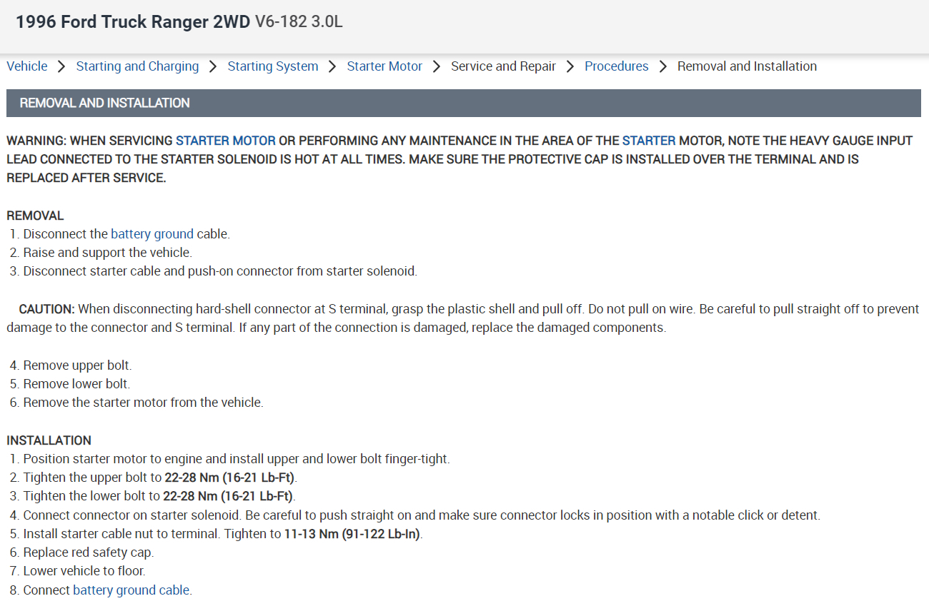

The starter from a 1986 Ford with a 4.0L engine may not be directly compatible with a 1995 Ford Ranger with a 3.0L engine but if they look the same then yes, I would install it. Here is how the job is done:
This guide can help walk you through the repairs with instructions below for your car.
Check out the images (below). Let us know if you need anything else.
