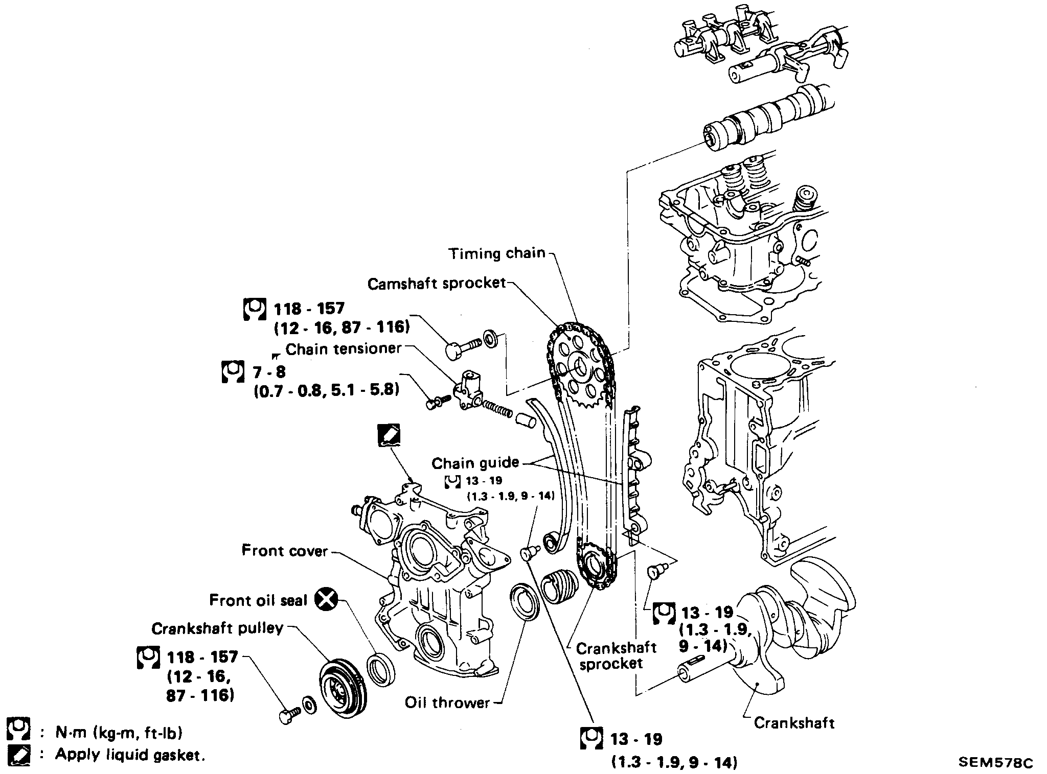

I was in the process of doing timing chain job and in the process somebody while I was not home come by and roll the cam or something because followed procedures y'all described and I cannot get it to crank up. I had to replace fuse links and replace the rotor button that somebody bus to do the end lip off metal tab. so I know somebody's messed with it when I wasn't around. can I get the valve rotation sequence to timing the camshaft to the crank in what position should the exhaust valve be on top dead center compression and which mark is top dead center and is there a degrees of before top dead center or after top dead center? one place I read it in one place.

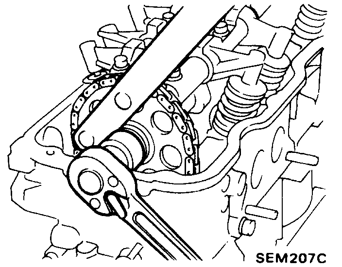

Here are the directions for removal and replacement of the timing chain. The timing marks and procedures are included in the directions and attached pictures.
__________________________________________________________________
1991 Nissan-Datsun Truck D21 Hardbody 4WD L4-2389cc 2.4L SOHC MFI (KA24E)
Removal and Installation
Vehicle Engine, Cooling and Exhaust Engine Timing Components Timing Chain Service and Repair Procedures Removal and Installation
REMOVAL AND INSTALLATION
*** THIS ARTICLE INCLUDES UPDATES MADE BY TSB 95027, DATED MARCH 22, 1995 ***
CAUTION: After removing timing chain, do not turn crankshaft and camshaft separately, or valves will strike piston heads.

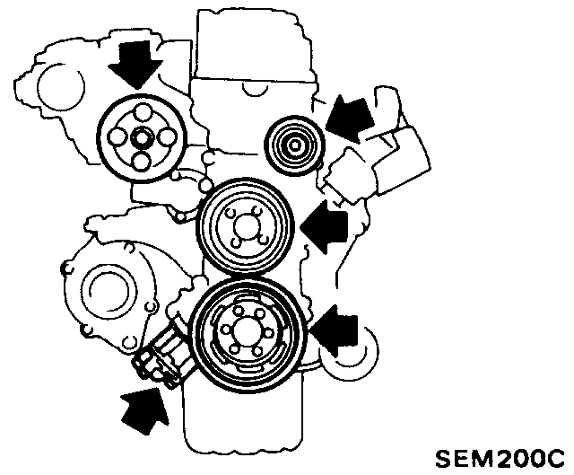

4. Remove the following belts.
^ Power steering drive belt.
^ Compressor drive belt.
^ Alternator drive belt.

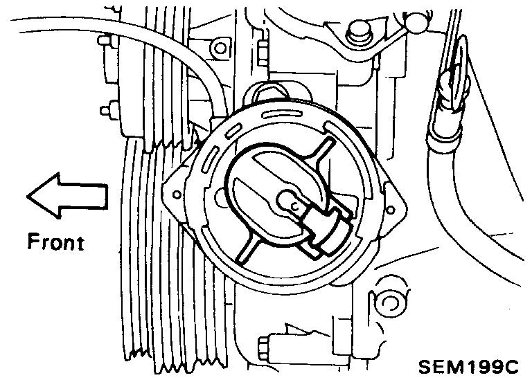

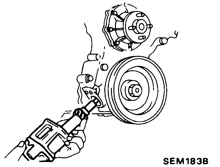

Setting TDC- Distributor
Pic 2
6. Set No.1 piston at T.D.C. on its compression stroke.

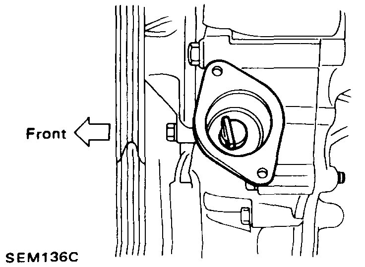

7. Remove the following parts.
External Parts Removal
Pic 3
^ Power steering pump, idler pulley and power steering pump brackets.
^ Compressor idler pulley.

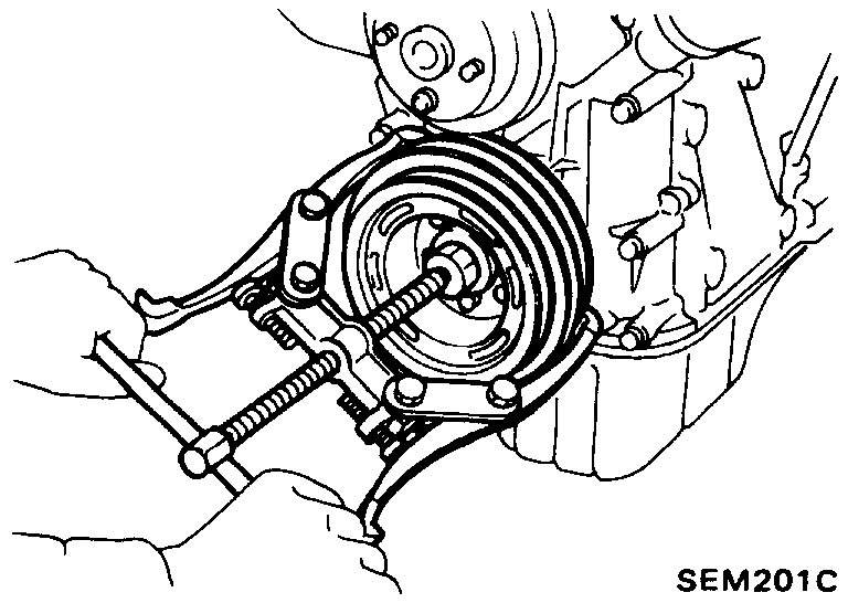

Removing Crankshaft Pulley
Pic 4
^ Crankshaft pulley.

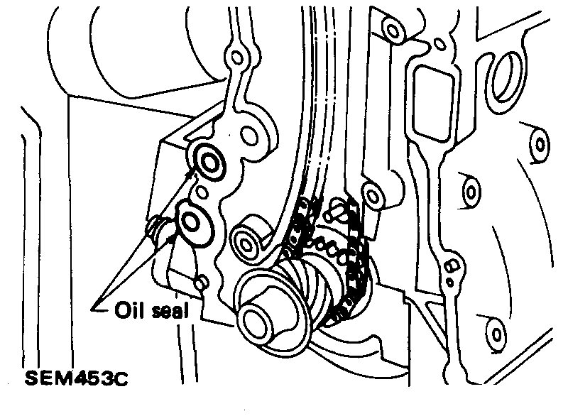

Removing Oil Pump
Pic 5
^ Oil pump with pump drive spindle.

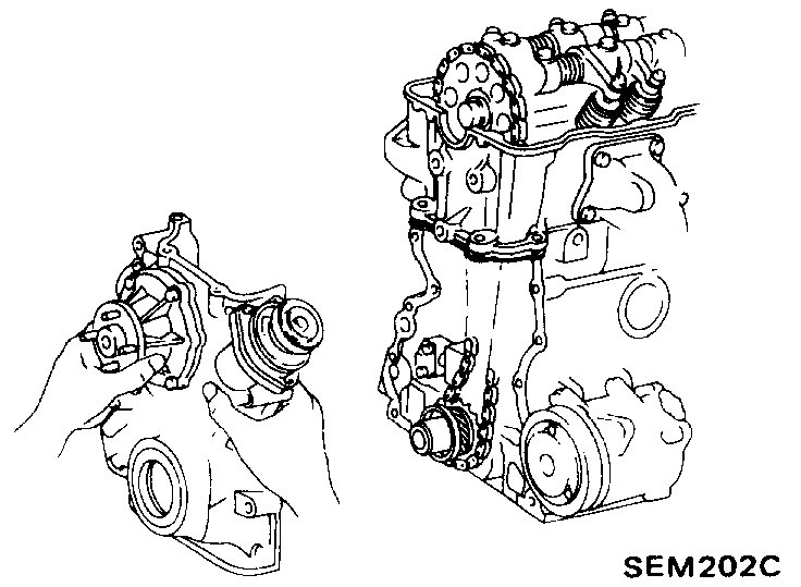

Removing Front Cover
Pic 6
9. Remove front cover.

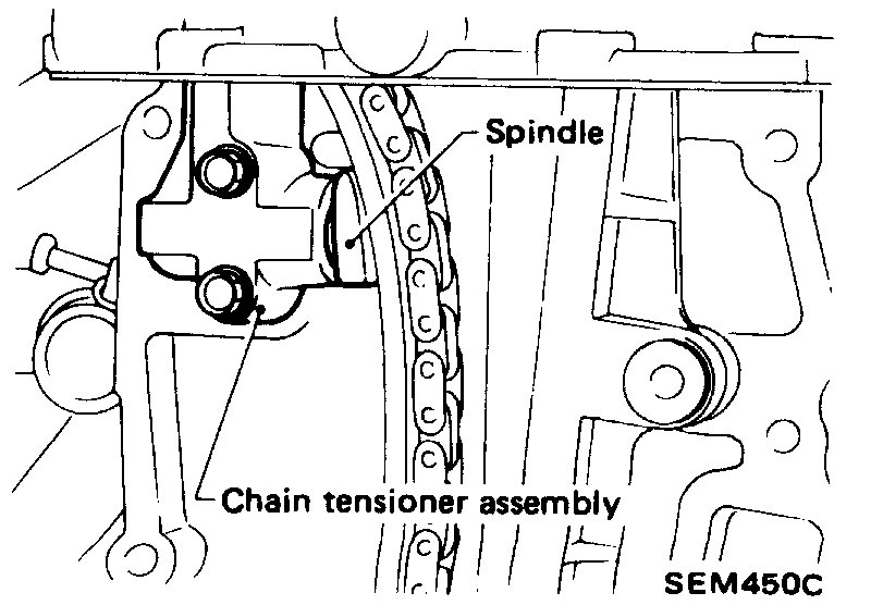

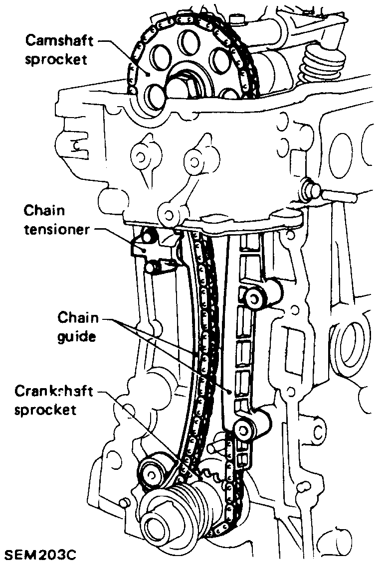

10. Remove the following parts.
^ Chain tensioner.
^ Chain guides.
^ Timing chain and sprocket.

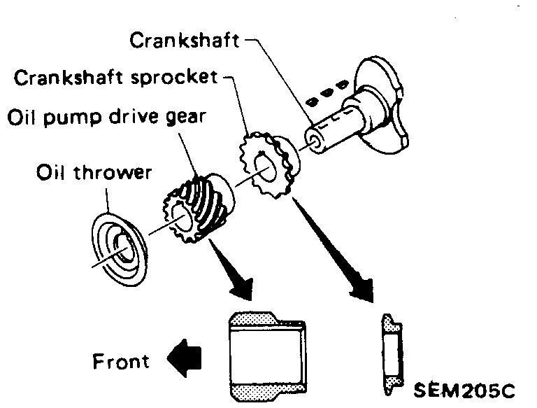

^ Oil thrower, oil pump drive gear and crankshaft sprocket.

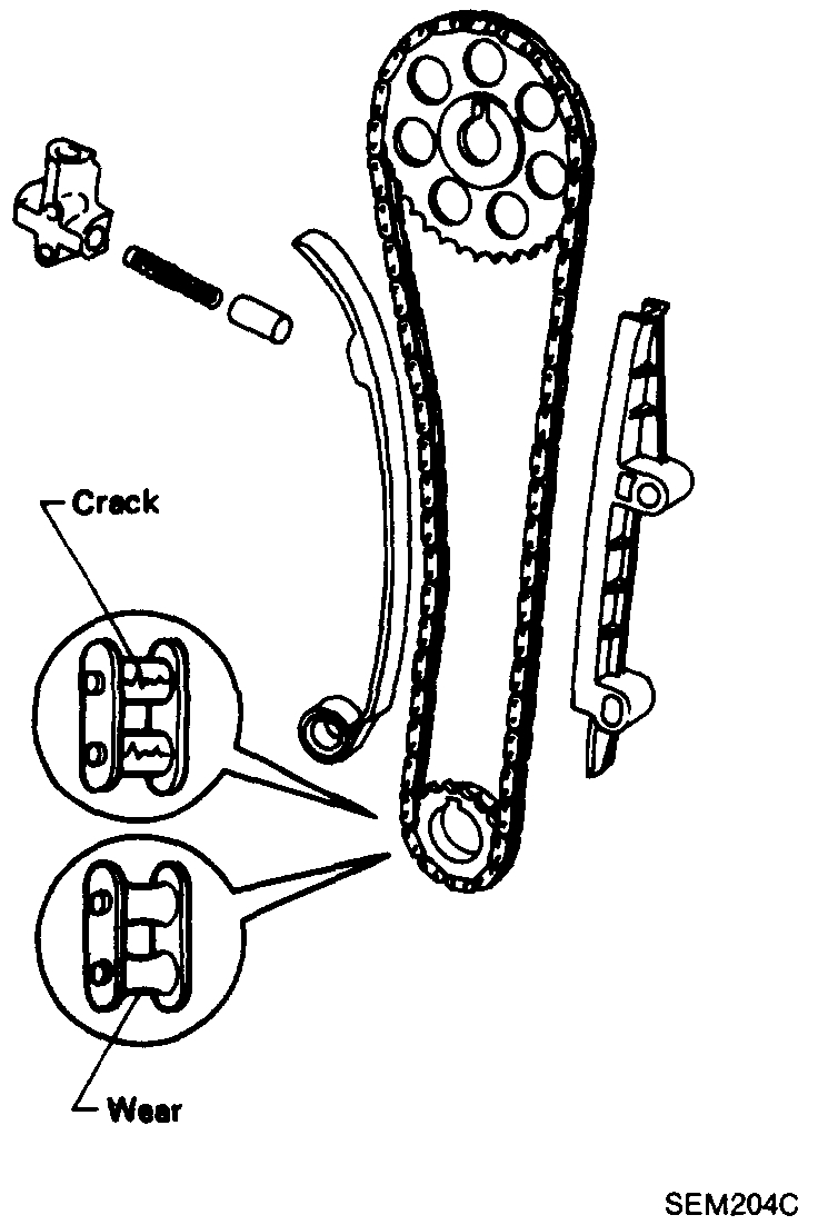

INSPECTION
Timing Chain Component Inspection
pic 8
1. Check for cracks and excessive wear at roller links. Replace If necessary.

After removing timing chain, do not rotate crankshaft and camshaft separately because valves will hit piston head.
Front Of Crankshaft
pic 9
1. Install crankshaft sprocket, oil pump drive gear and oil thrower.
^ Make sure that mating marks of crankshaft sprocket face engine front.

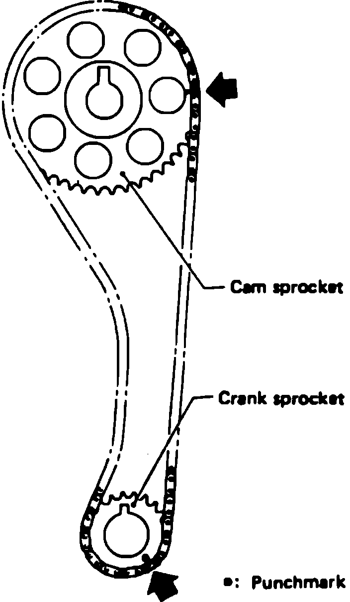

2. Install camshaft sprocket.
3. Confirm that No.1 piston is set at T.D.C. on its compression stroke.
4. Install timing chain.
Fig. 3 Timing Mark Alignment.
pic 10
^ Set timing chain by aligning its mating marks with those of crankshaft sprocket and camshaft sprocket.

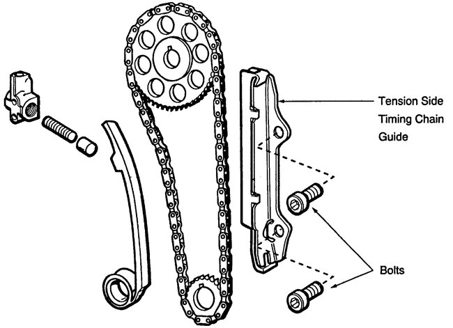

Timing Chain Tensioner
pic 12
6. Install chain guide and chain tensioner.

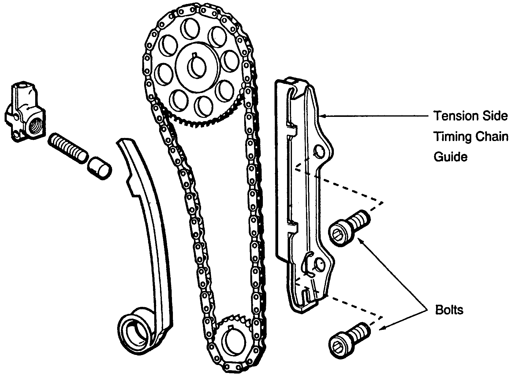

CAUTION: SERVICE INFORMATION
pic 13
If servicing the timing chain or replacing a long block, check to see if it has the steel-backed tension side guide. If not, please replace it with the countermeasure guide, including the two bolts listed. Due to the changes made to the guide, new style bolts are required. Refer to TSB 95027.

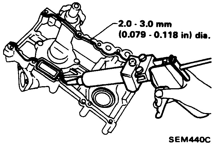

Applying Sealant To Front Cover
pic 14
7. Apply liquid gasket to front cover.
8. Apply lithium grease to sealing lip of crankshaft oil seal.
9. Install front cover.

Front Cover Oil Seals
pic 15
^ Do not forget oil seal.

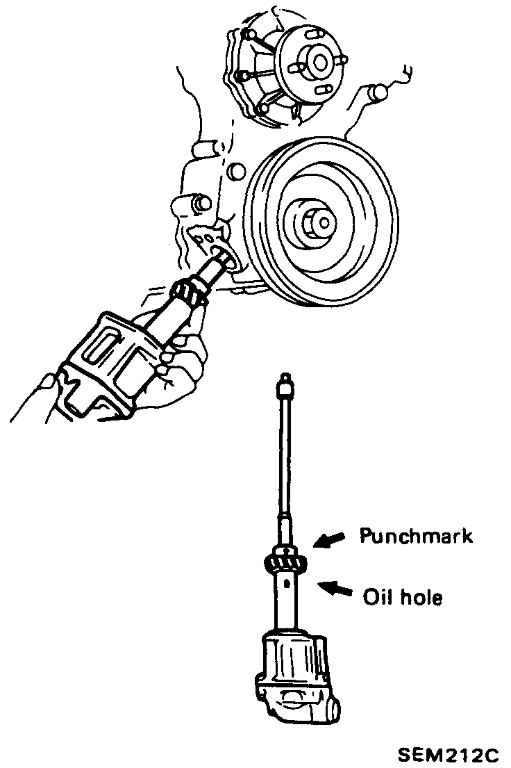

12. Install oil pump and distributor driving spindle with new gasket in front cover.
Installing Oil Pump
pic 16
a. Assemble oil pump and driving spindle, aligning punchmark on driving spindle with oil hole.
Distributor Driving Spindle
pic 17
b. Make sure that driving spindle is set as shown in image.
13. Install distributor.
pic 18
14. Make sure that No. 1 piston is set at T.D.C. and that distributor rotor is set at No.1 cylinder spark position.

Not really. I need to know which valve will move first. From TDC compression stroke. The bottom end doesn't know what stroke it's on it just strokes the valves control the compression so is the exhaust valve open or closed at that point and which one moves next intake valves on 3 or exhaust on 1 on which mark on harmonic balancer is 0 top dead center. and is there a degree offset of top dead center before or after?
Jul 27, 2020 at 1:41 PM
  • 110,240 POSTS
If you start at top dead center, cylinder 1 both valves should be totally closed. On cylinder 1, the intake should open first.
As far as TDC, there should be a mark on the edge of the harmonic balancer. When that aligns with 0 on the marker, it should be TDC.
Jul 28, 2020 at 11:24 AM
LOKIE TWEEKIE
Thank you. I finally got it to fire up that helped a lot.
