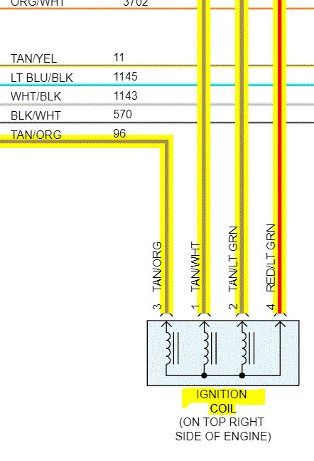

Wow, you've done a lot of work on this. Regardless, the coil on this vehicle should have power at all times when the key is on. You've confirmed that already. Power should be on the red wire with a light green tracer at the coil.

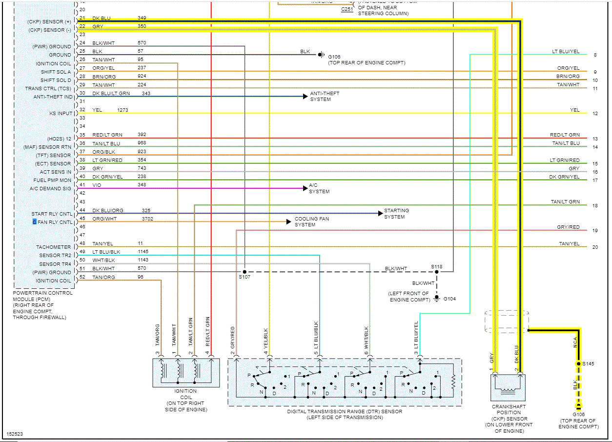

Here is how it works. Each coil within the pack fires two spark plugs at the same time. If you look at the pic below, the three wires (other than the power) should receive a ground signal when the PCM determines it should provide spark.
In this case, you need to check if there is a ground signal being provided. So, check for a signal at any of the three wires when the engine is cranking and let me know what you find.
Also, please confirm for me that the red/light green wire is the one with power.

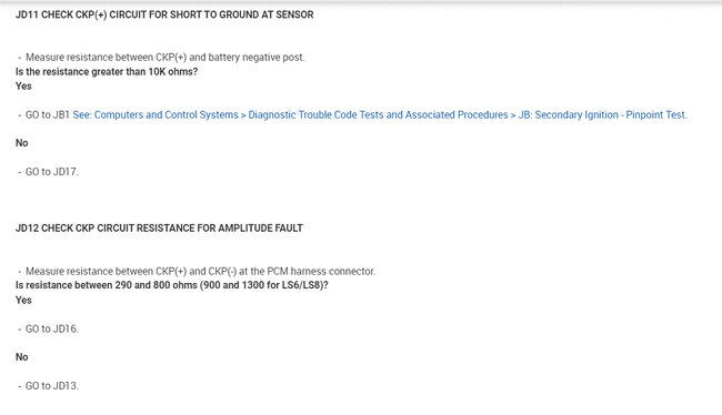

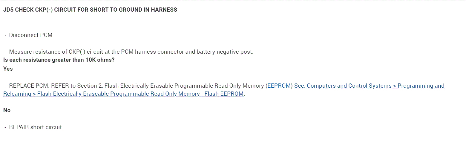

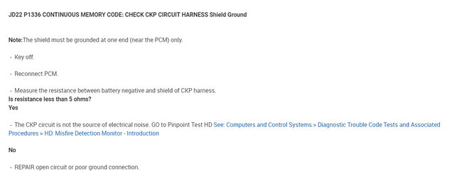

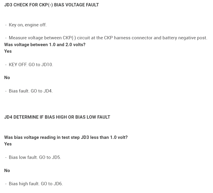

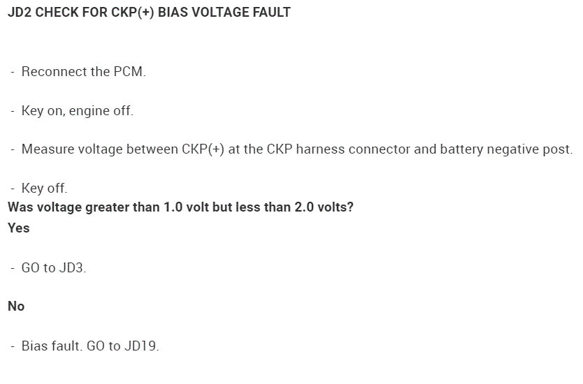

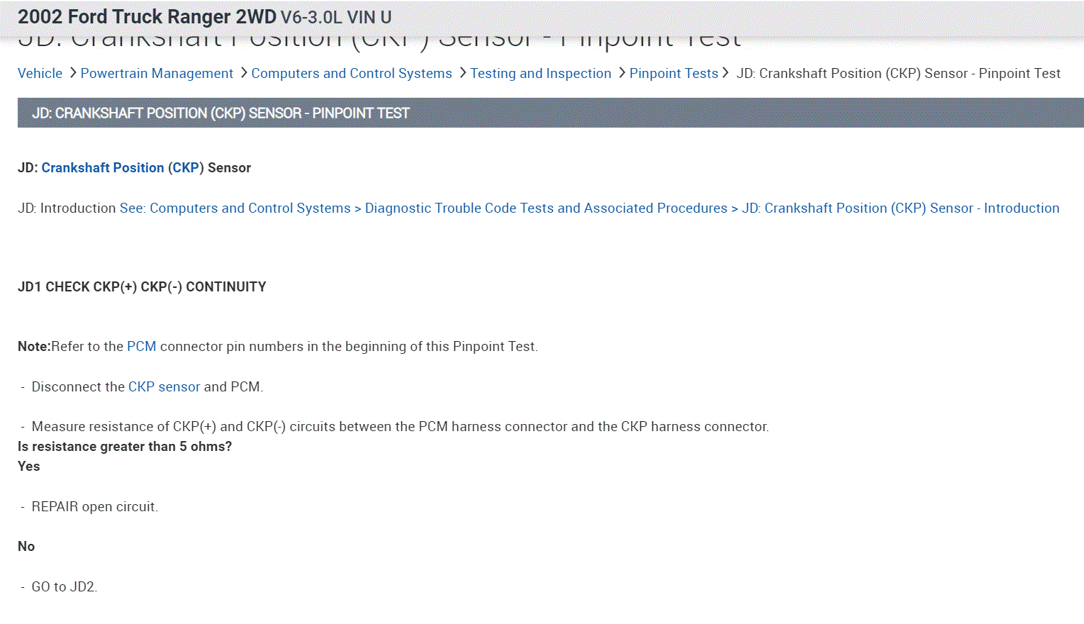

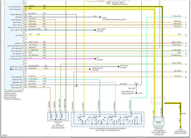

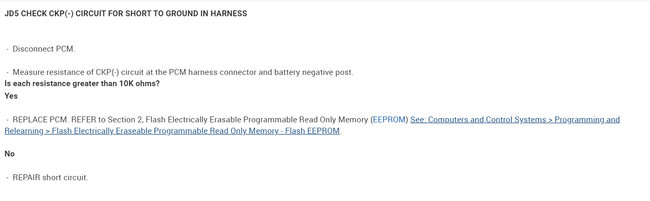

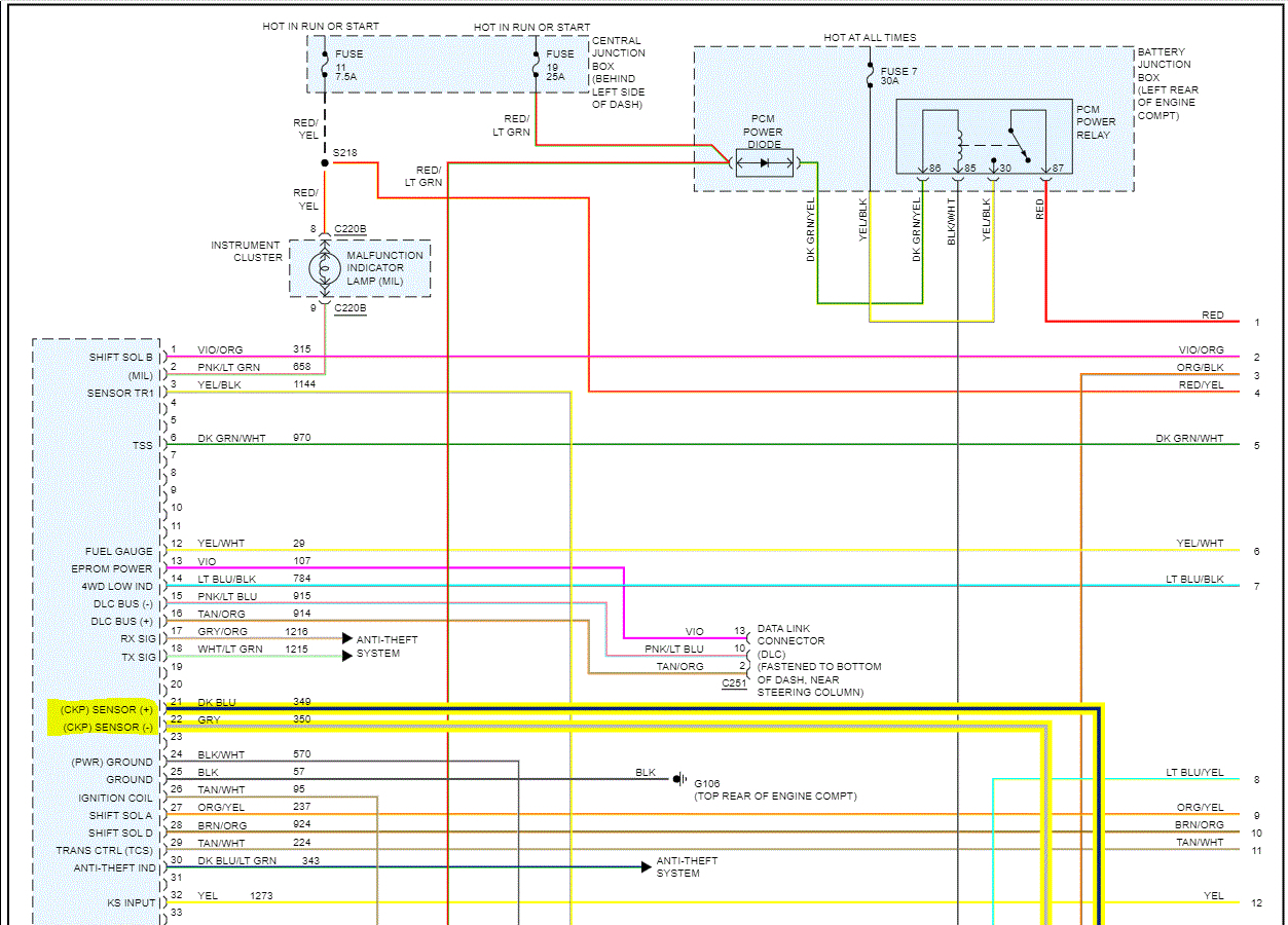

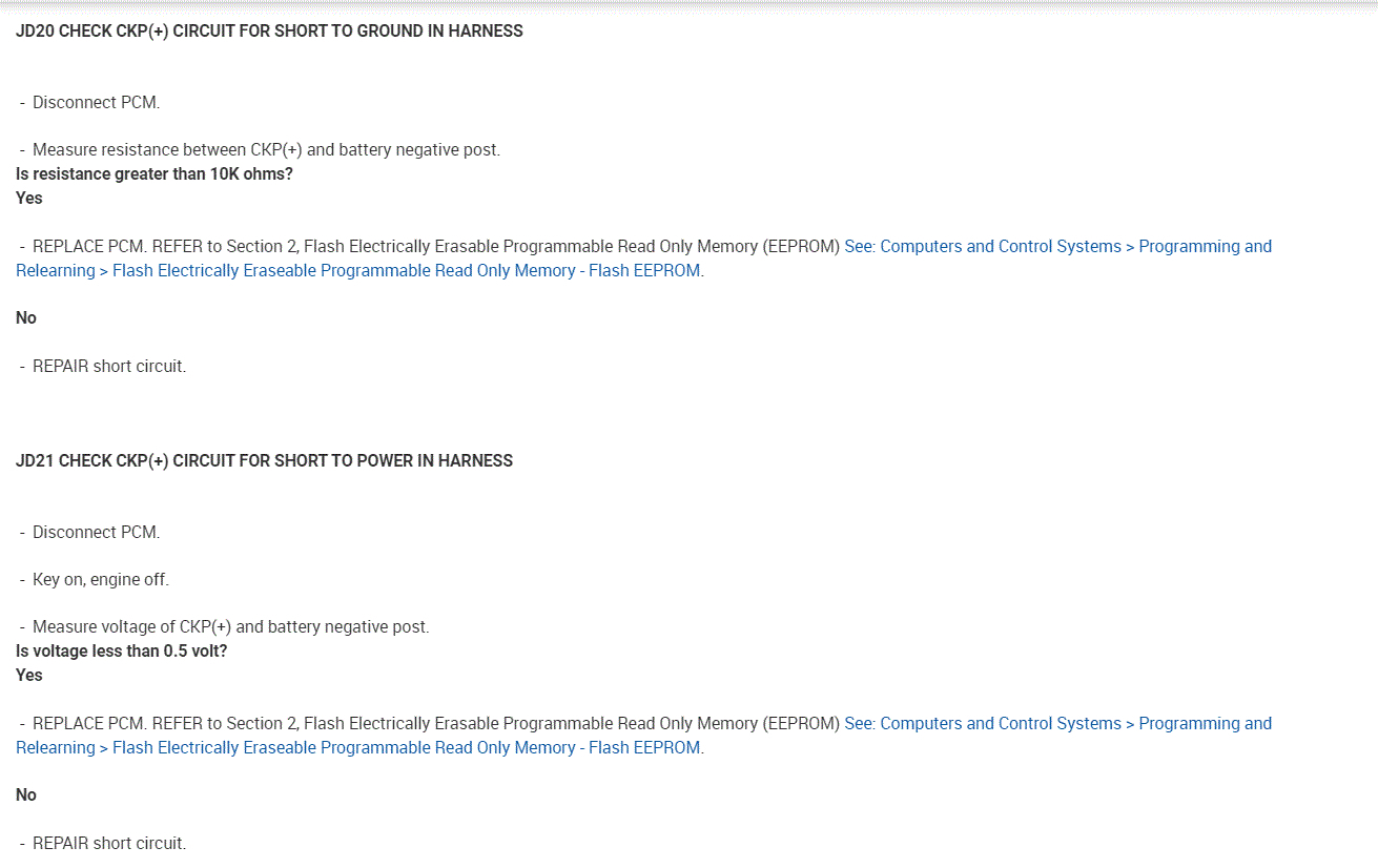

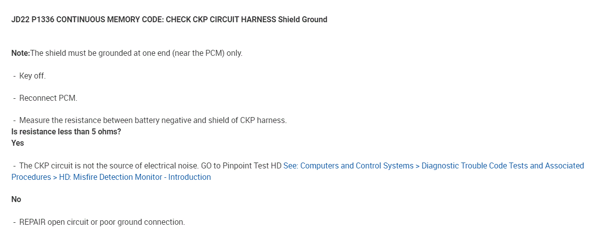

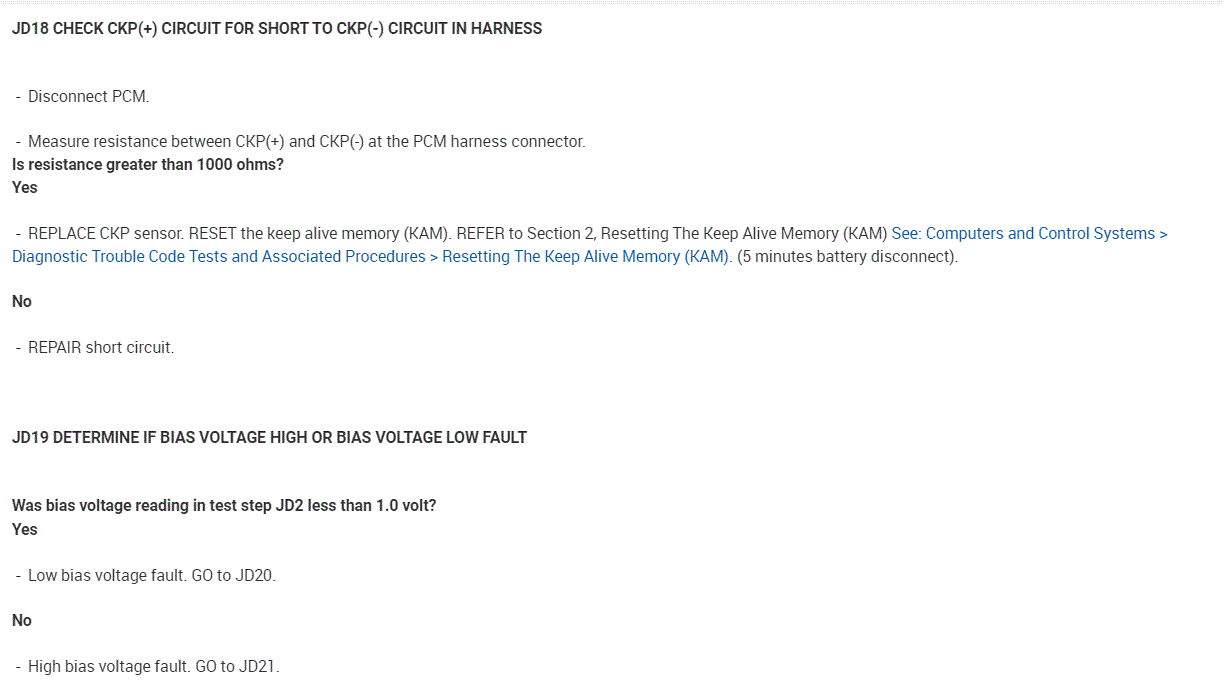

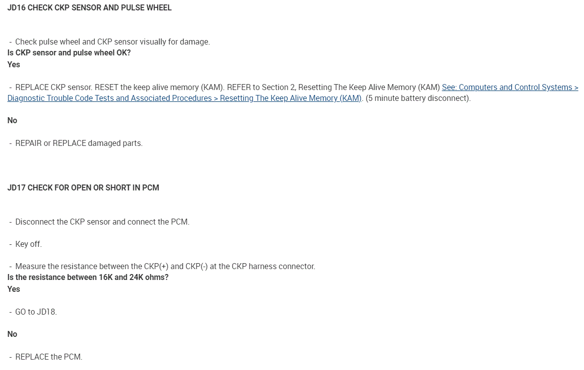

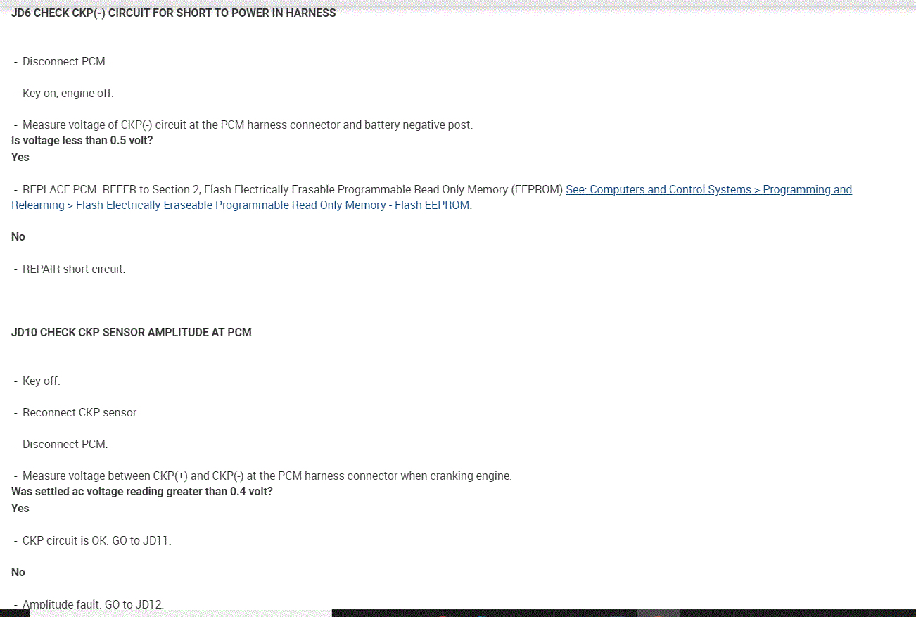

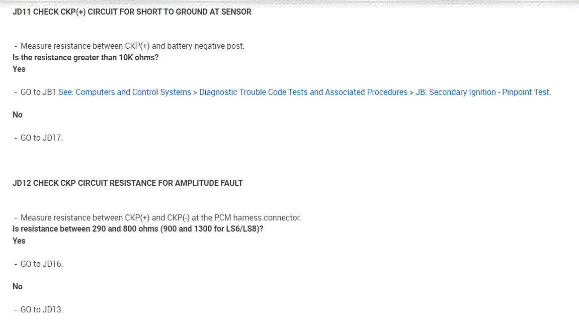

If you get no ground signal, then it's time to start checking the CKP circuit which is a bit more involved. If you look at pics 2 and 3, I provided the wiring from the CKP to the PCM. The remaining pics are the steps for testing the CKP circuit.
Let me know if this helps and what you find. If you have questions, let me know. Note: If there are no issues between the CKP and PCM and the wiring between the coil and PCM doesn't provide a signal ground, then there is a change the PCM has failed. However, make sure the trigger wheel is not loose or damaged.

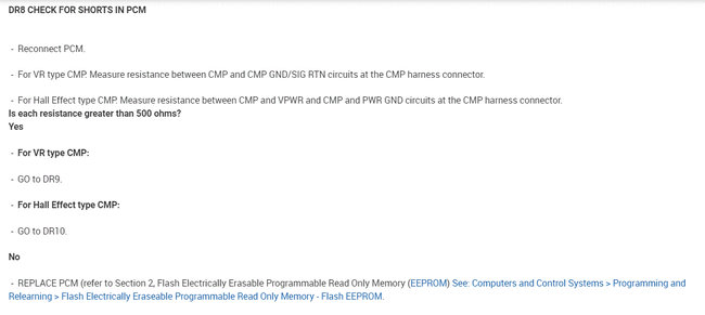

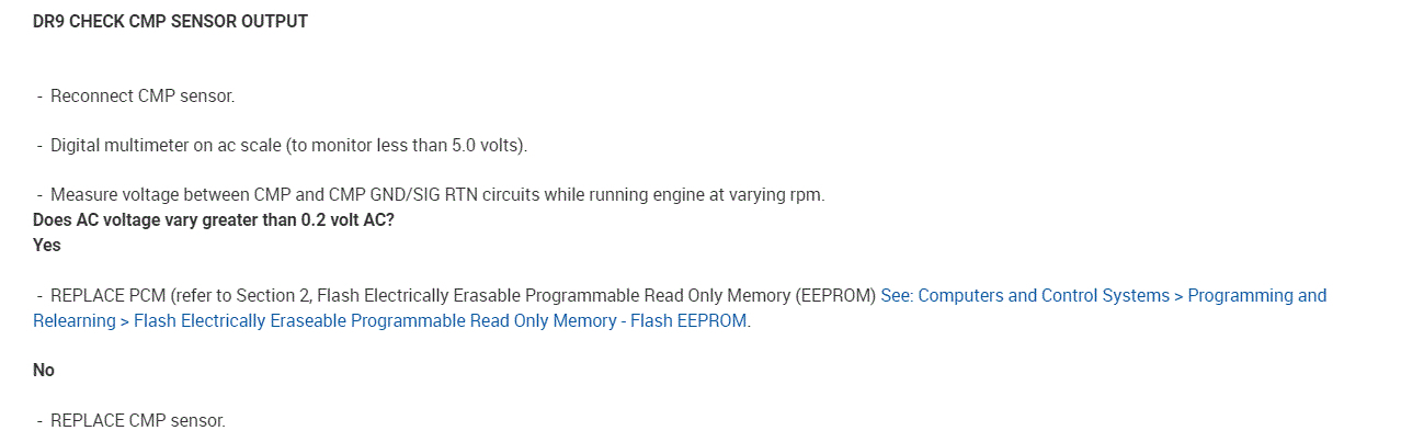

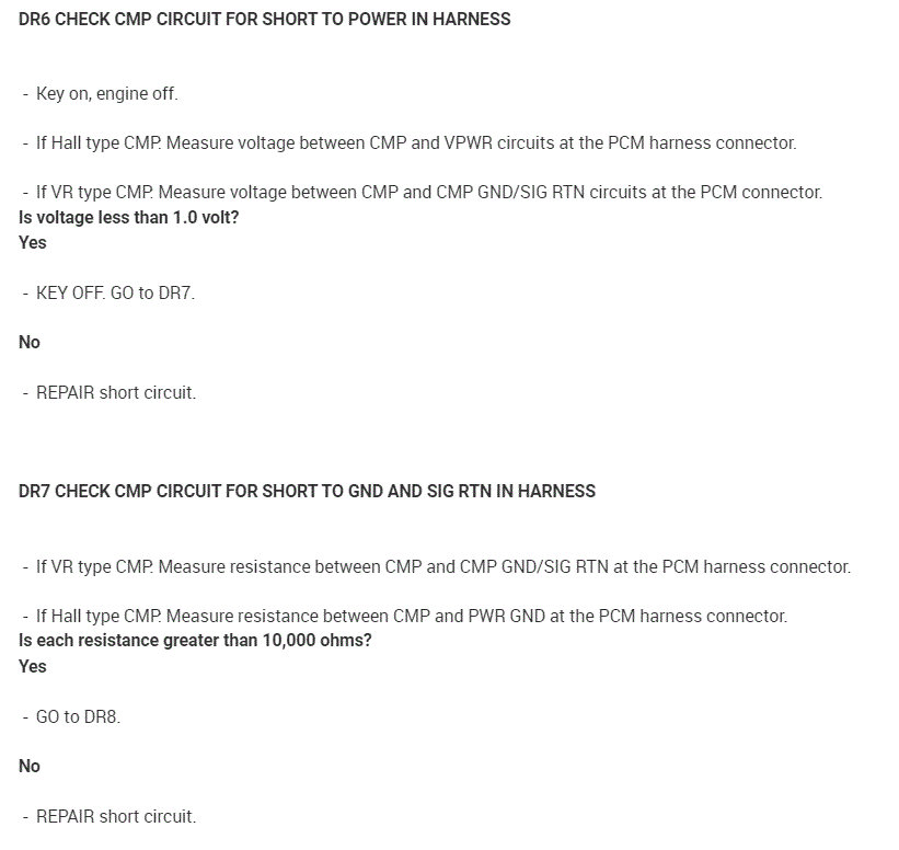

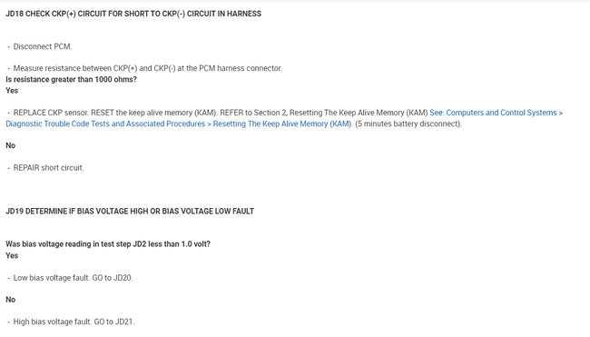

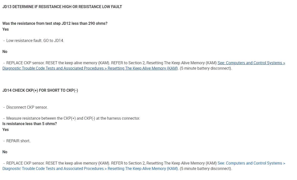

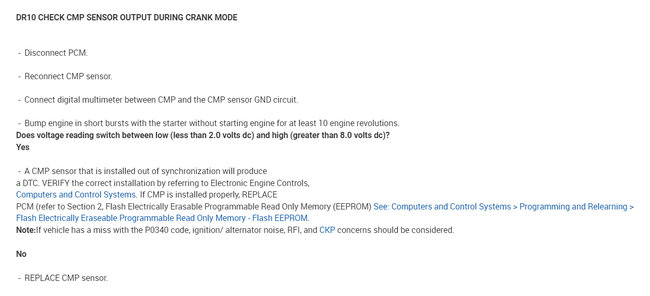

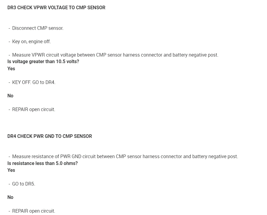

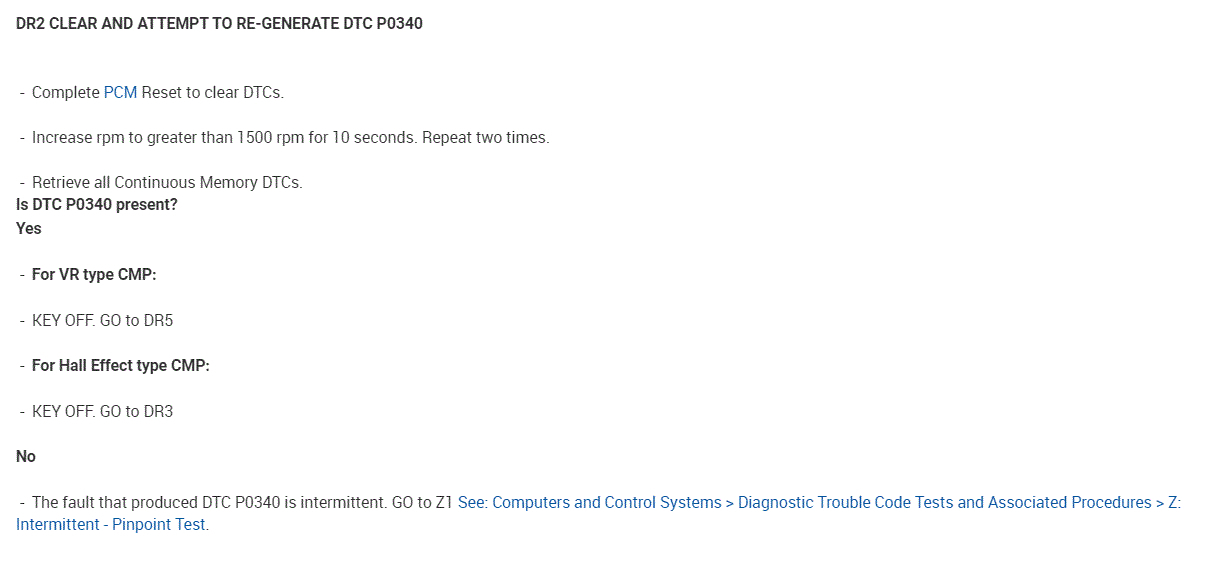

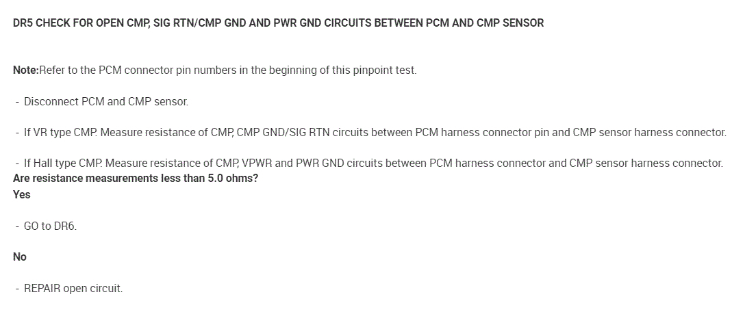

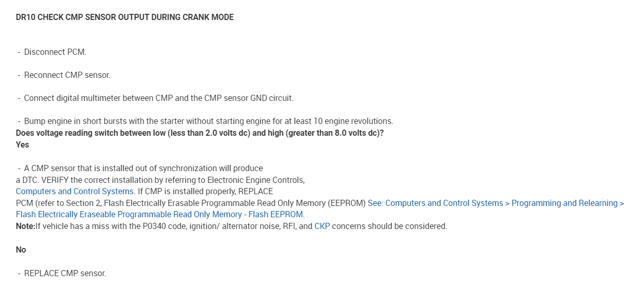

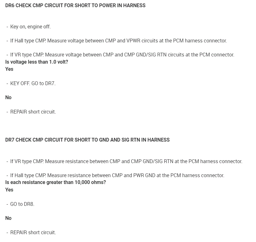

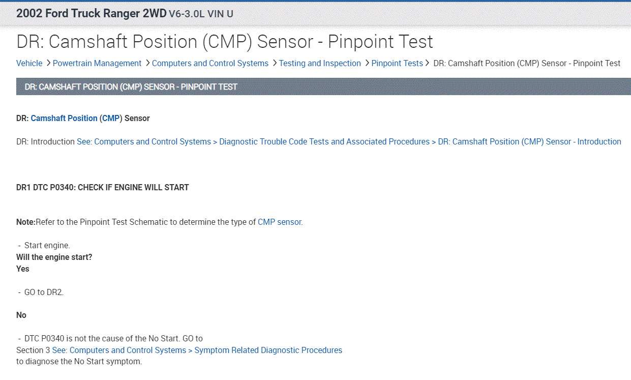

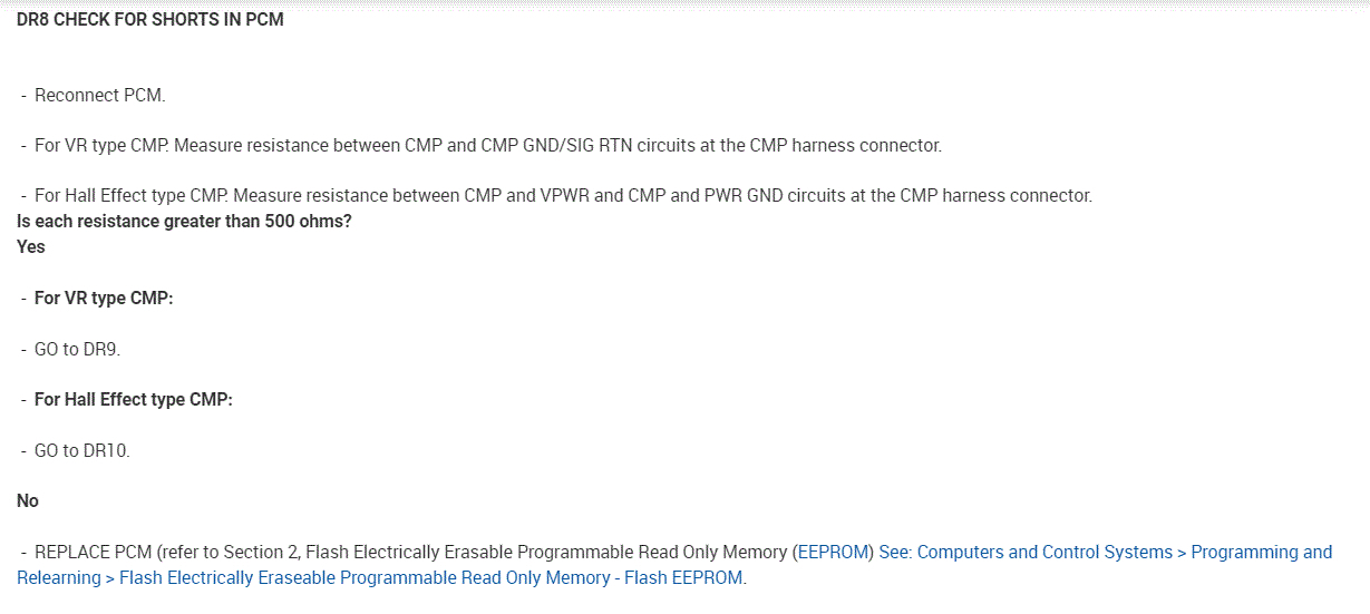

As far as the sensor is concerned, I attached the relevant diagnostics below for the P0340. Take a look through them and let me know if they help.
See pics.
Mar 16, 2022 at 1:22 PM
KHURLEY1969
Joe,
The information was helpful yes. Another frayed wire. Thank you so much for your time and energy.
