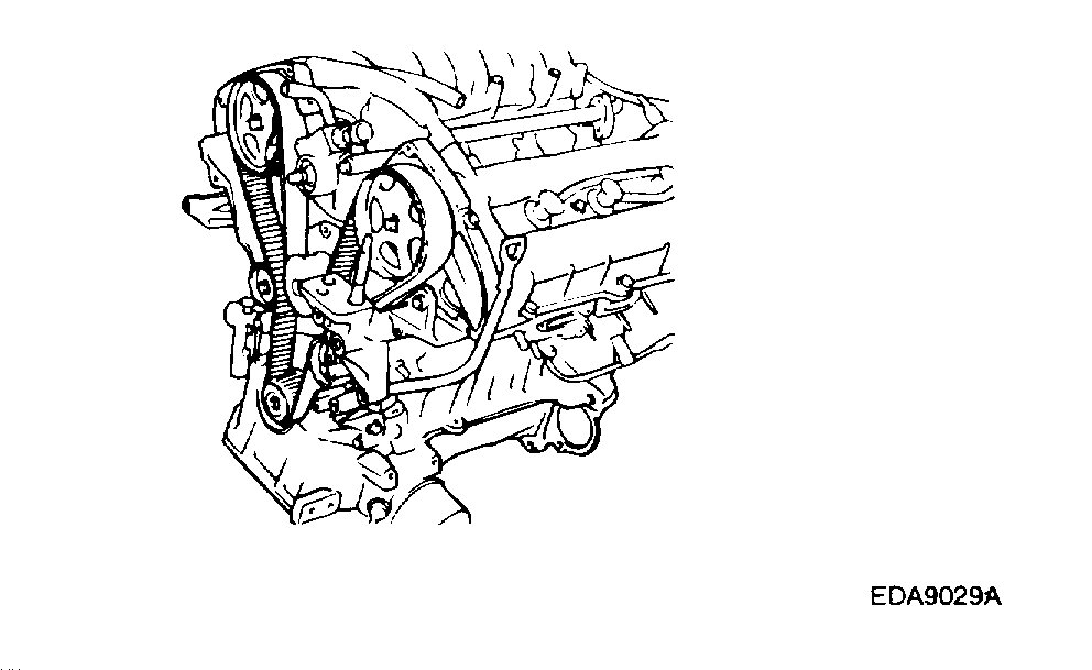

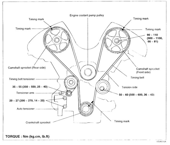

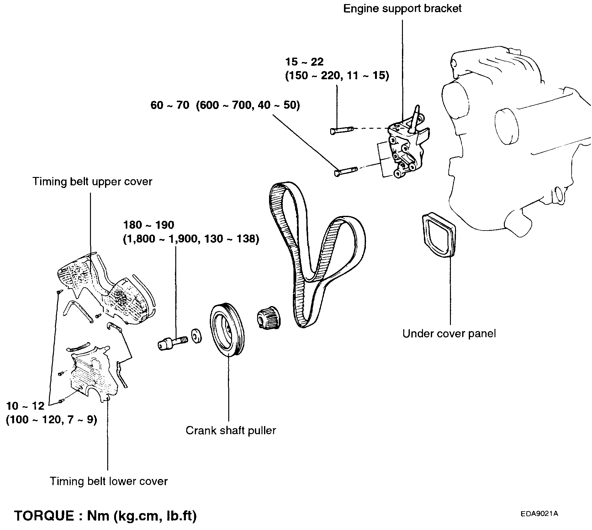

Someone has attempted to change the water pump, timing belt, and timing belt tensioner. During their repair they not only did not align timing marks properly but they also allowed the old timing belt to turn the intake sprocket about eight or nine teeth to the right in difference to the exhaust sprocket. I am assuming the only way to correct this problem is going to be to manually align the camshafts, and since this is an interference engine i am going to have to remove the cams to realign them. I need diagrams and instructions for this since i have not had any past experience with this procedure.

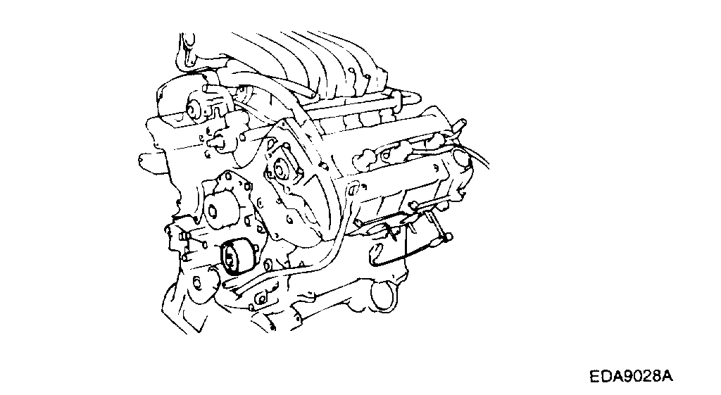

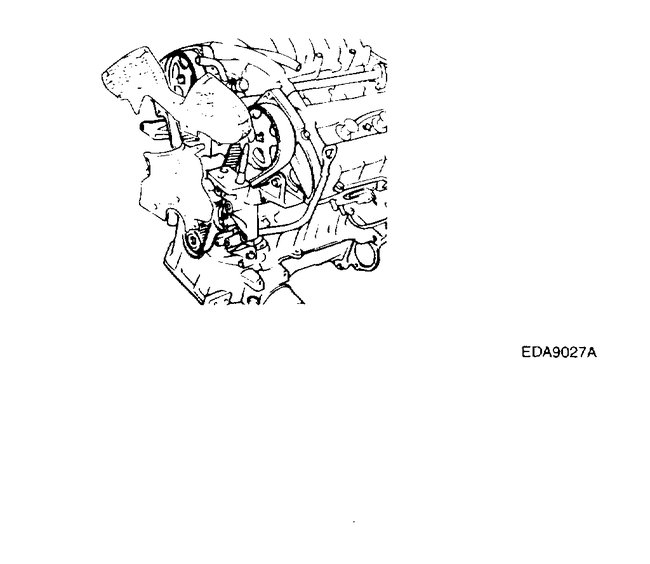

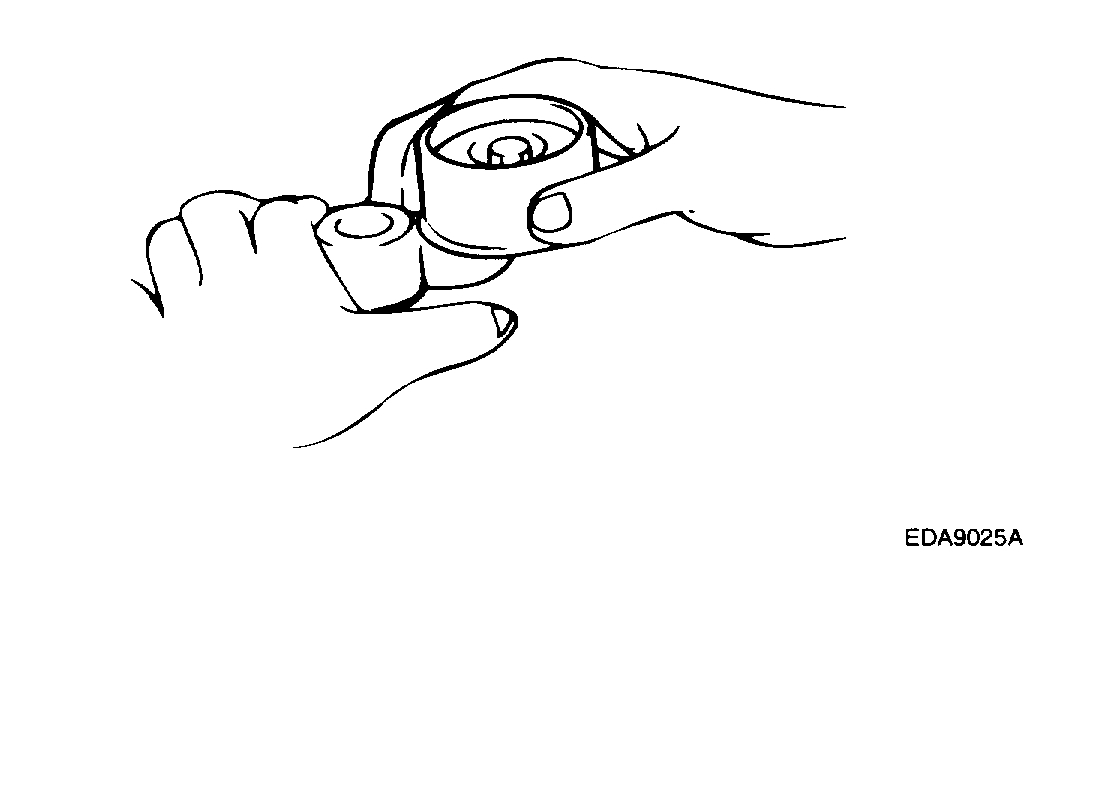

Here are the directions specific to your vehicle for belt replacement. All attached pictures correlate with these directions.
PROCEDURES
Timing Belt
Picture 1
Picture 2

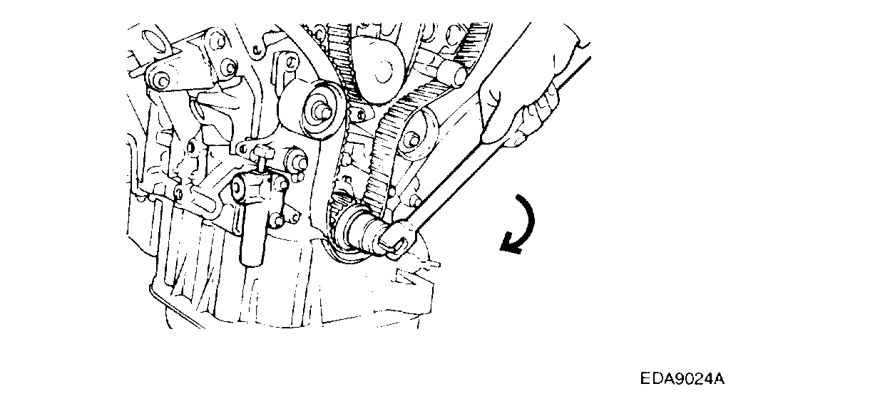

Removal
Picture 3

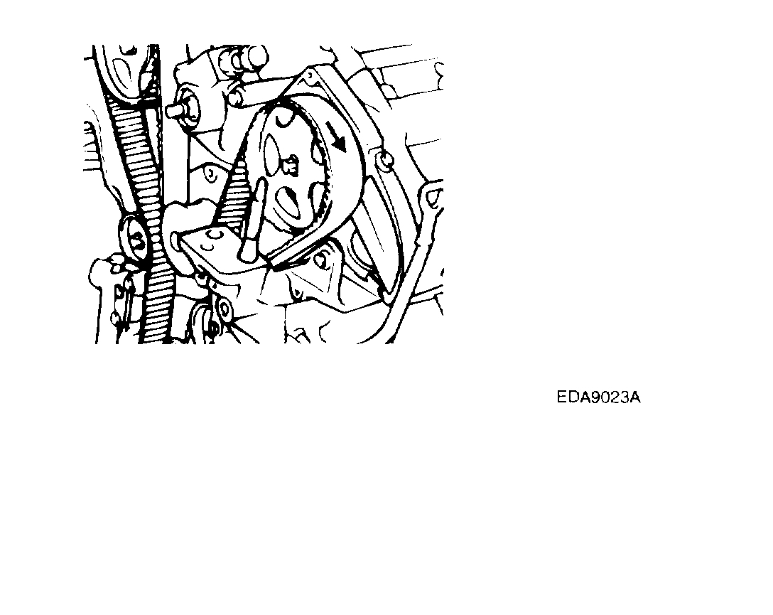

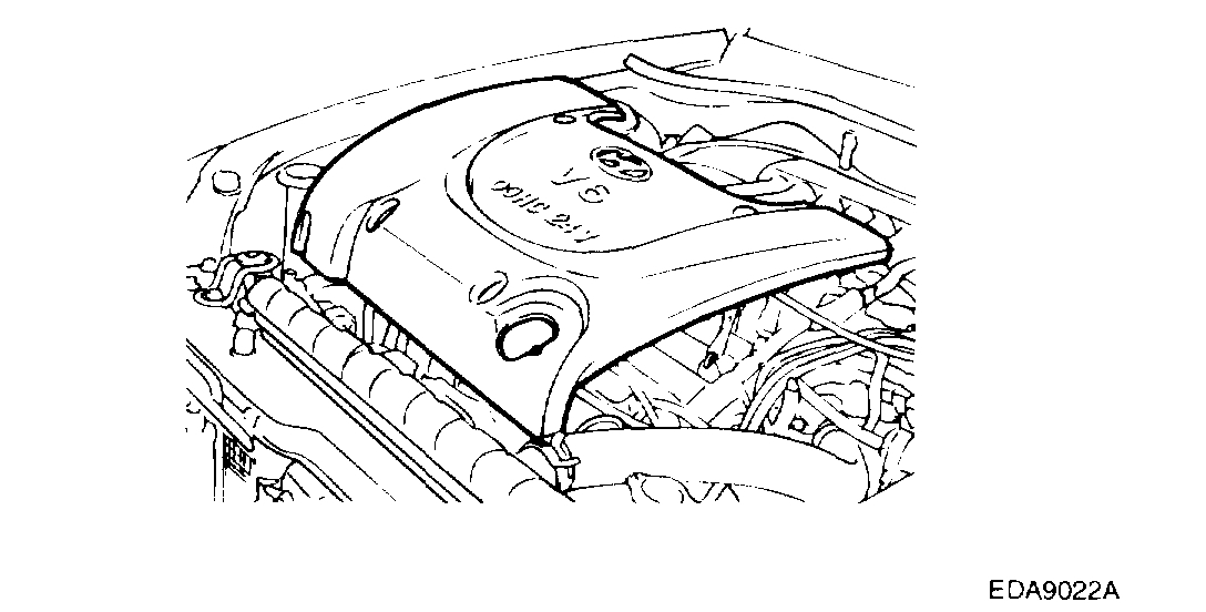

1. Remove the engine cover.

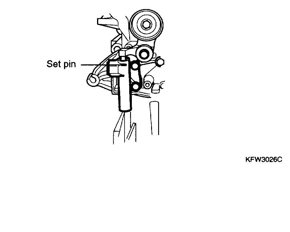

Picture 4

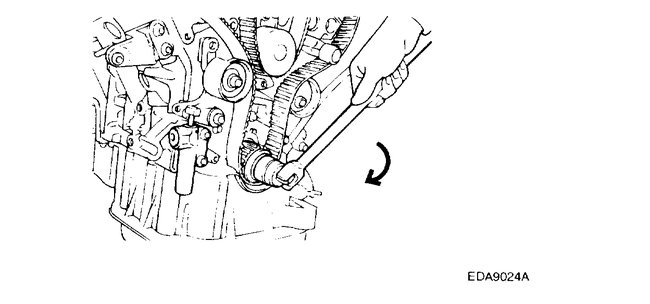

2. Using a [16 mm], rotate the tensioner arm clockwise (about 14°) and remove the belt from the pulley.
3. Remove the power steering pump pulley, idler pulley, tensioner pulley and crankshaft pulley.

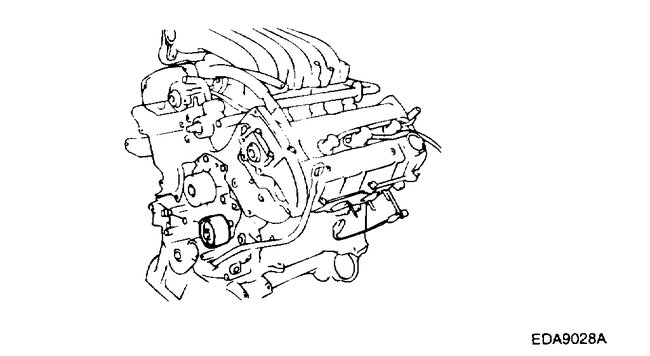

Picture 5

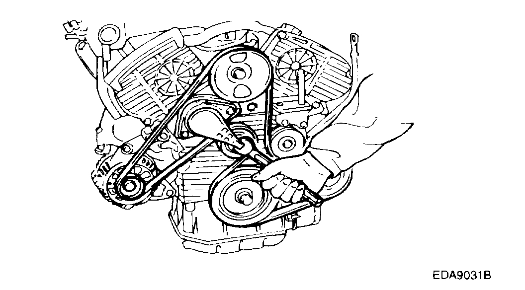

4. Remove the upper and lower timing belt covers.
Picture 6
5. Remove the auto tensioner.
Note: Rotate the crankshaft clockwise and align the timing mark to set the No. 1 cylinder's piston to TDC (compression stroke).
At this time, the timing marks of the camshaft sprocket and cylinder head cover should coincide with each other.
Picture 7
6. Unbolt the tensioner to remove the timing belt.
Note: If you plan to use the timing belt again, mark the rotation direction on the belt so you reinstall it correctly.

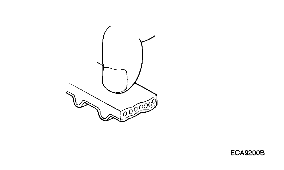

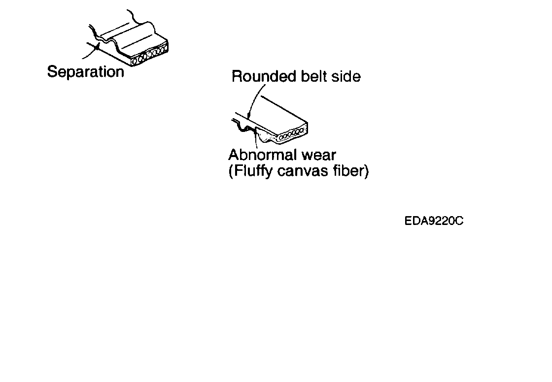

1. Inspect the belt closely. If the following problems are evident, replace the belt with a new one.
Picture 8
1) Hardened back surface of rubber Back surface is glossy, non-elastic and so hard that when the nail of your finger is pressed into it, no mark is produced.

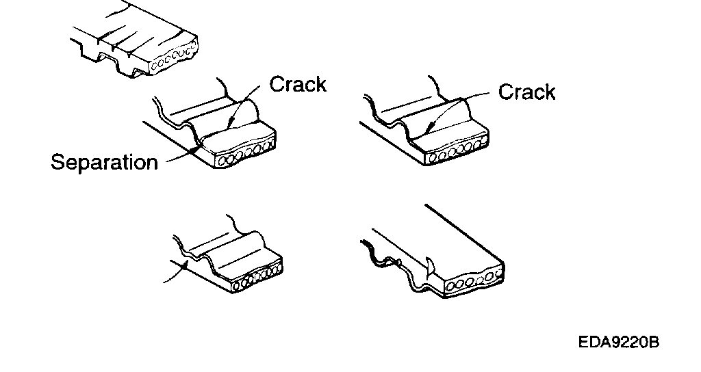

Picture 9
2) Cracked back surface of rubber.

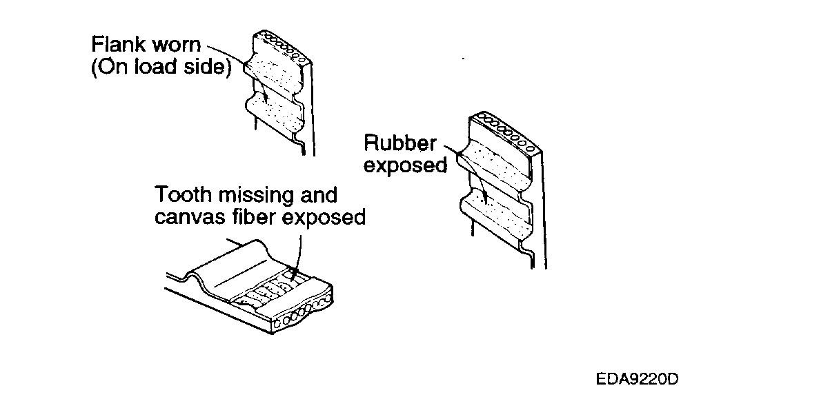

4) Teeth are badly worn out.
Initial stage: Canvas on load side of the tooth flank worn (fluffy canvas fibers, rubber gone, color changed to white, and unclear canvas texture)
Last stage: Canvas on the load side of the tooth flank worn down and rubber exposed (tooth width reduced).
Picture 11
5) Missing tooth

4. Install the camshaft sprockets and align the timing marks.
Note:
- When installing the camshaft sprockets, fasten them tightly while holding the hexagonal part of the camshaft.
- Before installing the timing belt, if the timing marks of the cam sprocket and the cylinder head cover do not coincide, do not rotate the cam sprocket more than 3 teeth in either direction.
- Rotating the sprocket more than 3 teeth may allow the valve and piston to touch each other.
- If the cam sprocket is rotated more than 3 teeth unavoidably, rotate the crankshaft counter-clock wise a bit before rotating the cam sprocket.

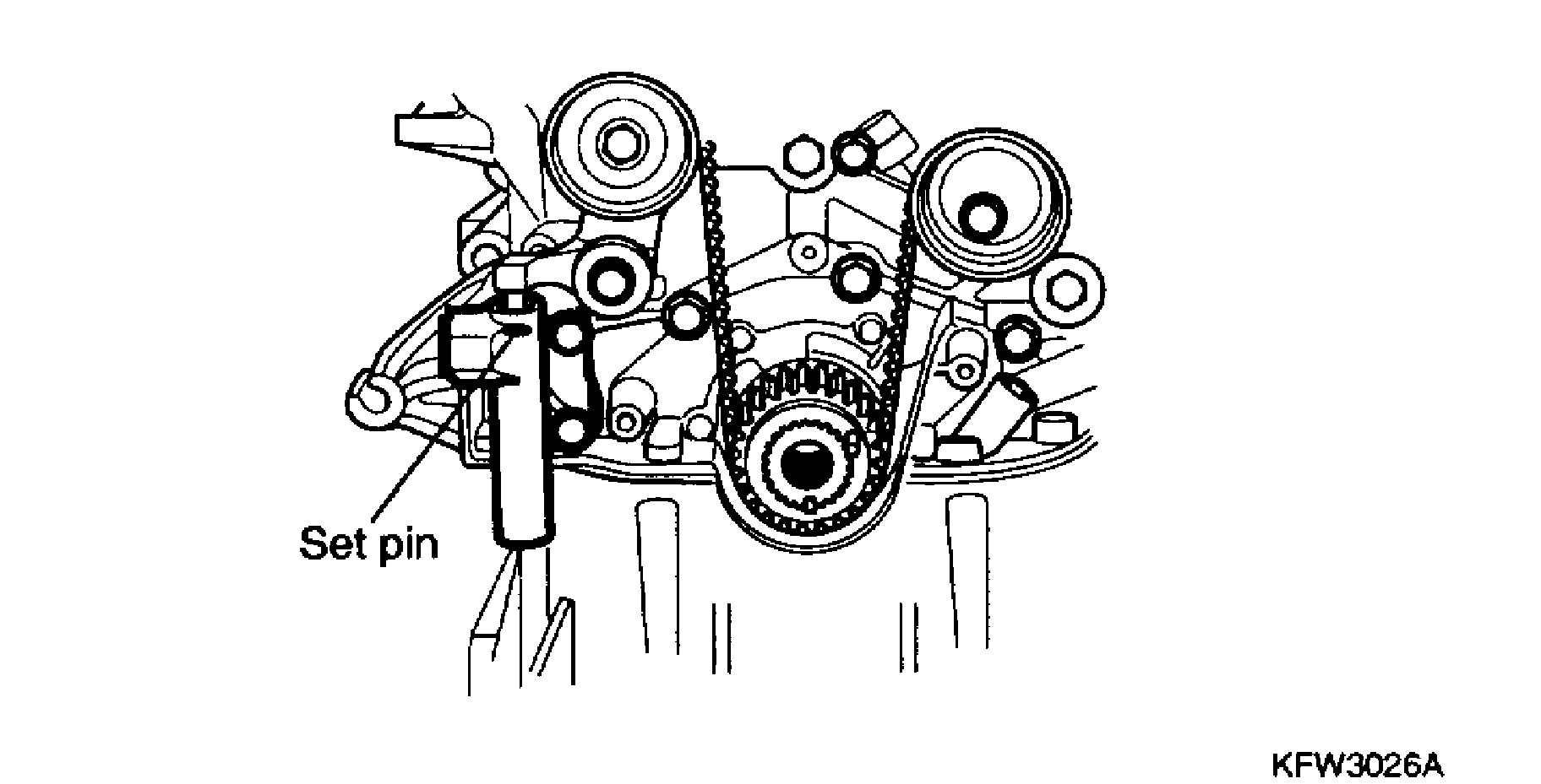

5. Install the auto tensioner to the front case.
Note:At this time auto tensioner's set pin should be compressed and secured with set pin.
Picture 16

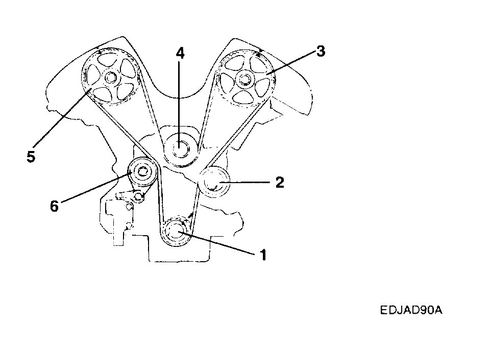

6. Align the timing marks of each sprocket and install the timing belt in the following order.
1. Crankshaft sprocket
2. Idler pulley
3. Camshaft sprocket (LH side)
4. Water pump pulley
5. Camshaft sprocket (RH side)
6. Tensioner pulley
Note:
- In this step, No. 1 cylinder is in the TDC (Compression stroke).

7. Pull out the set pin of the auto tensioner.

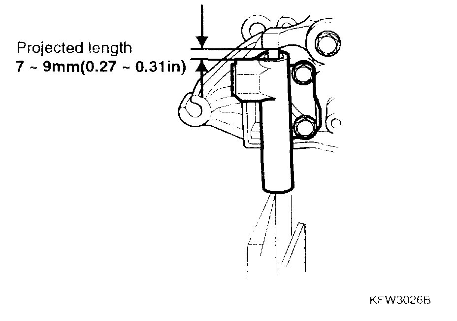

How To Adjust The Tension Of The Timing Belt
1. Rotate the crankshaft 2 turns clockwise and measure the projected length of the auto tensioner at TDC (# 1 Compression stroke) after 5 minutes.
2. The projected length should be 7-9 mm.
Picture 18
