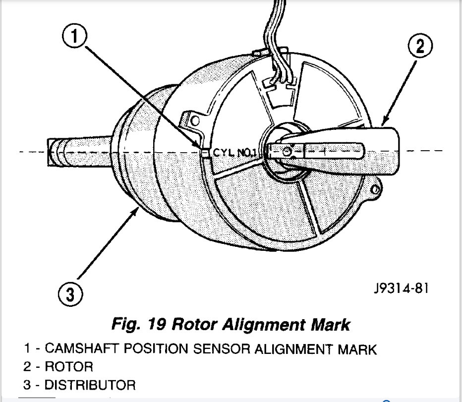

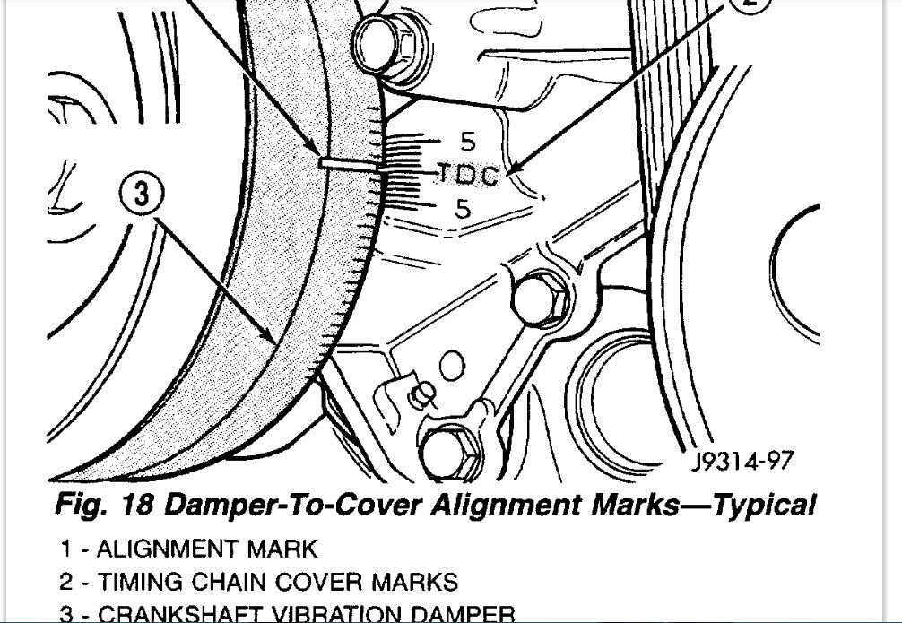

I removed the camshaft and lost the position of the oil pump drive gear, it has a slot that the distributor sits in. how do I get it in the right groove so it is pointing to number one cylinder?

You'll need to first bring the crankshaft to top dead center of the compression stroke. Removing the number one spark plug and having a helper turn the crankshaft until you feel air push against your finger in the plug hole well get you close, then line up the marks on the balancer and timing tab to top dead center.
Now you need to align the rotor to the mark in the distributor body. You can look at the bottom of the distributor shaft and get an idea of where the oil pump shaft needs to be. Using a long flat blade screwdriver you can turn the oil pump shaft so it's in proper position to engage when the distributor is dropped in on it's mark to number one. I'll post some images below along with the factory steps.

7. Slowly rotate engine clockwise, as viewed from front, until indicating mark on crankshaft vibration damper is aligned to 0 degree (TDC) mark on timing chain cover.
8. The distributor rotor should now be aligned to the CYL. NO.1 alignment mark (stamped) into the camshaft position sensor. If not, rotate the crankshaft through another complete 360 degree turn. Note the position of the number one cylinder spark plug cable (on the cap) in relation to rotor. Rotor should now be aligned to this position.

Rotate crankshaft in a clockwise direction, as viewed from front, until number one cylinder piston is at top of compression stroke (compression should be felt on finger with number one spark plug removed). Then continue to slowly rotate engine clockwise until indicating mark is aligned to 0 degree (TDC) mark on timing chain cover.

4. Position distributor into engine to its original position. Engage tongue of distributor shaft with slot in distributor oil pump drive gear. Position rotor to the number one spark plug cable position.
5. Install distributor holddown clamp and clamp bolt. Do not tighten bolt at this time.
6. Rotate the distributor housing until rotor is aligned to CYL. NO.1 alignment mark on the camshaft position sensor.
