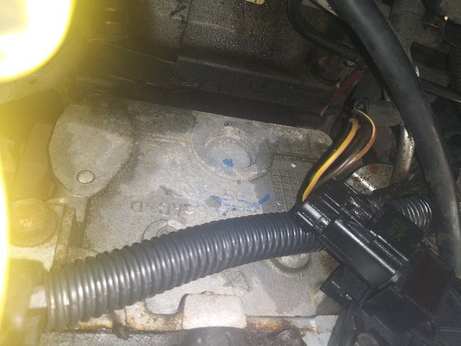

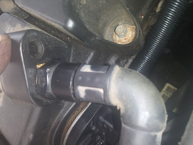

The camshaft position sensor is on the rear of the cylinder. You will need basic tools such as sockets and a ratchet.
If you look at the pics below, I attached the directions for the removal and replacement of the component. Note, under the sensor is a target magnet. If you replace the sensor and it makes no difference, remove the target magnet, and make sure the dowel pins are aligned and not broken. Information related to them is included in the directions below.
The last attachment below is a clearer picture of the sensor's location.
Hope this helps. Let me know if you have other questions or if there is something I can do to help.

Is there a better diagram available? I'm having issues with these being blurred when I enlarge.

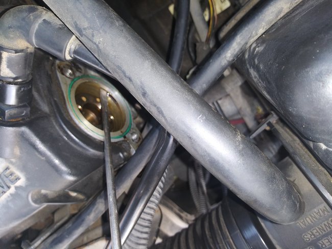

Okay my next question is, is there supposed to be an O ring in this area that I find out with the screwdriver? The target magnet is also cracked the whole length of the bottom of the dowel pins to both edges of the diameter. Do I need to replace the target magnet as well?

When you say both were replaced, do you also mean the target magnet? If it is cracked, it is bad. Also, the green O-ring in the pic is the only one.

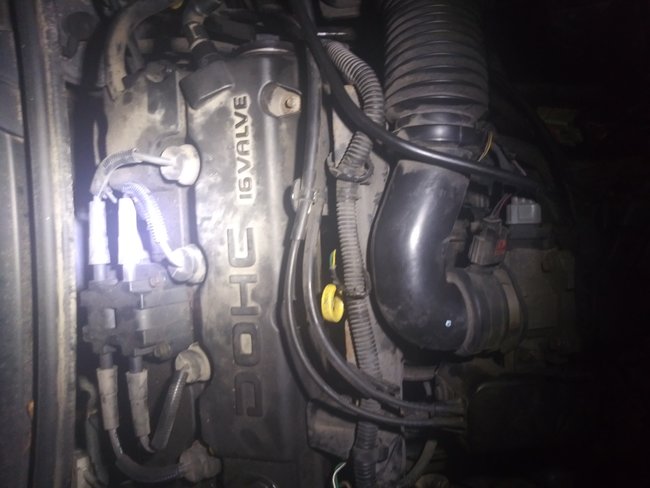

I'm sorry I don't know if it got in the video or not, was wondering if the hole next to the PVC valve and the part that's missing from underneath right where the camshaft sensor was and the PVC valve, are they essential to its running?

The pic with the PCV valve looks as though a bolt is missing. See pic 1 below and let me know if that looks like the correct position.
If there is no air coming out or a vacuum, that shouldn't prevent it from starting.
If you look at pic 2, I highlighted what I believe you are showing me in the pic you sent. Was anything removed from there? I ask because that is indicated as "if equipped" so you may not even have one.

No spark, the EGR and transducer were there when I bought the car, and they were there open until 3 days ago that I know of that's why you can see the outline of it because it was actually there. Is that important? I noticed from the book of the picture that you sent my car has a different and I sent the picture fuse and relay box main power distribution whatever it is tell my end I know that my quill wires have been changed because they were a different style that were on there as of two days ago. I'm finally able to lock the vehicle. So, I'm hoping that no more of my parts go missing and my cameras are now up and running catch whoever's been taking them.

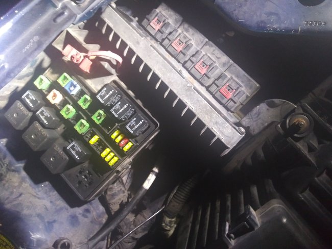

Okay, so I'll replace the EGR and transducer. It was the cam sensor. I don't have an owner's book for her and as the fuse box is different than what was in the diagram and picture,
could you send a picture of mine with what all of the fuses and relays go to? I was told there is one relay I should never mess with unless I have to replace it, something about the brain and it would never run again? I will see if I can get ahold of a live data scan tool in the morning.

I'm sorry to hear that about your father. I lost a parent to that disease. As far as the fuse box, my manual doesn't give specific functions of each fuse or relay for this vehicle. Take a look at what I attached. When there is an issue and I need to look through a schematic, it identifies the fuse I need to check.
Let me know if this helps in any way. If it does, I'll be happy to send the fuse information for the under-hood power distribution box.
