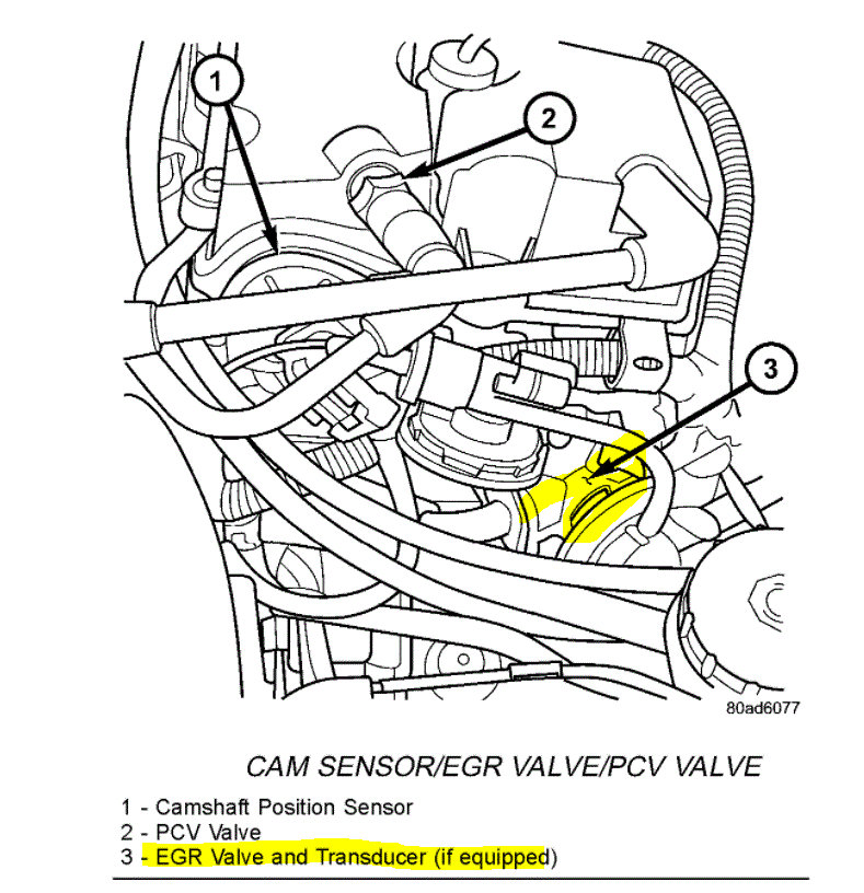

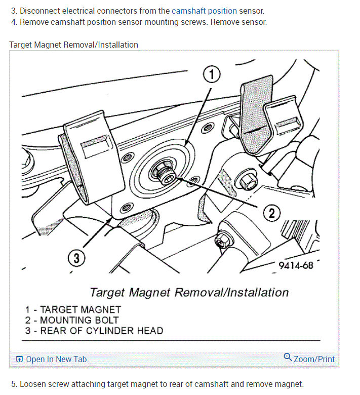

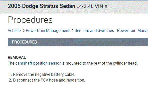

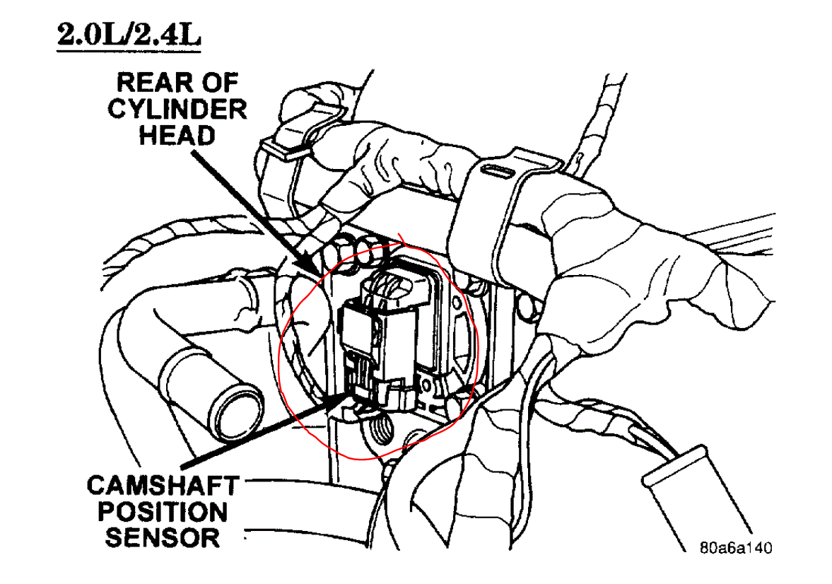

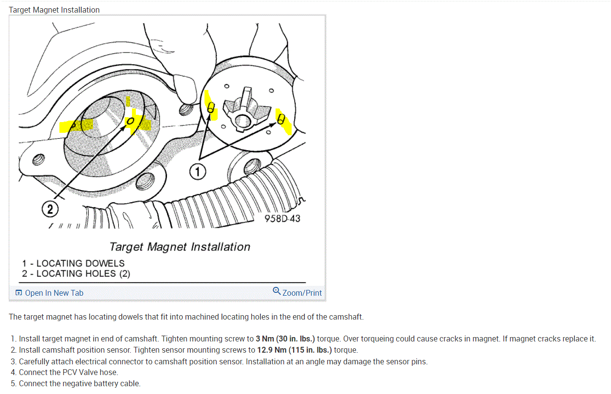

The camshaft position sensor is on the rear of the cylinder. You will need basic tools such as sockets and a ratchet.

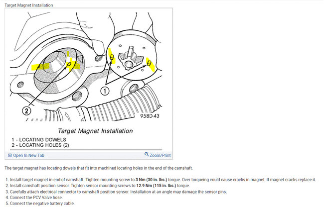

If you look at the pics below, I attached the directions for the removal and replacement of the component. Note, under the sensor is a target magnet. If you replace the sensor and it makes no difference, remove the target magnet, and make sure the dowel pins are aligned and not broken. Information related to them is included in the directions below.
The last attachment below is a clearer picture of the sensor's location.
Hope this helps. Let me know if you have other questions or if there is something I can do to help.

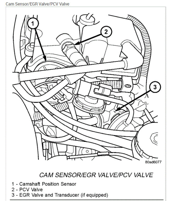

Is there a better diagram available? I'm having issues with these being blurred when I enlarge.

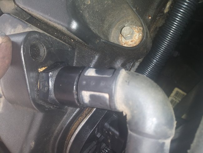

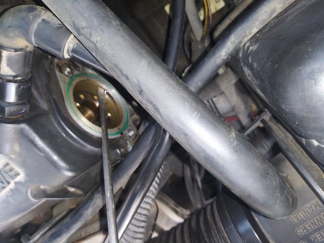

Okay my next question is, is there supposed to be an O ring in this area that I find out with the screwdriver? The target magnet is also cracked the whole length of the bottom of the dowel pins to both edges of the diameter. Do I need to replace the target magnet as well?

When you say both were replaced, do you also mean the target magnet? If it is cracked, it is bad. Also, the green O-ring in the pic is the only one.

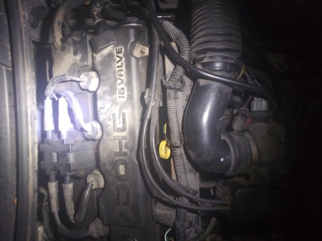

Now, if you replaced the magnet and the sensor, we need to check a couple of things. First, we need to confirm there is spark at the spark plugs. Here is a link that shows how it is done:
If they have spark, I need you to try something. See if the engine starts using starting fluid. If it does start and then stall, we know it's a fuel-related issue.
Do this and let me know what you find. Also, if you have a scan tool that can read live data, let me know.

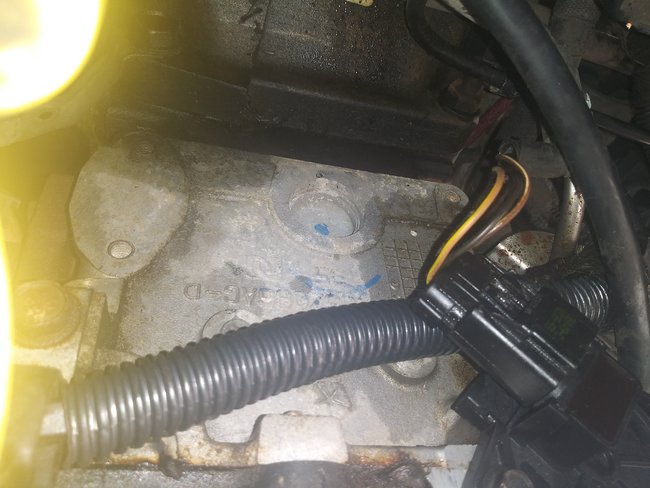

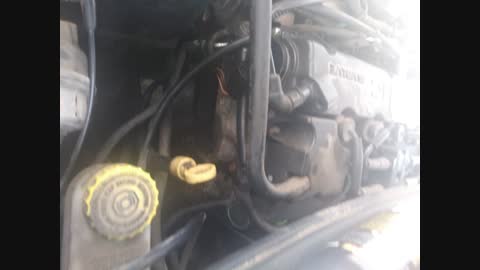

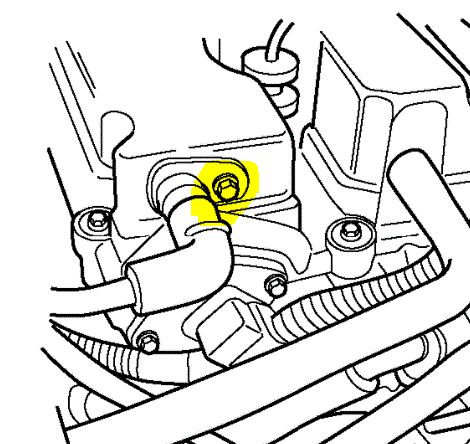

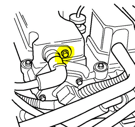

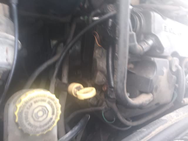

I'm sorry I don't know if it got in the video or not, was wondering if the hole next to the PVC valve and the part that's missing from underneath right where the camshaft sensor was and the PVC valve, are they essential to its running?
Oct 6, 2021 at 5:08 AM
  • 110,241 POSTS
The pic with the PCV valve looks as though a bolt is missing. See pic 1 below and let me know if that looks like the correct position.
If there is no air coming out or a vacuum, that shouldn't prevent it from starting.
If you look at pic 2, I highlighted what I believe you are showing me in the pic you sent. Was anything removed from there? I ask because that is indicated as "if equipped" so you may not even have one.

No spark, the EGR and transducer were there when I bought the car, and they were there open until 3 days ago that I know of that's why you can see the outline of it because it was actually there. Is that important? I noticed from the book of the picture that you sent my car has a different and I sent the picture fuse and relay box main power distribution whatever it is tell my end I know that my quill wires have been changed because they were a different style that were on there as of two days ago. I'm finally able to lock the vehicle. So, I'm hoping that no more of my parts go missing and my cameras are now up and running catch whoever's been taking them.

The EGR won't cause a no spark condition, but a crankshaft position sensor can. By any chance, do you have access to a live data scan tool? If you do, check to see if there is an RPM signal when cranking the engine.
If you don't, when the vehicle won't start, pay attention to the tachometer to see if it is moving when you crank the engine.
Now, the EGR needs to be replaced. It is an emission component, and if things are missing, it will cause a large vacuum leak. However, it won't shut down spark. Was it the cam or crank sensor that was replaced?

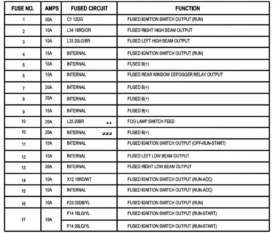

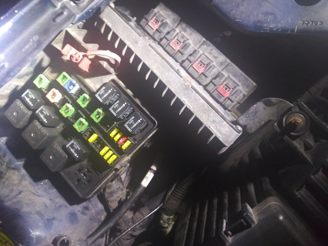

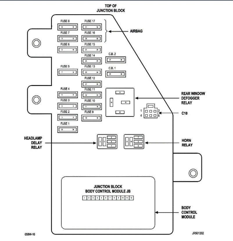

Okay, so I'll replace the EGR and transducer. It was the cam sensor. I don't have an owner's book for her and as the fuse box is different than what was in the diagram and picture,
could you send a picture of mine with what all of the fuses and relays go to? I was told there is one relay I should never mess with unless I have to replace it, something about the brain and it would never run again? I will see if I can get ahold of a live data scan tool in the morning.

I'm sorry to hear that about your father. I lost a parent to that disease. As far as the fuse box, my manual doesn't give specific functions of each fuse or relay for this vehicle. Take a look at what I attached. When there is an issue and I need to look through a schematic, it identifies the fuse I need to check.
Let me know if this helps in any way. If it does, I'll be happy to send the fuse information for the under-hood power distribution box.

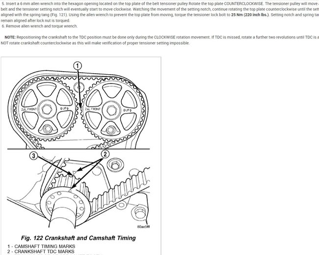

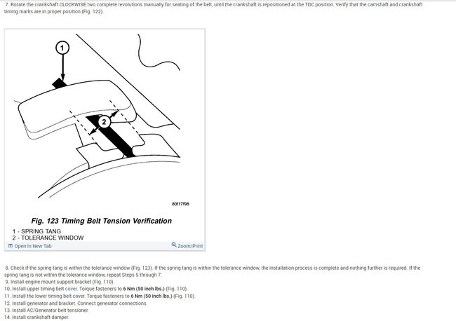

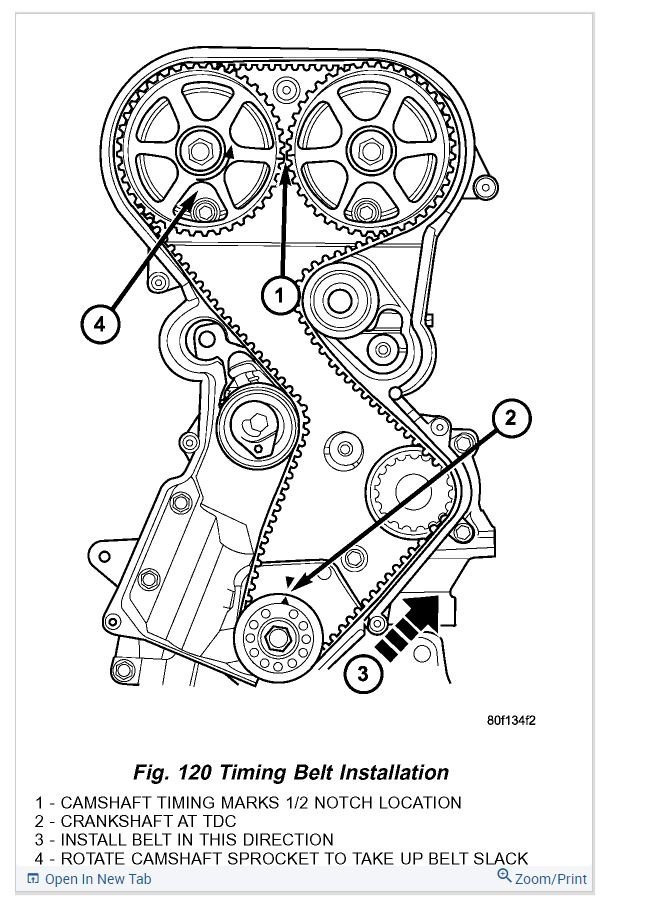

I think you have a broken timing belt, but it's very hard to hear. Please have someone crank the engine while you record close to the engine so I can better hear it. I can tell if that is the issue based on sound.
Oct 18, 2021 at 2:06 PM
MICHELLE WIERSMA RUSH
  • 34 POSTS

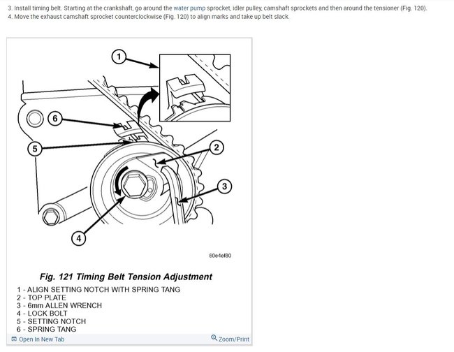

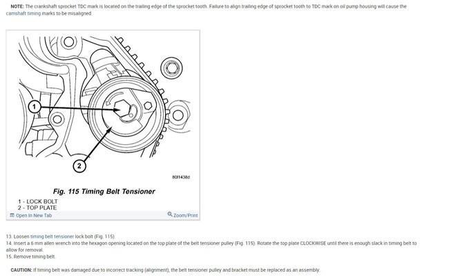

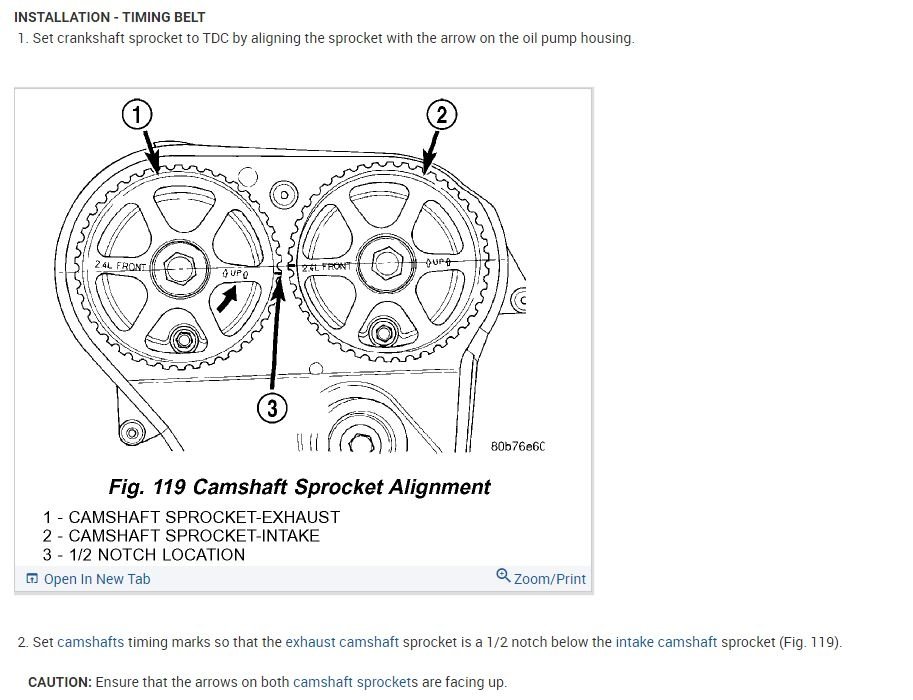

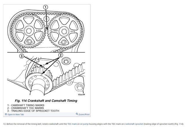

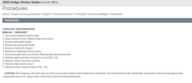

Okay, if it is the timing belt, what is book time for an amateur with basic tool set?
Oct 18, 2021 at 3:33 PM
MASTER ASE TECH
  • 82 POSTS
Professional time from all data is 4.0 hours. Figure double that for a driveway repair.
Luckily that engine is not an interference engine, so there should not be any valve or internal engine damage.
Below is the procedure.
Oct 19, 2021 at 5:54 AM
