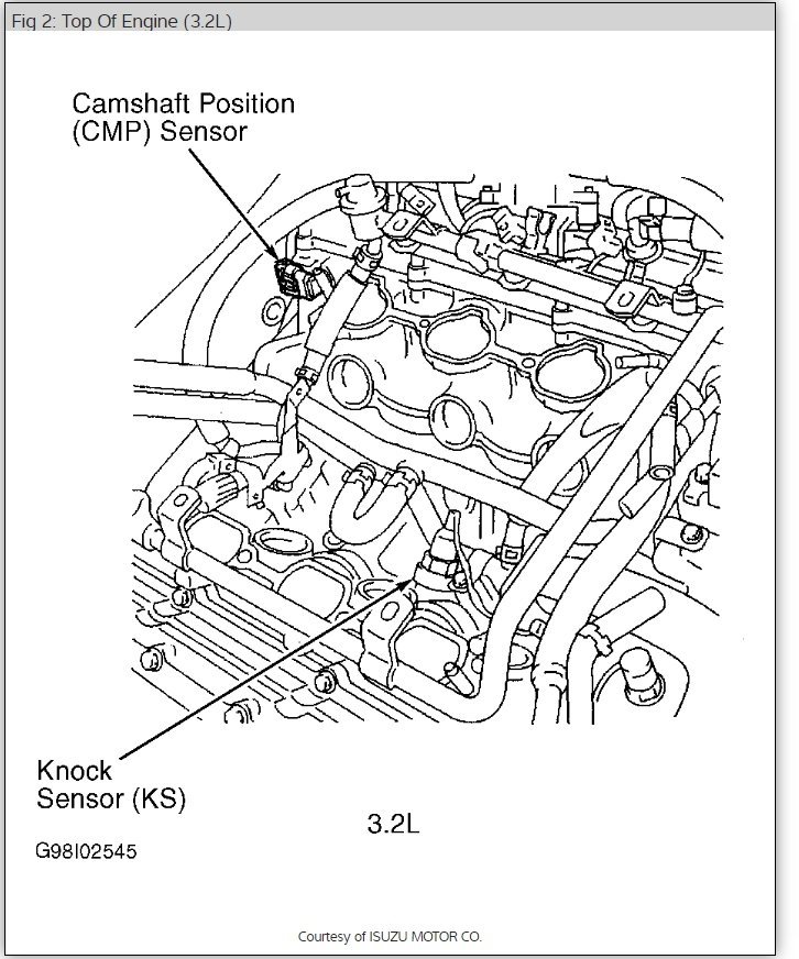

I replaced my head gasket and I can’t seem to find where to plug in my cam position sensor.
Friday, January 29th, 2021 AT 11:10 AM (Merged)
  • 52,797 POSTS
Good afternoon,
The sensor is on the left rear cylinder head. I attached a picture and the location for the sensor.
CMP is located Left Rear cylinder head. When the Hall-effect switch is activated, it grounds the signal line to the PCM, pulling the camshaft position sensor signal circuit's applied voltage low. This is a CMP signal. The CMP signals is created as piston # 1 is approximately 25 ° after top dead counter on the power stroke. If the correct CMP signal is not received by the PCM, DTC P0341 will be set.

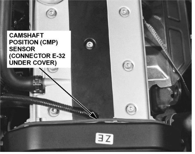

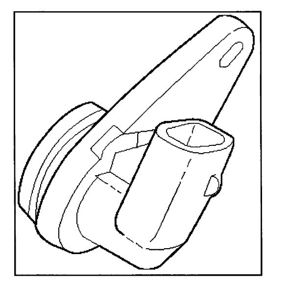

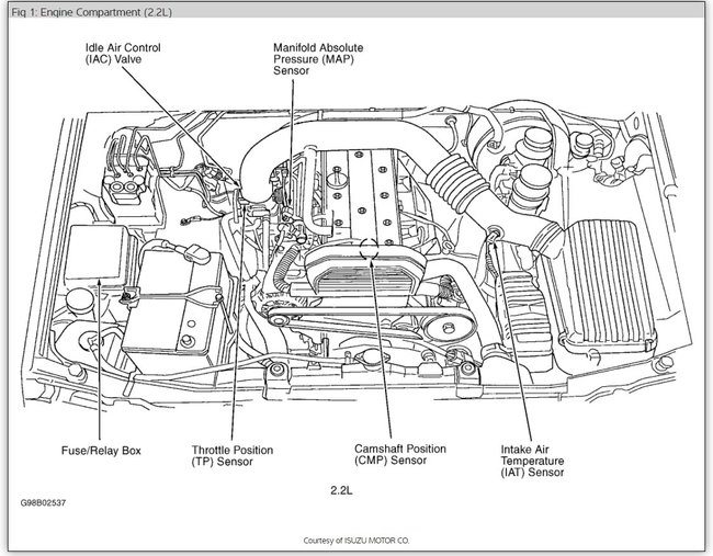

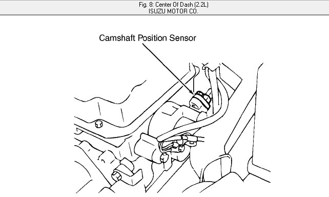

My engine light is on and the OBDII code is the cam position sensor. I have the picture as to where it is located but I do not know how to get the final black cover off to get to it. I have had the engine light coming on for over eight years and have always managed to do different things to get it to stay off and have it smogged; such as having the gas tank half full, making sure the gas cap is completely turned at least five times, etc. But this time it will not stay off. The smog man read the code on his scanner as well as a friend of mine's scanner and it says the cam position sensor. I believe it is just totally dirty so the contact points are bad but I will replace it if I can know how to do this. Please help and thank you.
KEN L
  • MASTER CERTIFIED MECHANIC
  • 48,363 POSTS
It looks like the camshaft position sensor is located near the top of the engine. Here is a guide and a diagram (below) that will help you get the job done.
https://www.2carpros.com/articles/camshaft-angle-sensor-replacement

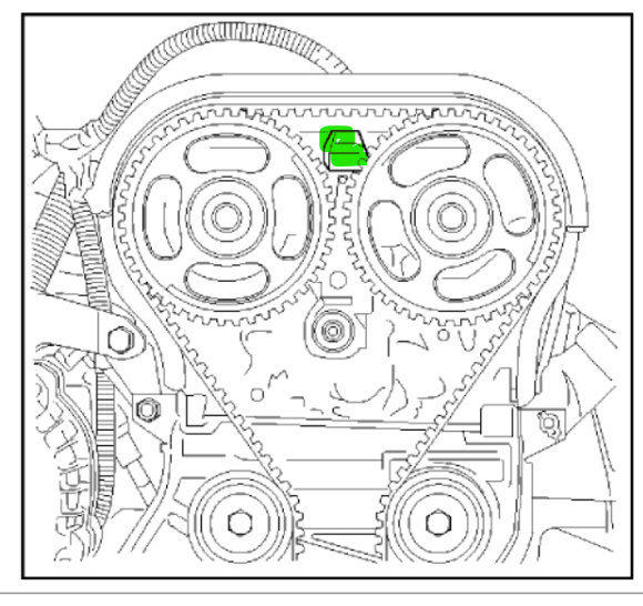

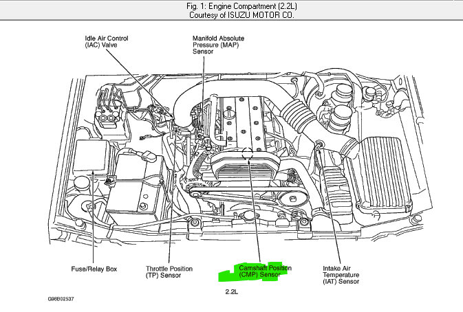

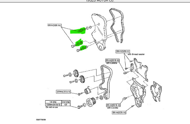

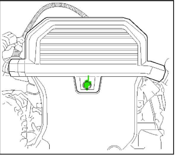

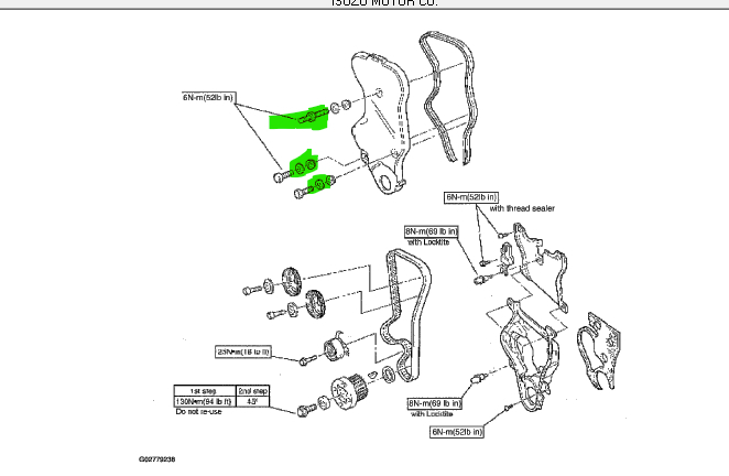

Where is the cam position sensor on my vehicle? It has no air conditioner and no power windows. I have looked it up with other questions and pictures but there is a cover I do not know how to remove. Thank you.
Friday, January 29th, 2021 AT 11:11 AM (Merged)
SEVAG P
  • 405 POSTS
camshaft sensor located on the top center front of the cylinder head, check picture below,
to replace the sensor you must remove the upper timing cover, which the screws are colored in the diagrams below.
Let us know if you need more help.
