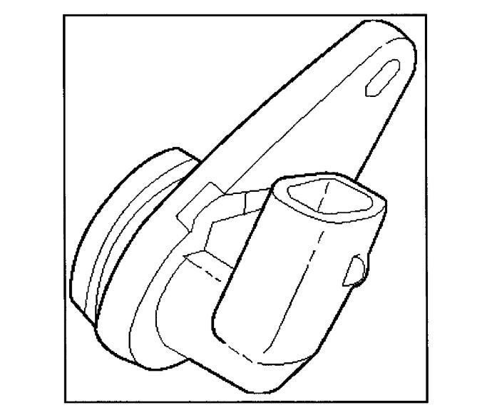

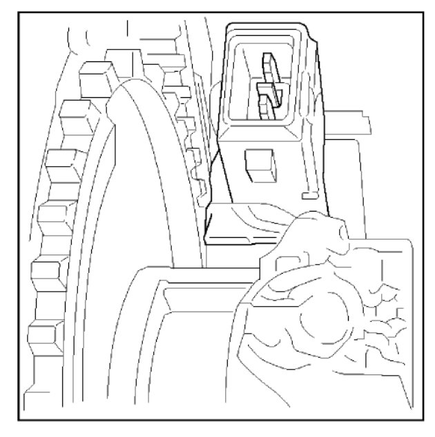

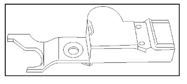

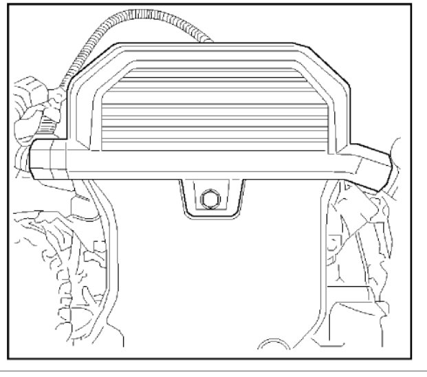

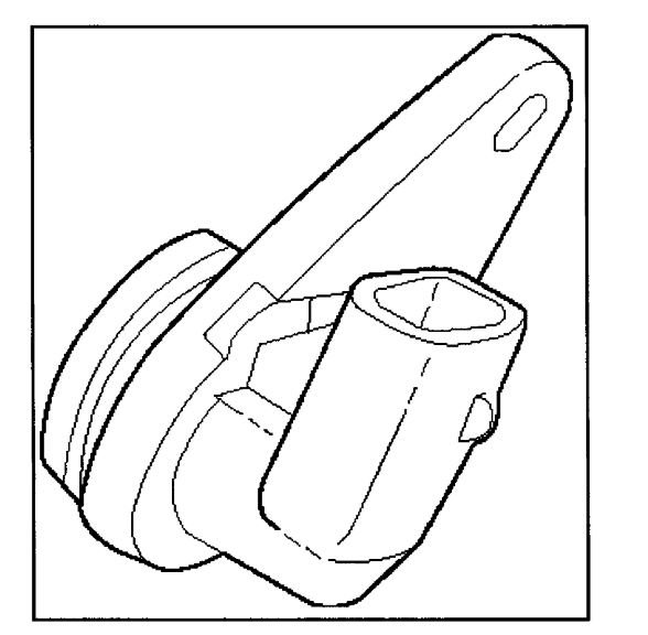

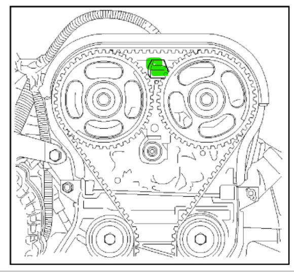

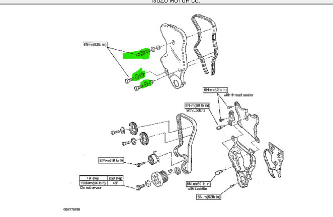

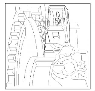

REMOVAL PROCEDURE Disconnect the negative battery cable. Remove spark plug cover on top of valve cover by removing four retaining bolts.
https://images.2carpros.com/forum/automotive_pictures/12900_c1_11.gif
Disconnect electrical connector from the sensor. Remove drive belt. Refer to Engine Mechanical Section. Remove top harness cover installed on timing belt cover by removing a retaining screw. Remove the retaining bolts holding crankshaft pulley, and pull crankshaft pulley while wiggling. Refer to Engine Mechanical Section.
https://images.2carpros.com/forum/automotive_pictures/12900_c2_40.jpg

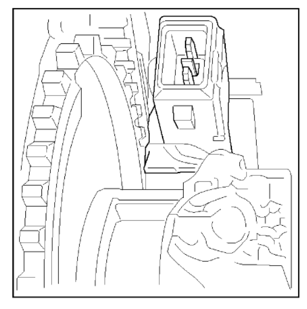

Remove the retaining screws for timing belt cover.
https://images.2carpros.com/forum/automotive_pictures/12900_c3_16.jpg
Remove the retaining bolt for the sensor and pull up camshaft position sensor. INSTALLATION PROCEDURE Insert camshaft position sensor in position.
https://images.2carpros.com/forum/automotive_pictures/12900_c4_6.gif
Install retaining bolt. Install the timing belt cover and the retaining screws. Install the crank shaft pulley and the mounting bolts. Holes for mounting bolts are off the pitch. The pulley can be mounted only one way to install all mounting bolts. Tighten the bolts. Refer to Engine Mechanical section.
Install the drive belt. Refer to Engine Mechanical Section. Install the top harness cover onto timing belt cover. Connect electrical connector to the sensor and securely lock it. Install the spark plug cover.
Connect the negative battery cable. https://www.2carpros.com/kpages/auto_repair_manuals_alldata.htm

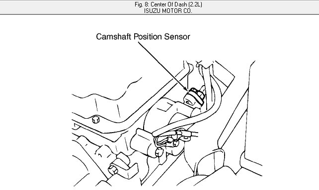

HIINTHESKY

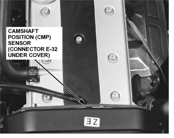

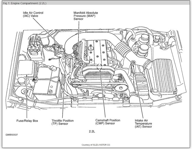

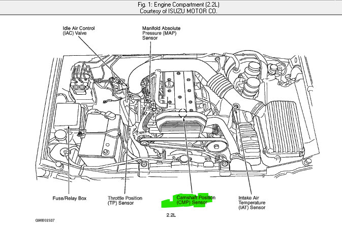

Where is the cam sensor located and what do I have to remove to get to it
Jan 25, 2021 at 11:27 AM (Merged)
CJ MEDEVAC
  • 11,004 POSTS
HERE'S A PIC OF THE LOCATION

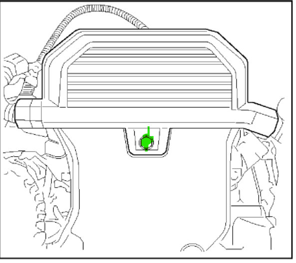

how do I change the camshaft position sensor? I dont know where is located and how to change ir. I already have the new sensor Where is the cam position sensor on my vehicle? It has no air conditioner and no power windows. I have looked it up with other questions and pictures but there is a cover I do not know how to remove. Thank you.
Can you help me step by step.... I love this site
Jan 29, 2021 at 3:09 AM (Merged)

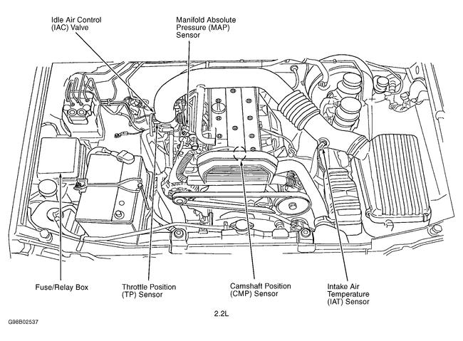

DOCFIXIT
  • 18,828 POSTS
The camshaft position sensor is located under the front camshaft cover. Here is a guide that will show you what you are in for when doing the job and diagrams (Below) to show you how to do the job on your car I have included both 4 and 6 cylinder engines.
https://www.2carpros.com/articles/camshaft-angle-sensor-replacement

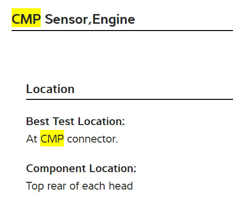

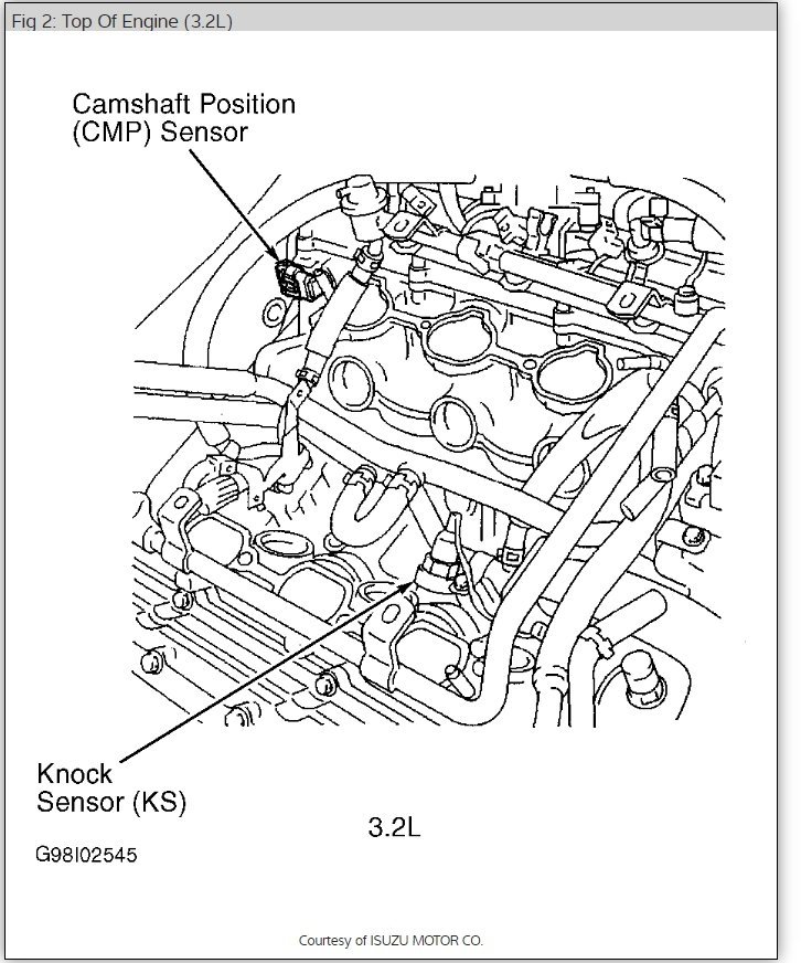

JO ANNE TILLMAN

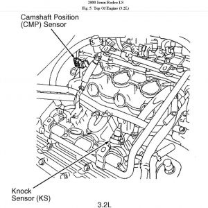

I cannot find the location of the camshaft sensor. Please help
Jan 29, 2021 at 3:10 AM (Merged)

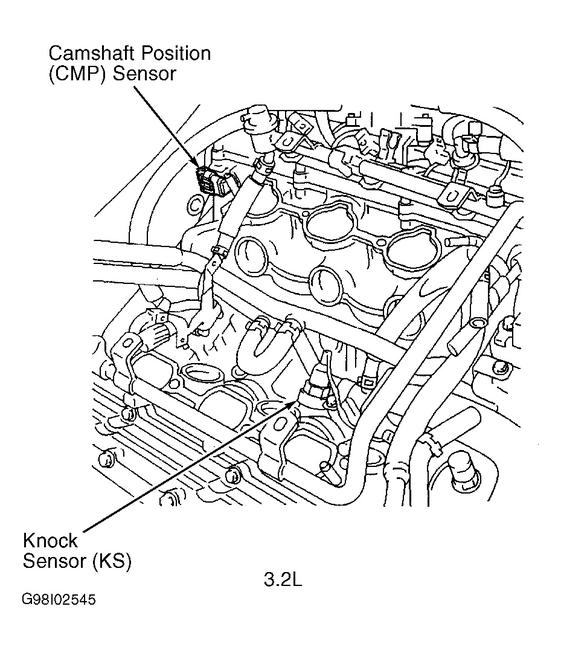

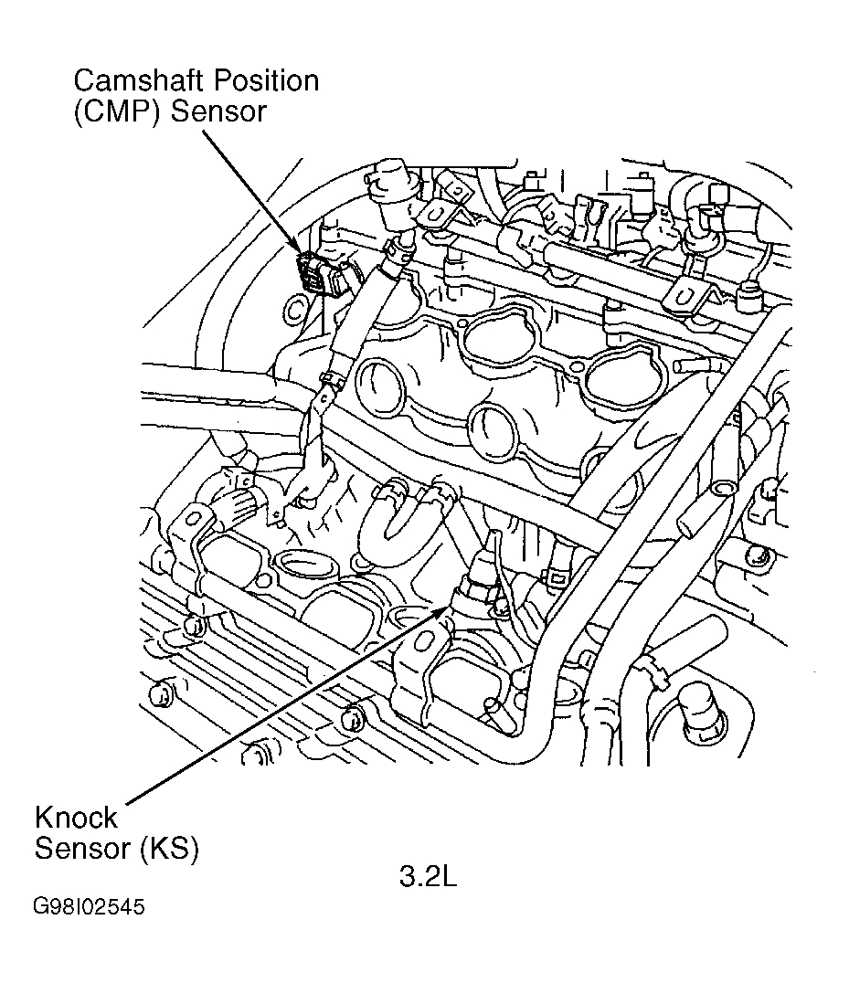

Good evening.
It is at the rear of the engine on the left cylinder head.
CMP is located Left Rear cylinder head. When the Hall-effect switch is activated, it grounds the signal line to the PCM, pulling the camshaft position sensor signal circuit's applied voltage low. This is a CMP signal. The CMP signals is created as piston # 1 is approximately 25 ° after top dead counter on the power stroke. If the correct CMP signal is not received by the PCM, DTC P0341 will be set.

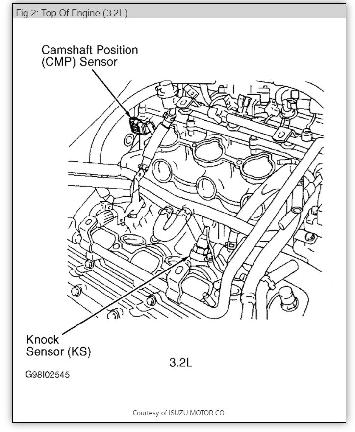

TOM1967
hi im working on a 2001 isuzu rodeo 3.2l and cant find the where the cam sensor is located,the repair manual shows it on the front of the timing belt cover but its not there. please help
STEVE W.
  • 15,239 POSTS
It's hidden under the intake manifold on the top side of the left hand cylinder head in the back of the engine. It's possible to remove it without removing the intake but it's a tight fit.
USER NOTES: Not on the passport. you have to remove the intake to get to it. you can barely see the cps

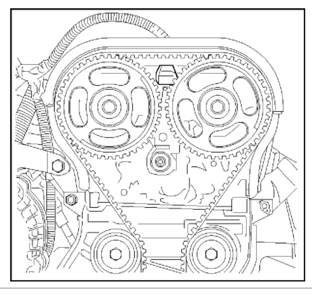

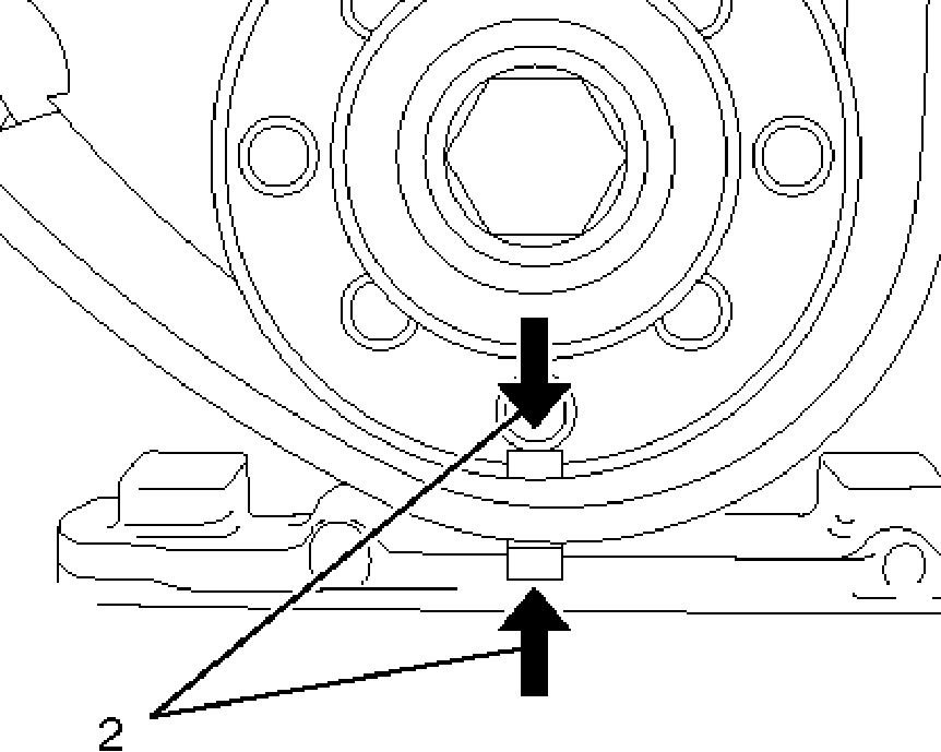

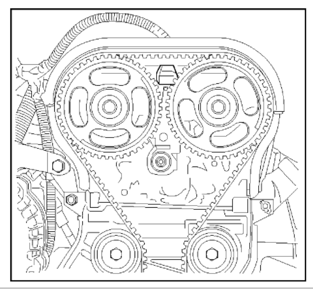

GNOMONEY57
  • 5 POSTS

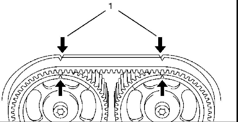

I parked the car on level ground took the camshaft position sensor out put the new camshaft position sensor. now the car runs rough and sounds like it's coming apart.
STEVE W.
  • 15,239 POSTS
What was the reason for changing the cam sensor? The most common reason replacement could cause problems would be if the cam timing was changed while the sensor was being changed. To check that you would remove the timing belt cover and check the alignment marks as shown in the images. If they line up then it is in time and not the issue, if they don't then the timing is off and needs to be corrected. Hopefully there is no lasting damage as the timing being off could cause the pistons to hit the valves and that would cause at a minimum needing a vale job, or a replacement cylinder head.

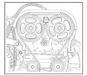

GNOMONEY57
  • 5 POSTS
Check engine light came on OBD2 said cam position sensor. do you have to time it before you put the sensor in? I don't think I moved anything.
4DRTOM
  • 467 POSTS
So the car was running fine just the light came on so you changed the sensor from the code it showed? I would double check the installation and make sure the sensor seated properly and the plug too. The belt itself should not have moved unless something like the tensioner failed and the belt jumped a tooth. Checking the marks that Steve mentioned is a good idea just in case. What was the actual code number so we can verify that was the correct and only thing that the code means.
Tom
GNOMONEY57
  • 5 POSTS
How do you not remember the code? but I'm going to reset the timing and go from there. thank you
STEVE W.
  • 15,239 POSTS
That would be the place to start. Let us know what you find out.
GNOMONEY57
  • 5 POSTS
Okay, I will.
GNOMONEY57
  • 5 POSTS
Put it back in time everything works fine. thanks for y'all help.

CHEFO3000
I replaced my head gasket and I can’t seem to find where to plug in my cam position sensor.

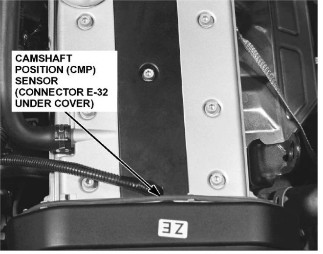

Good afternoon,
The sensor is on the left rear cylinder head. I attached a picture and the location for the sensor.

  • 6 POSTS
My engine light is on and the OBDII code is the cam position sensor. I have the picture as to where it is located but I do not know how to get the final black cover off to get to it. I have had the engine light coming on for over eight years and have always managed to do different things to get it to stay off and have it smogged; such as having the gas tank half full, making sure the gas cap is completely turned at least five times, etc. but this time it will not stay off. The smog man read the code on his scanner as well as a friend of mine's scanner and it says the cam position sensor. I believe it is just totally dirty so the contact points are bad but I will replace it if I can know how to do this. Please help and thank you.
  • 55,065 POSTS
It looks like the camshaft position sensor is located near the top of the engine. Here is a guide and a diagram (below) that will help you get the job done.

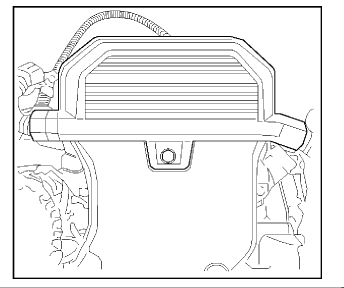

SEVAG P
  • 405 POSTS
hello,
camshaft sensor located on the top center front of the cylinder head, check picture below,
to replace the sensor you must remove the upper timing cover, which the screws are colored in the diagrams below.
let us know if you need more help.
thank you.

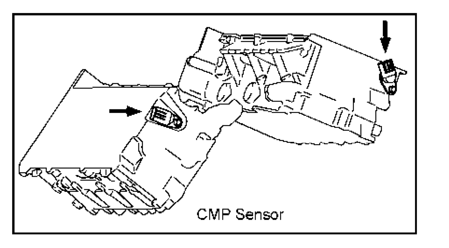

MAINTENANCERUS
Hi i have a isuzu rodeo 2000 v6 3.2l,i need replace the camshaft sensor but i can't find where it is located,please can you help me.
thanks
Jan 29, 2021 at 3:11 AM (Merged)
KHLOW2008
  • 41,814 POSTS
Hi Maintenancerus, The camshaft position sensor is in the side of left cylinder head
https://images.2carpros.com/forum/automotive_pictures/192750_CMPSensor00Rodeo_1.jpg
MAINTENANCERUS
the one i find where u send is the interruptor camshaft sensor
BLUELIGHTNIN6
  • 16,542 POSTS
your vehicle only has one camshaft position sensor and it is in the exact location that was posted previously . there is no interruptor cam sensor..
