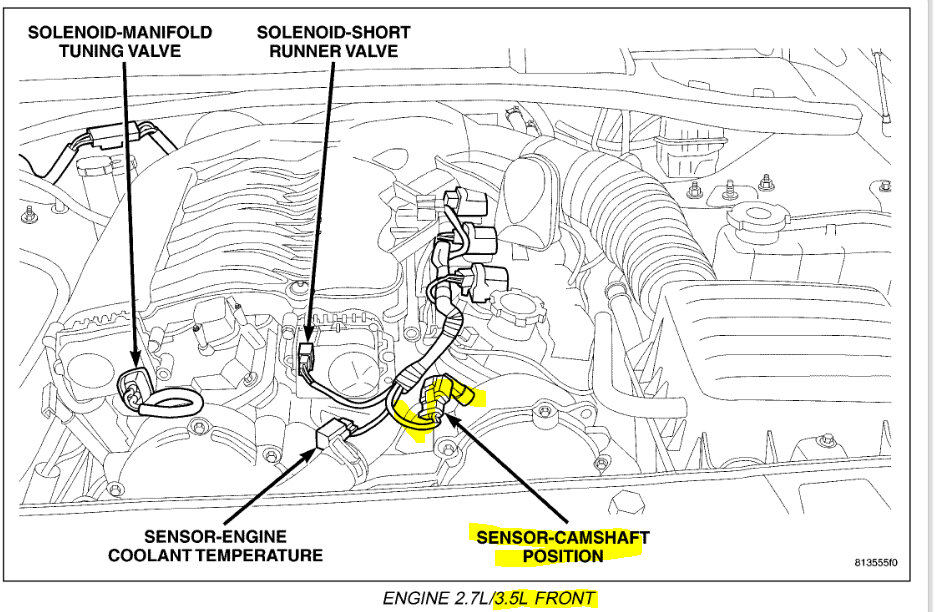

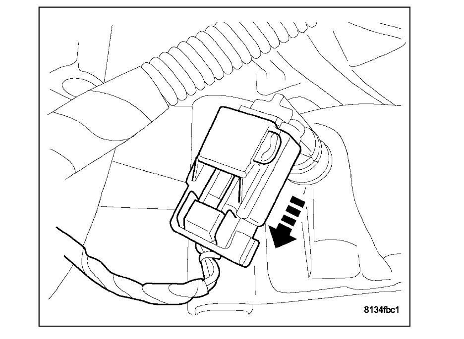

Need to know where the camshaft position sensor is located.
Feb 5, 2020 at 9:13 PM
TOUGHDIVER
  • 226 POSTS

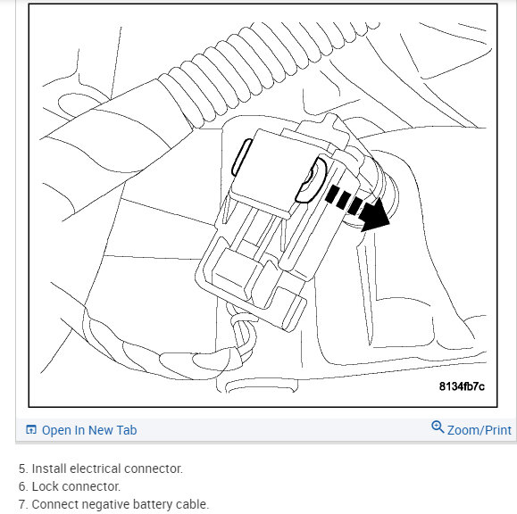

I attach a schematic below for the location of the position the camshaft sensor. Let us if this is helpful and if you more assistant.
Thanks
Joe T.

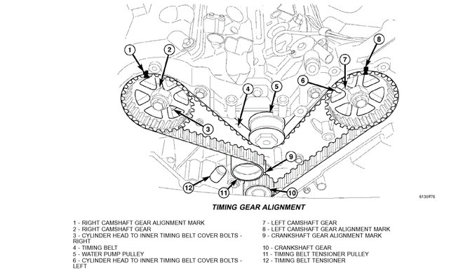

Thanks for the information guy. helping my sister it on a timing belt and replace timing system and the crankshaft and camshaft position sensor, but still no cranking up! It's turning over but cranking. Can you please give me insight on what else need to be done? Thanks a lot.

This is a different Joe. I noted that you replaced the timing belt and both sensors. I don't know what all has been checked, so bear with me. Are you getting spark to the plugs? Here is a link that explains how to check:
If you are getting spark, see if it will start for a couple seconds using starting fluid. If it does and then stalls, it is fuel related. Here is a link explaining how to check pressure in general:
Here are the manufacturer's specs for pressure:

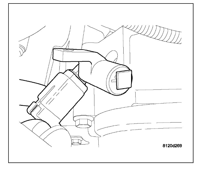

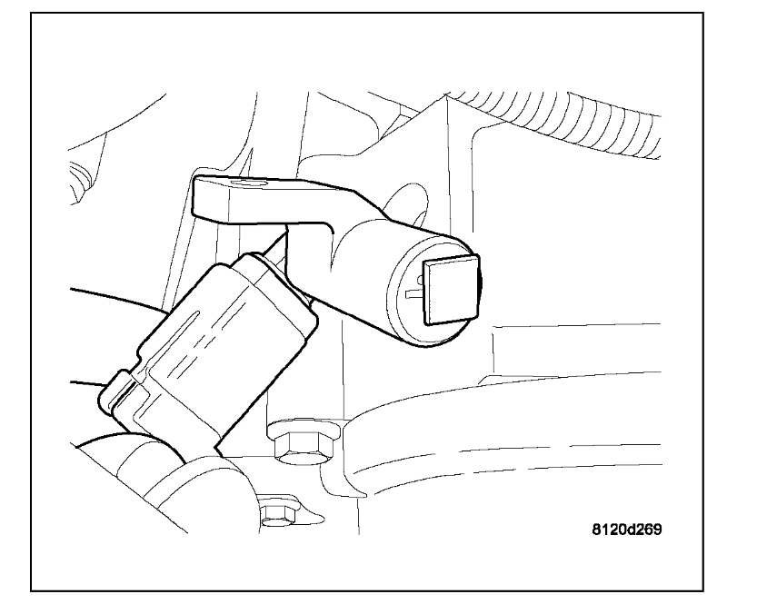

If you have both spark and fuel, are you certain the timing was correct before replacing everything? I attached a pic indicating all the timing marks. Check to confirm.
_____________
Let us know if this helps and what you find.

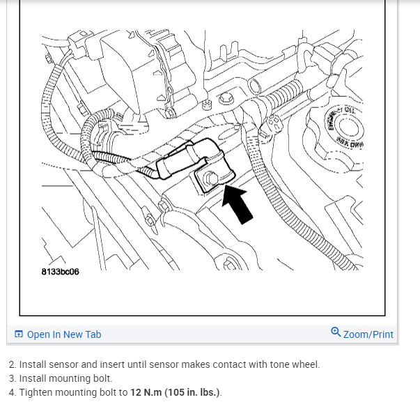

Where is sensor A Bank 1 located?
Nov 25, 2022 at 5:16 AM
  • 110,240 POSTS

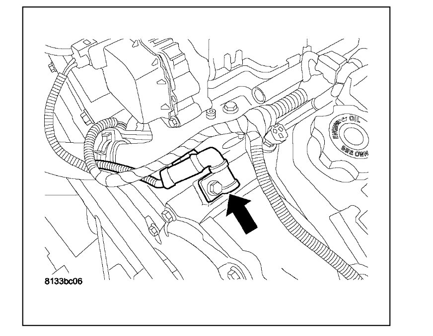

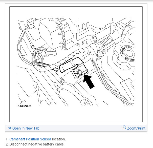

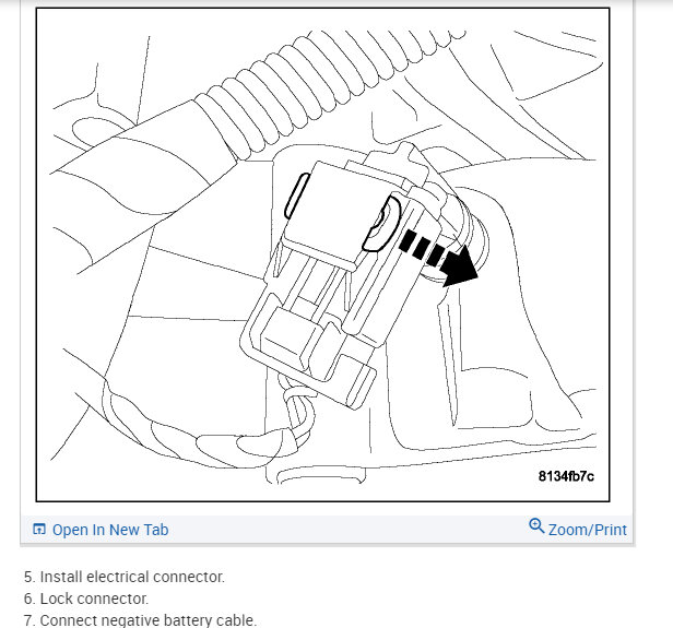

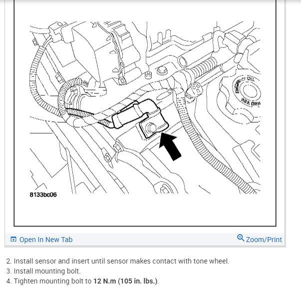

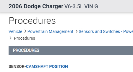

Chris, I noticed he didn't get back to you. I believe this only has one cam position sensor. I attached the pic below showing its location.
If there is a specific diagnostic trouble code you have, let me know what it is.

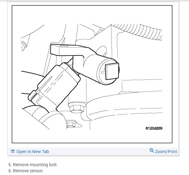

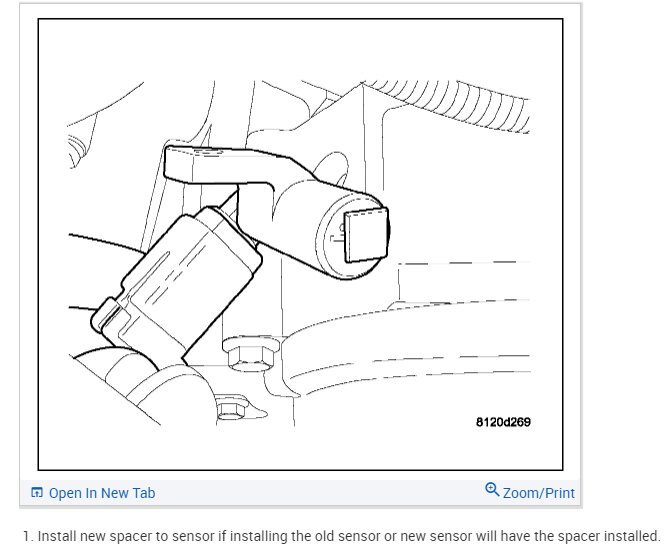

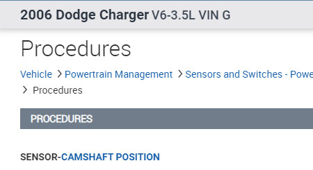

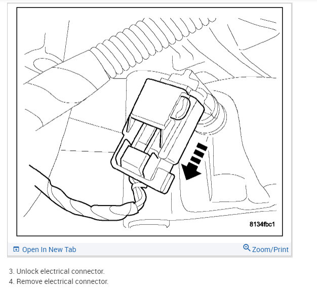

Take care and let me know if this helps. Also, starting with pic 2 are the directions for replacing the cam sensor.
See pic below.
