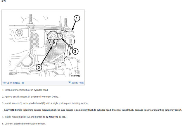

The camshaft sensor went out in November. I had it replaced. It went out again this morning, after I made a sharp turn. The tech said that it looked as if something had hit it. I want to do the job myself this time.

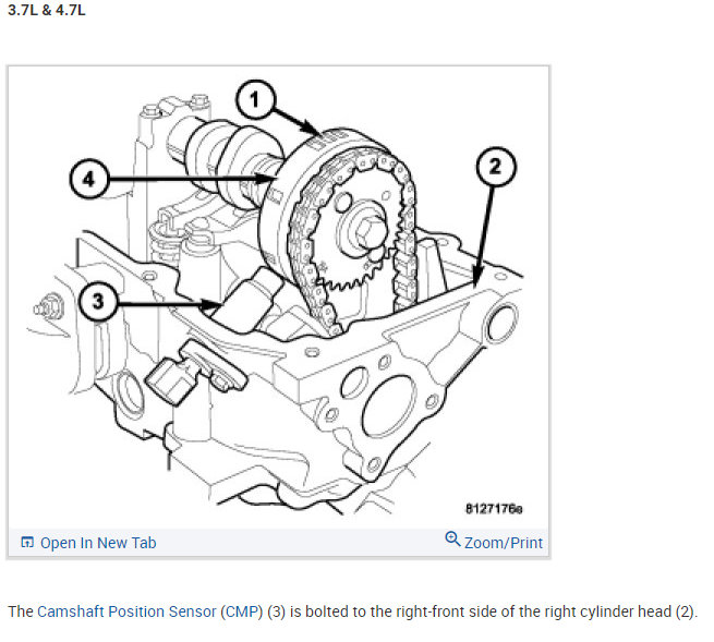

Below are some diagrams with the instructions attached. I hope this helps with your repair.
https://www.2carpros.com/articles/camshaft-angle-sensor-replacement

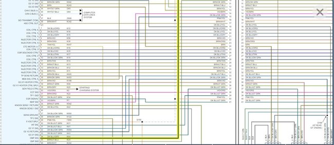

PETEDAIGS
  • 5 POSTS
My gas pedal went dead while driving down the highway. The engine stayed running for a few minutes at an idle then completely stalled. The check engine light and the lightning bolt came on when the gas pedal . I put the code reader on and it gave me P0340 camshaft position sensor A circuit (bank 1 or single sensor) code. I changed the camshaft position sensor on the passenger side which I think is bank 2. Is there 2 camshaft sensors? One for each side. My truck is on the highway so any help would be appreciated. Thanks

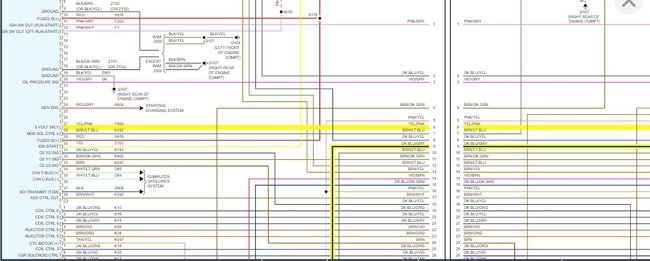

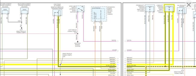

Good evening,
This code is usually a wiring issue with a 5 volt reference voltage not present at the sensor.
Do you have a meter to check the voltage?

  • 52,797 POSTS
Okay, I told you there was only one sensor. They need to check the voltage to the sensor and the ECM to be sure it is not a wiring issue.

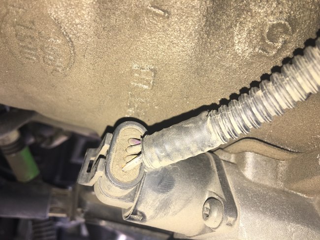

Broke off inside block and I cannot find where it went. Looks like it fell in a void. Would it be alright to put a new one in and leave the missing part where ever it may be? Any help would be really great.
Monday, March 1st, 2021 AT 11:39 AM (Merged)
  • 109,983 POSTS
Hi and thanks for using 2CarPros. Com. No, it is not a good idea. If the broken part is lost in the engine, it will caused other damage. Please let me know what engine is in this truck so I can provide directions and pictures for taking things apart to find the broken part.

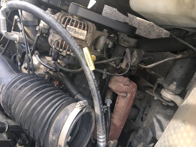

2381MJ
  • 5 POSTS
  • 2003 DODGE RAM
  • 5.9L
  • V8
  • 2WD
  • 150,000 MILES
Truck has code P0340 camshaft position sensor A circuit Bank 1 or single sensor.
I cannot find the location of camshaft position sensor on truck. Any ideas?

Hi 238MJ,
Here is the location for the camshaft and crankshaft sensors Please let me know if you need anything else and I will be happy to assist. Check out the diagrams (Below). Please let us know if you need anything else to get the problem fixed. Thanks

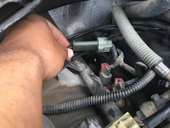

Do I see spark plug wires? This is a gas engine 5.9L not diesel. No wonder you can't find it with what I provided.
Your description just said 2003 Ram Truck 5.9L. I didn't pick up on the V8. Just assumed it was a diesel. Sorry for the confusion.
It should be on the driver side of the intake, towards the rear of the engine under the fuel rail just next to the distributor. Take a look at these drawings.

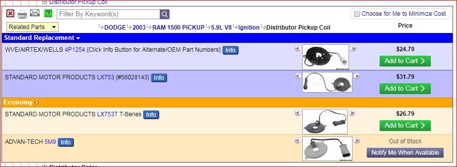

Can you send me a picture of what the sensor looks like or part to get for replacement?
-1
Monday, March 1st, 2021 AT 11:40 AM (Merged)
My apologies. I looked up the location for the connector. Here are the instructions to remove the actual sensor. It is part of the distributor.
The aftermarket may call it a Pickup Coil.
Please see the attached documents.
