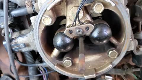

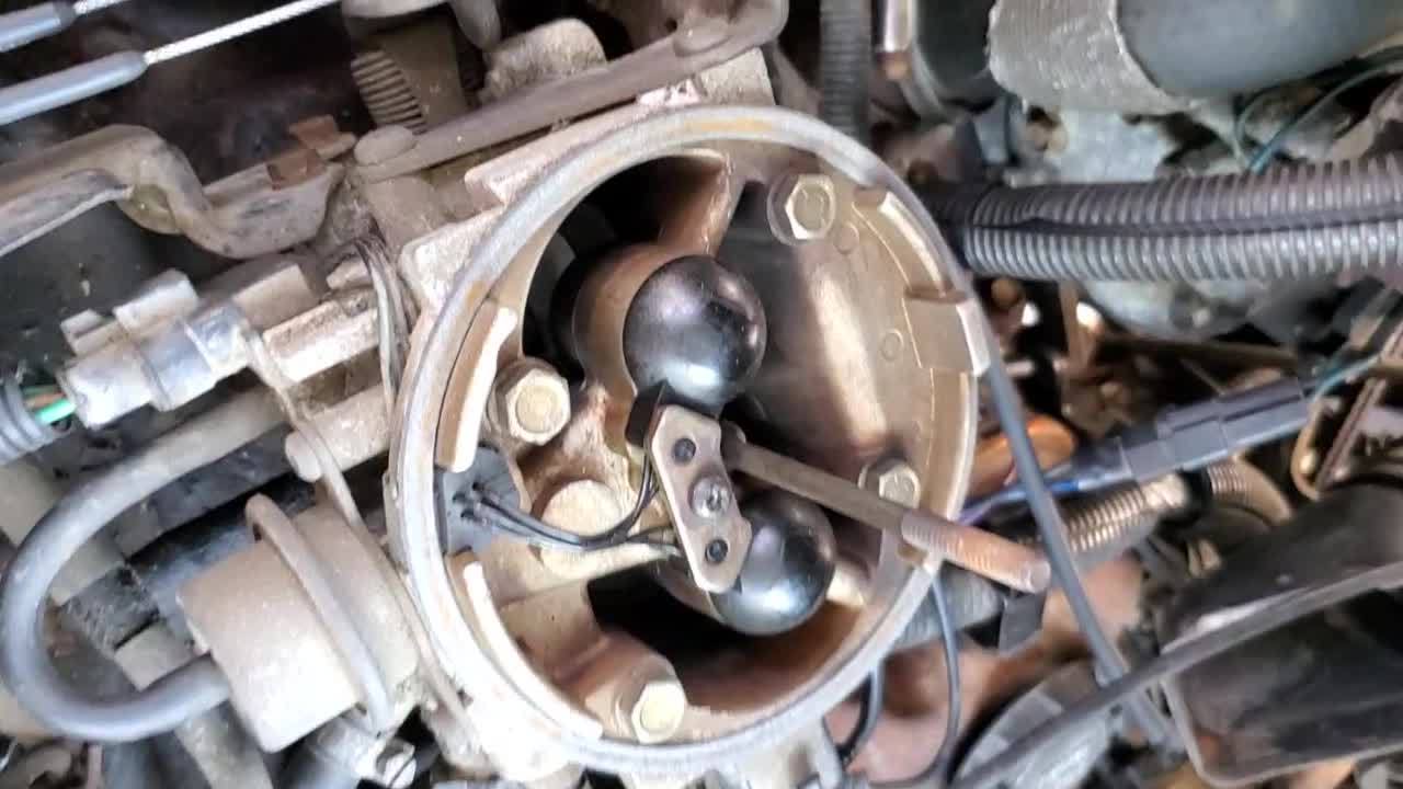

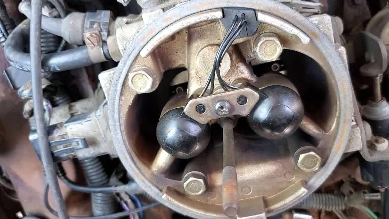

forgot to mention that when the van stalls and i attempt to re-start it immediately, I get a puff of white smoke in the throat of the carburetor (filter/cover removed) that fills up the van... if i wait until it all clears out of the carb, the van starts again.
i have fuel/pressure, i have spark, and the van runs great with power once i get it started.
Jul 8, 2022 at 12:23 AM
  • 55,433 POSTS
You may have a needle and seat that has something stuck in it causing the engine to flood, use a flashlight and after you shut off the engine look down the carb to see if there is gas pouring into the engine.

Hi Ken,

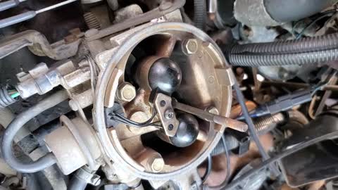

Made two videos, first while the engine ran perfectly. As i mentioned, there is a little difficulty to start when the engine is cold usually.
Then I shut it off and tried to restart, could not restart it. frustrating!
Looking down at the throat of the carburetor and yes wet.
Any write up on servicing the carb? I have tools and half a brain!

2 videos attached.

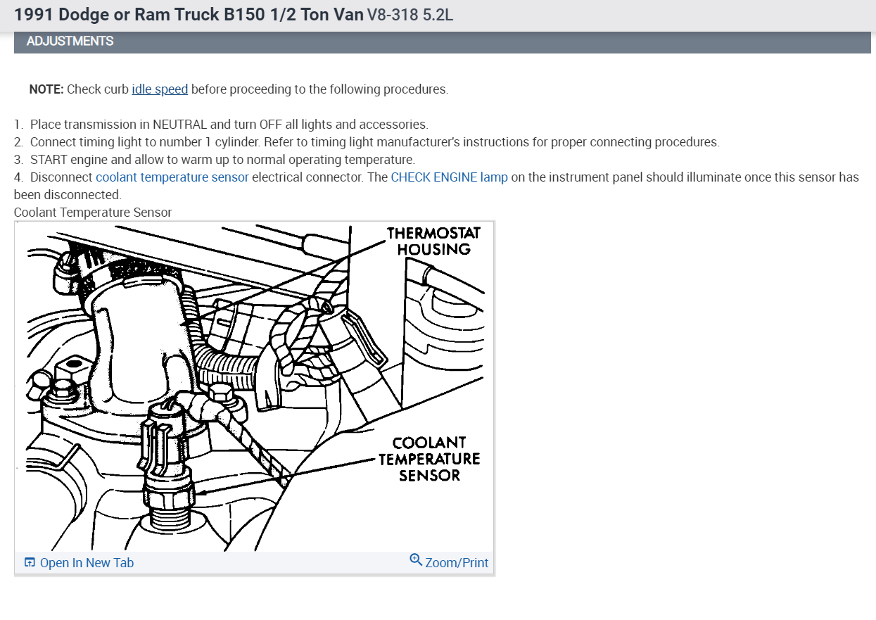

Yep, it seems like the gas filter is plugged or the fuel pump is weak, but you said you replaced that correct? Have we run the codes yet? This guide can help us:
https://www.2carpros.com/articles/retrieve-trouble-codes-for-chrysler-dodge-plymouth-odb1-1995-and-earlier-car-mini-van-and-light-trucks

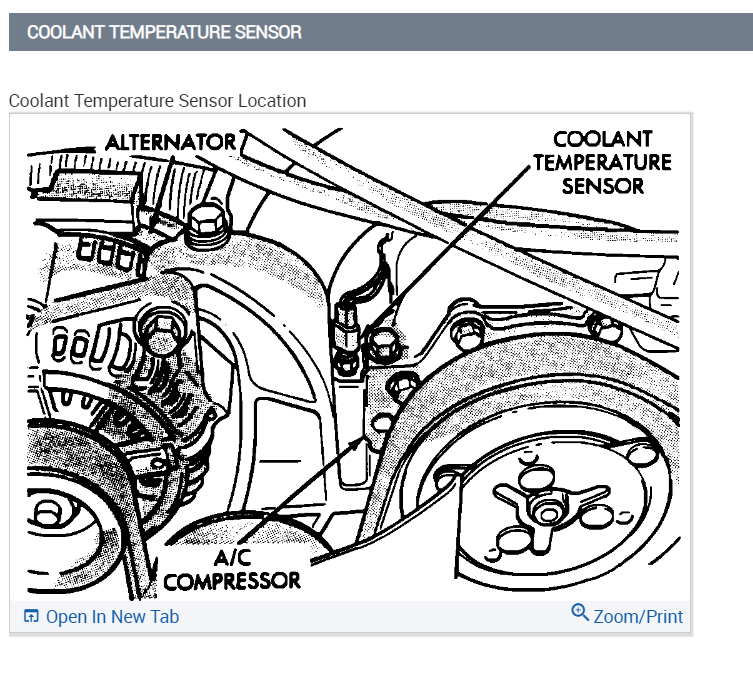

The engine sounds okay when you are cranking it so I think the timing chain is okay. I feel like it could be the engine coolant temperature sensor shorting out, try to unplug it to see if the engine acts differently. Here is the location in the diagrams below. Please let us know what you find.

I was thinking and I have seen the engine coolant temperature sensor cause this issue, did you unplug the sensor and see if the problem changes? I would install a new sensor. You could have gotten a bad sensor.

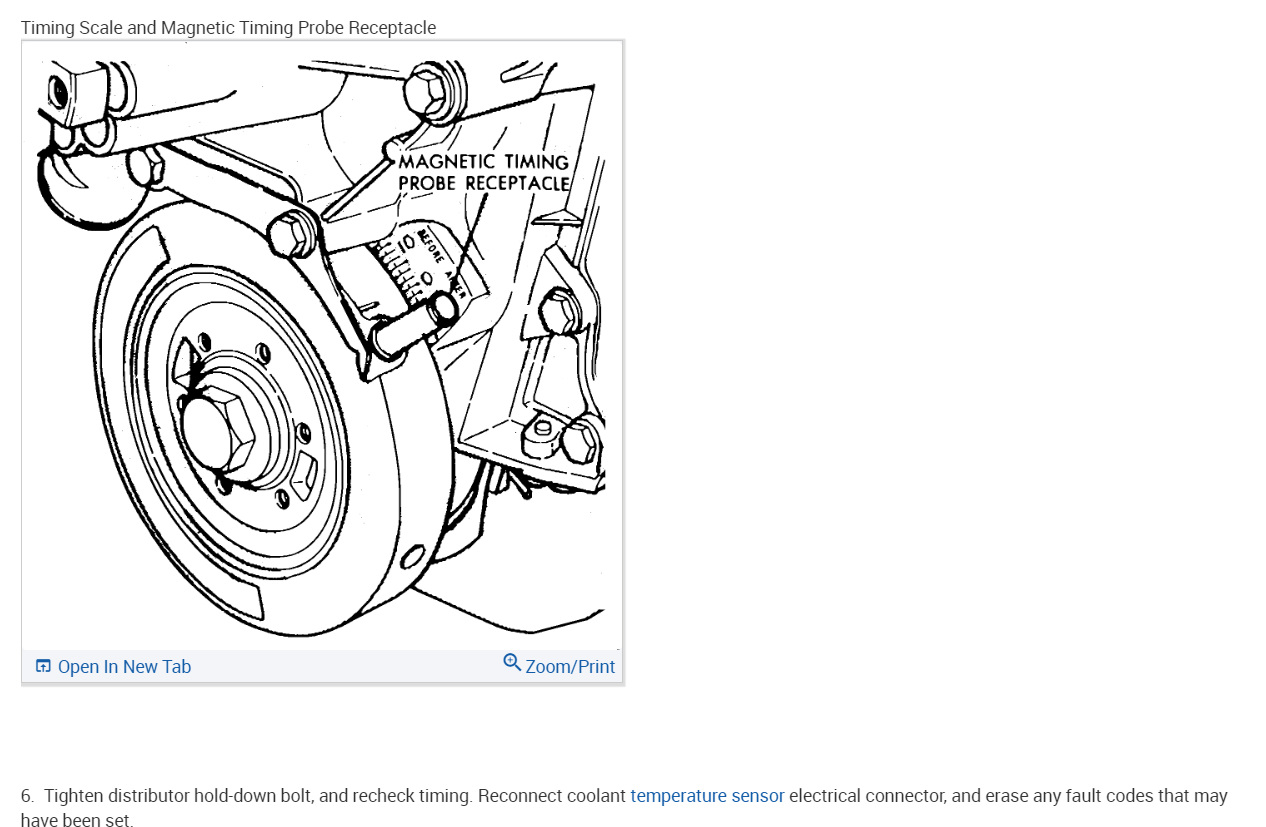

Hi Ken,

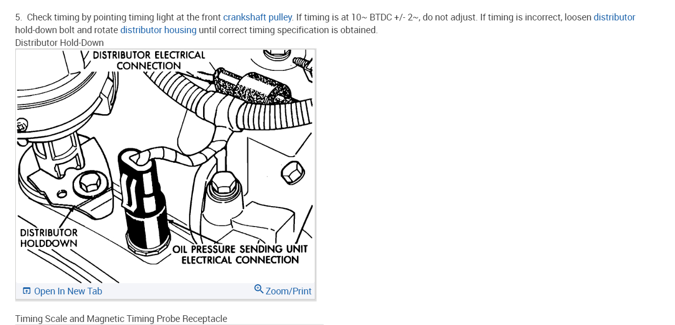

As promised, I wanted to give an update on the van. I've been driving it around town the last few days and it has been solid, starts, runs and feels great. The only thing is that I may have advanced the timing slightly a bit during diags.. I thought I marked it and put it back to where it was but it may have been off. Is there a good how-to do the timing accurately on it? I do have a timing gun but can't find any markings on the pulleys... and I looked for it from every angle.
Thank you again for helping me fix my van! I am a happy camper! I plan to drive it down to North Carolina this weekend.
Jul 18, 2022 at 3:44 AM
  • 55,433 POSTS
Sure, here are the instructions and timing plate in the diagrams below.
