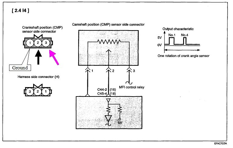

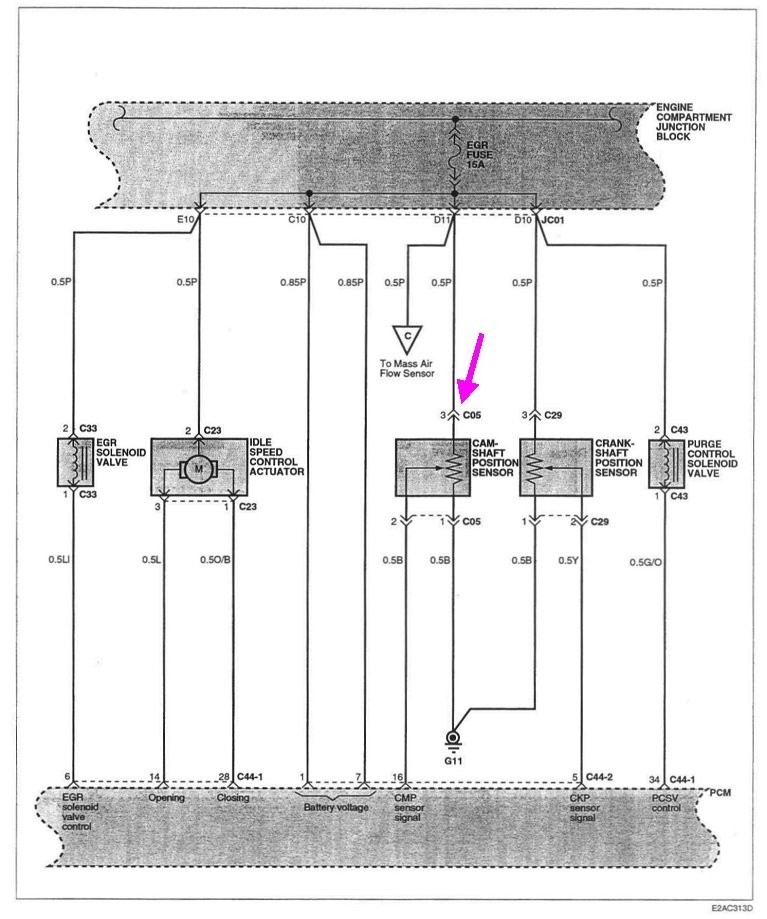

The pigtail (electrical connector) that connects to the camshaft sensor was broken and all messed up. So I changed the camshaft sensor, got a new pigtail but have no idea how I'm supposed to connect the wires.
Feb 5, 2020 at 5:28 AM
CARADIODOC
  • 34,369 POSTS
The signal wire and ground wire are both black. You'll need to use an ohm meter to see which is the ground wire so you don't mix them up. Put the ground wire in terminal "1".

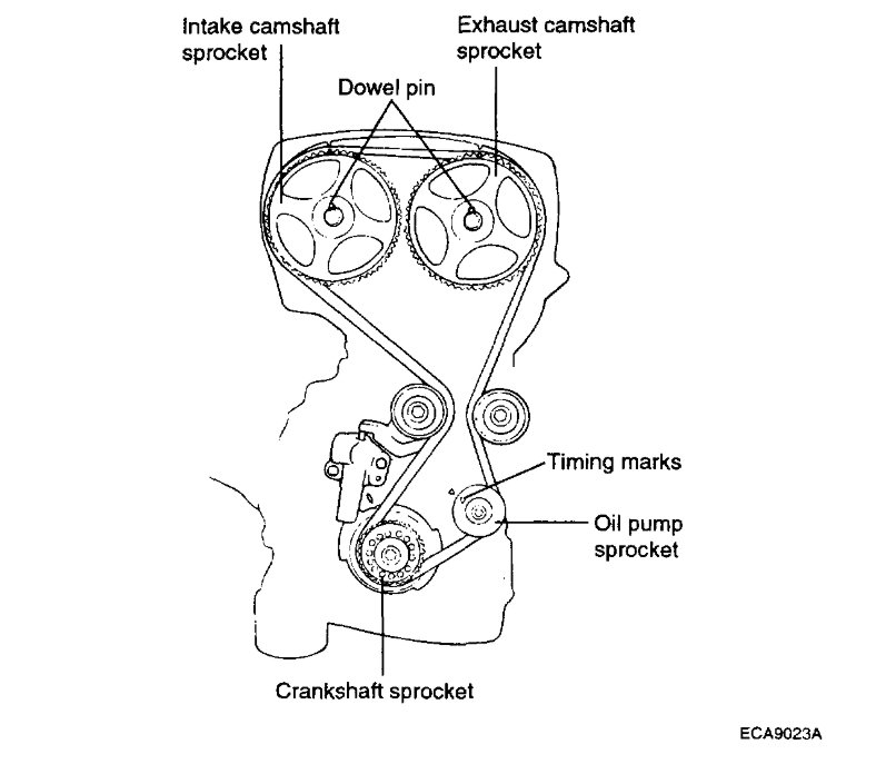

I noticed you said the crankshaft sensor was changed. The crankshaft sensor is located under the timing belt and the belt would've been removed for this job. You said now when you try to start the vehicle it tries but stumbles but won't start. It sounds like the engine is out of time 2-3 teeth or more on the belt this will cause it to stumble when starting. Recheck the timing I'm attaching a schematic of the timing marks below. Please let us know if this was the issue or if you need more info.
https://www.2carpros.com/articles/how-a-timing-belt-works
Thank you
Joe T.
