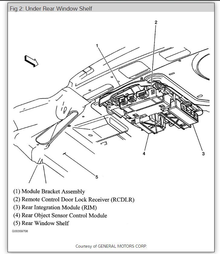

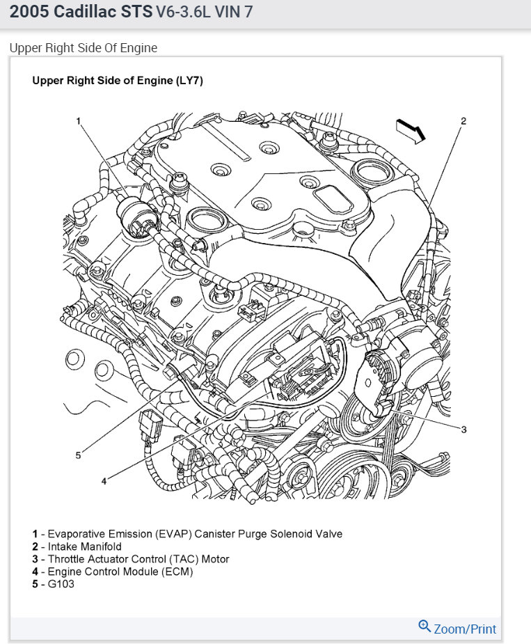

Not yet, we keep pointing toward the BCM but nobody has responded. I would like to remove the electrical connectors from the BCM and PCM to check for corrosion and it could fix a connection problem was well. The BCM is the rear interrogation module in this car.
Here are the locations. Check out the diagrams (below). Please let us know what happens.

Well, I got a scanner and it is reading the code U0100. Those pictures are no help as mine is a 4.6L v8. I am leaning towards buying a new ECM and having it programmed to my car. Does that sound right?
