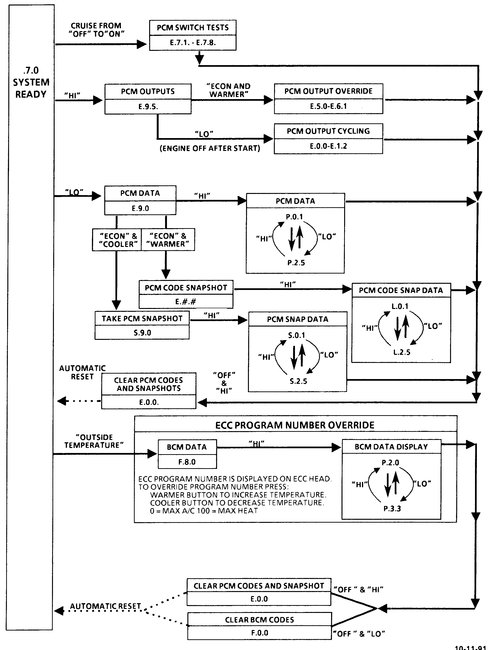

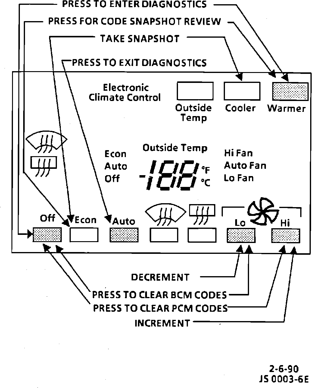

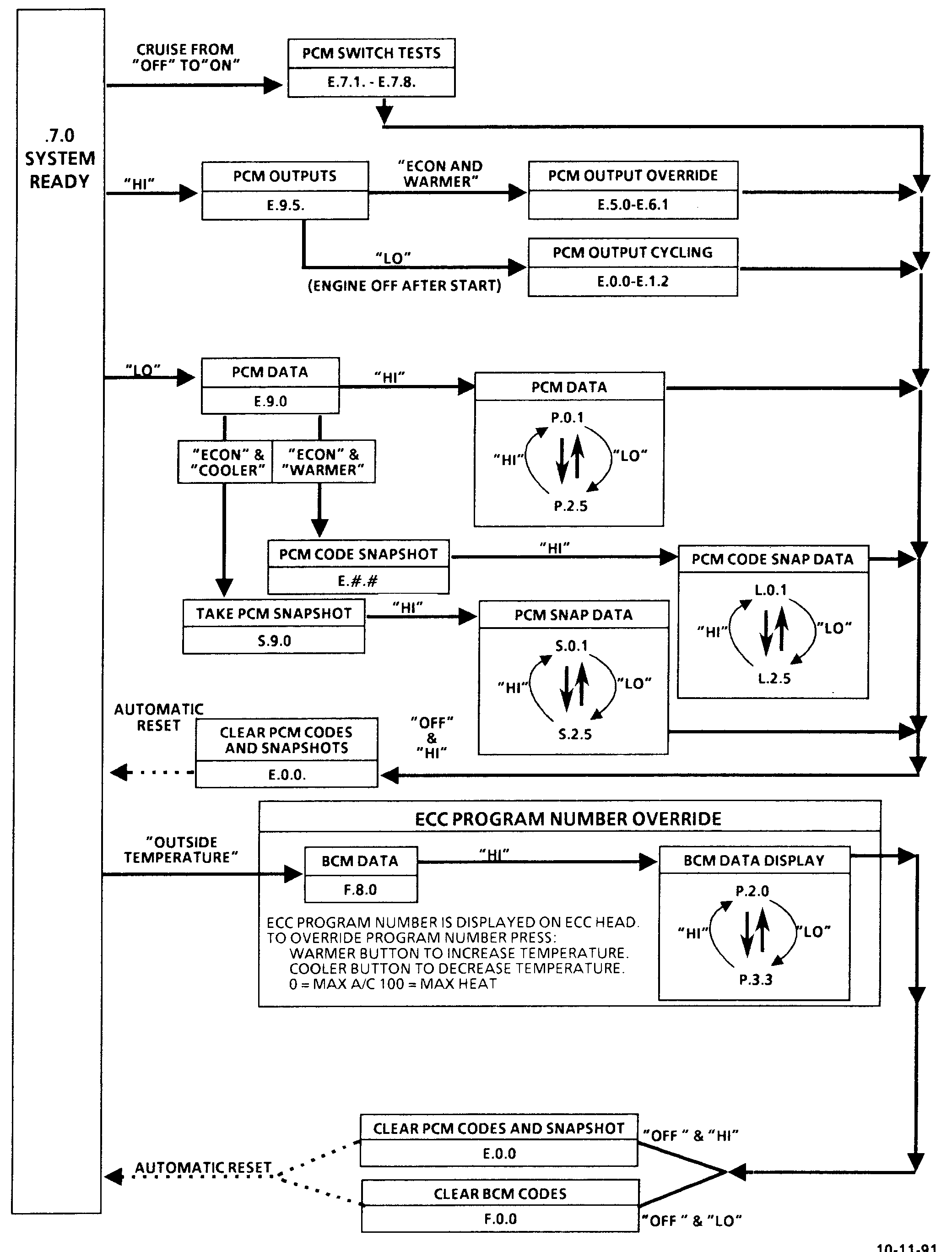

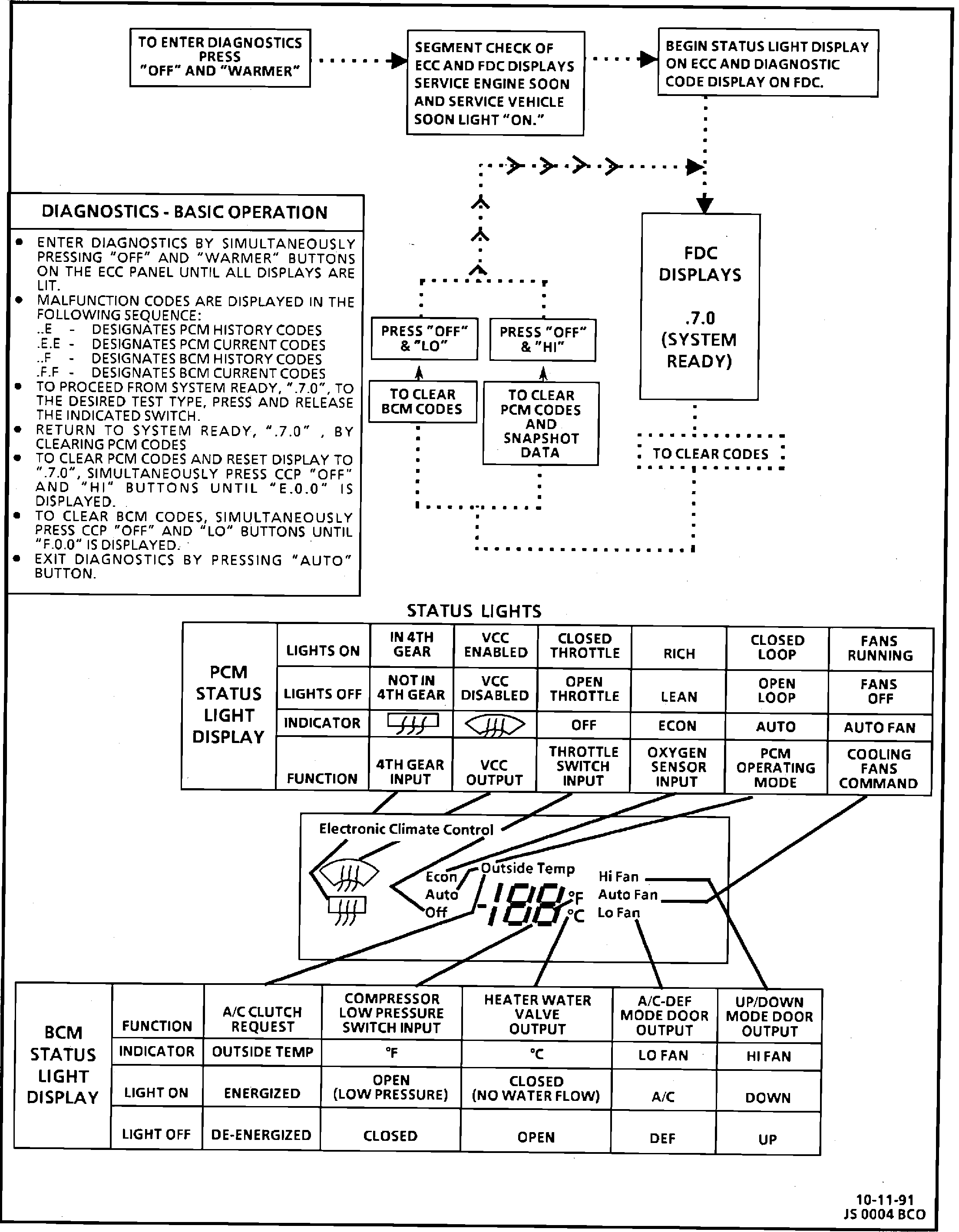

Is the service engine soon light on? You may want to check for trouble codes whether it is on or not. See images below. Basically on the climate control unit you are going to press the off and warmer buttons at the same time to enter diagnostic mode and read codes. If you get codes please post them on here please.
