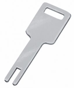

If it ran fine then the next day it ran like crap, did you get gas? Test pump pressure and read any codes, read them this way and post results.
Cross these two terminals as shown, then turn the key on. Count the flashes, a 22 will flash as 2 flashes then a short pause, then 2 flashes, if more than one code is stored, the pause will be longer. The codes will display three times and end with 12. Write them down and post here. This connector is right under the middle of the dash...
https://www.2carpros.com/forum/automotive_pictures/62217_GM_DLC95_Older_21.jpg
https://www.2carpros.com/forum/automotive_pictures/62217_GM_Jumper_Key_3.jpg
Also check ALL fuses in car and under the hood.

I ran a jumper wire as in diagram and the system give me nothing but the fuel level and trip usage, no flashes or 22.
The only code that come up are the one listed below:
E9.5
E00
E96
E01
E12
F00
I have ran a pressure check on the fuel it is reading 42 on prime start up and dropping to 38 while running. Thought maybe bad gas, so filled it up and no change. Shop told me that when they ran diagonistic that the Emc was bad, and that only communicating with half of the injectors. I am about ready to just give up and start looking for a different car. Any thing else thanks.
