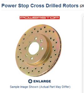

I've put crossed drilled rotors on all 4 wheels last winter and now 7/26/10 the mechanic says they maybe the cause of my shimmy problems. He does'nt know if he can cut these rotors. My Q is, can they? or they trying to force me into buying new rotors? Is this normal lifetime for rotors. i love the crossed drilled, especillay in the rain and snow, here in PA. They bring my 2 ton Caddy to stop in a hurry. i don't ride my breaks at all, i'll drift to a stop before I use them...but, when i'm on the highway, i have to watch out for city drivers and Sunday drivers. stopping from 70 to 40 mph is verrrry important to me.

Hi thunder. Welcome to the forum. The holes in the rotors have no affect on how they're machined. They don't improve stopping directly either. There is less surface contact area, but the difference is negligible. What they do is improve cooling which reduces gasing of the friction linings which reduces one type of brake fade. Mountain driving is where you'll really notice the difference.
As for the shimmy, when does it occur? All the time or just when braking? Does it shake the steering wheel or do you just feel it in the seat? It is real common for new rotors to warp and once they're machined, they generally don't warp again. This is especially true of Chinese rotors. There's nothing wrong with them except cast iron parts made here are "aged" for 90 days before the final machining. Chinese rotors are cast, packaged, and shipped. The aging takes place on your car.
If the shimmy occurs all the time, have the steering and suspension components inspected by an alignment specialist. GM vehicles eat ball joints faster than most other brands. Also look for a broken belt in a tire. You will feel that at all speeds. Often you will see the steering wheel oscillate back and forth as you drive through a parking lot. Warped rotors can do the same thing if the calipers aren't sliding freely on their mounts, but usually you'll only feel that when braking.

caradiodoc, thank you for your response. I notice 3 things this morning driving to work. 1. i need a front end alignment (pulls hard to the right) 2. It get a slight shimmy when driving between 50-65 3. My right front shakes hard (and the steering wheel)when braking at these speeds, like when exiting off the highway (down grade). i inserted a pic of the rotors.
https://images.2carpros.com/forum/automotive_pictures/55386_cross_drilled_rotor_2.jpg

Absolutely. I mentioned that previously. The cutting bit skipping over the holes is no different than skipping over rust spots. Holes mean nothing to the brake lathe. The only exception would be when the rotors reach the minimum legal thickness. No mechanic will risk his professional reputation by cutting them thinner than allowed. Besides the legal ramifications, less metal means they will heat up faster.
It is also strongly advisable to machine the fattest rotor down to the same thickness as the thinner rotor. Keeping them the same thickness on each side, (within around .010" or less), means they will always be near the same temperature. Years ago with big heavy rear-wheel-drive cars, we never gave that a thought, but now with lighter cars, unequal thickness rotors often leads to a severe brake pull when the brakes get hot. It's due to the changing coefficient of friction of the linings at different temperatures.
