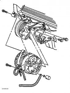

1 last thing, can you give me a step by step R&R of the alt. and belt for the water pump.

Hello - Sorry for the delay............had some minor technical difficulty. Sorry, this is the best we can do for this task. Removal 1. Disconnect the negative battery cable. CAUTION: Before servicing any electrical component, the ignition and start switch must be in the OFF or LOCK position and all electrical loads must be OFF, unless instructed otherwise in these procedures. If a tool or equipment could easily come in contact with a live exposed electrical terminal, also disconnect the negative battery cable. Failure to follow these precautions may cause personal injury and/or damage to the vehicle or its components. 2. Remove the accessory drive belt. 3. Remove the upper front bolt. 4. Raise and suitably support the vehicle. 5. Remove the front engine splash shield. 6. Remove the radiator support access panel. 7. Loosen the rear generator bracket from the engine. See Fig. 2 .
https://images.2carpros.com/forum/automotive_pictures/248015_2_127.jpg
8. Remove the top bolt. 9. Remove the front lower mounting bolt. 10. Remove the lower rear mounting bolt. 11. Remove the upper rear mounting bolt. 12. Remove the duct from the back of the generator. 13. Disconnect the following electrical connections: "¢ Regulator "¢ Battery output "¢ Heated windshield (if equipped). 14. Remove the front generator - A/C bracket. 15. Rotate the generator and remove. Installation 1. Install the generator. See Fig. 2 . 2. Install the front generator - A/C bracket. 3. Connect the following electrical connections: "¢ Regulator "¢ Battery output "¢ Heated windshield (if equipped). Tighten the battery output cable to 20 N.m (15 lb ft). 4. Install the duct to the back of the generator. Align the duct to the generator black duct. 5. Install the upper rear mounting bolt. Tighten the upper rear mounting bolt to 47 N.m (35 lb ft). 6. Install the lower rear mounting bolt. Tighten the lower rear mounting bolt to 47 N.m (35 lb ft). 7. Install the front mounting bolt. Tighten the front mounting bolt to 47 N.m (35 lb ft). 8. Install the rear generator bracket bolt to the engine. Tighten the bracket mounting bolt to 47 N.m (35 lb ft). 9. Install the upper front bolt. 10. Install the radiator support access panel. 11. Install the front engine splash shield. 12. Lower the vehicle. 13. Tighten the upper front bolt. Tighten the upper front bolt to 47 N.m (35 lb ft). 14. Install the accessory drive belt. 15. Connect the negative battery cable. Tighten the negative battery cable bolt to 15 N.m (11 lb ft).
