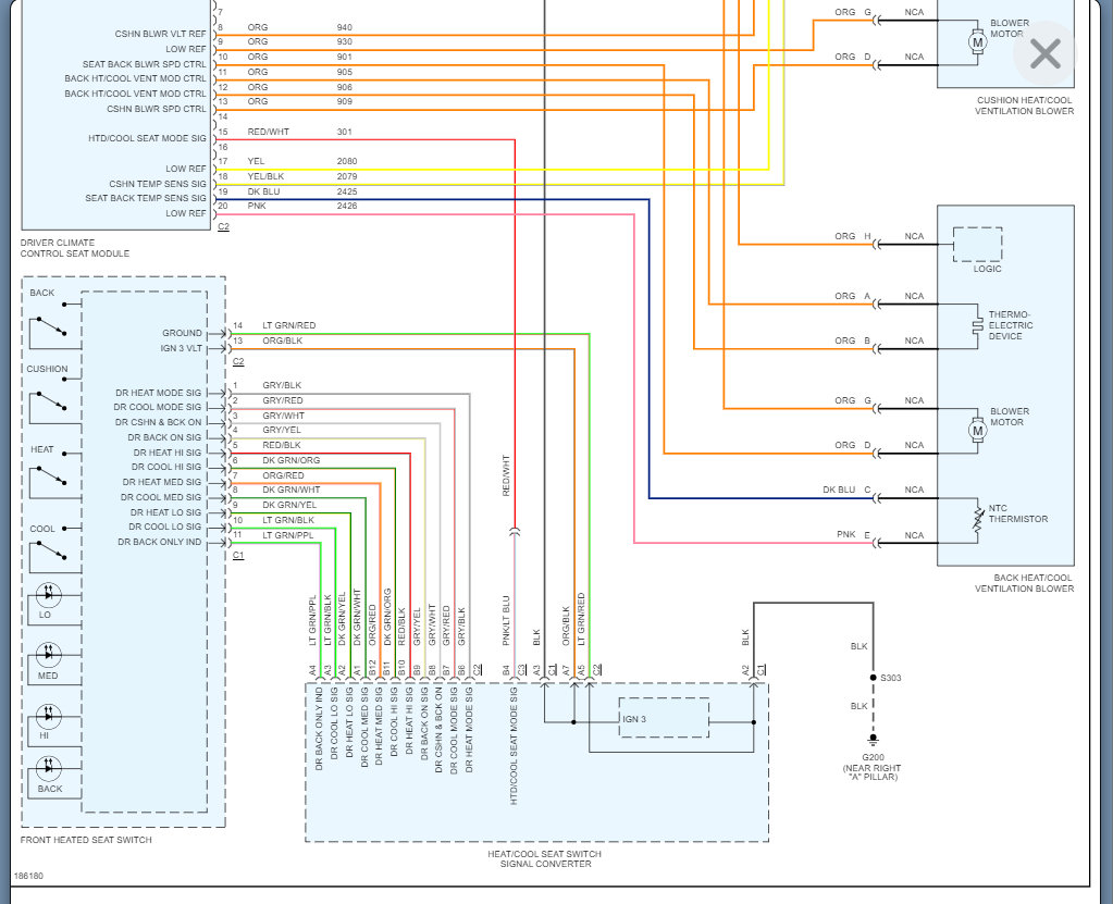

Drivers side heated seat won't work
2004 CADILLAC ESCALADE ESV
95,000 MILES • V8 • AWD • AUTOMATIC
NMNERK
It will turn on for 3-5 seconds then switch off. The passenger side heated seat works great.
Also, the driver side memory seat is no longer working.
Thanks
Feb 28, 2010 at 5:23 AM

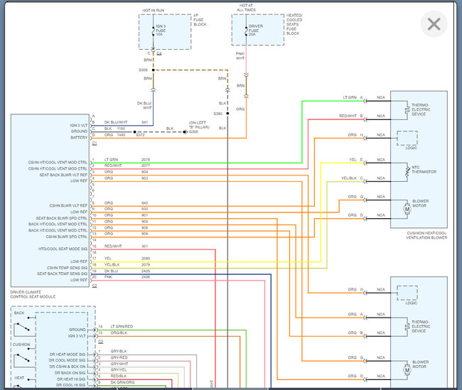

More than likely this is an issue with the seat heat element being shorted.
What happens is the module will turn this on but when it sees the current getting to high then it will shut it off so that it doesn't cause an issue. So, when the heating element is shorted to ground it can damage the circuit.
So, it shuts it off.

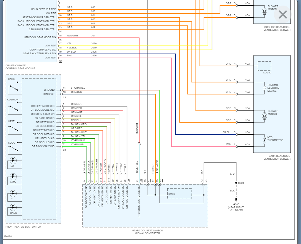

I am attaching the wiring diagram that will help with checking for the short to ground.
Here is a guide that will help as well:
Please see the wiring diagram and let us know what you find.
