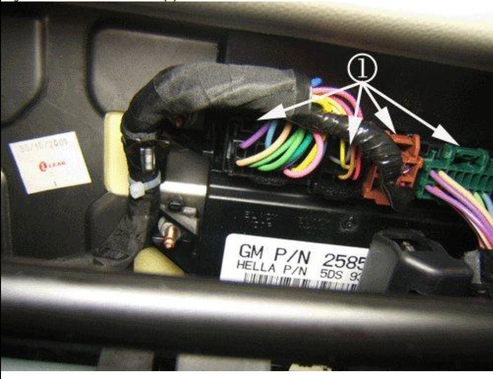

passenger seat controls work intermittently and seat heater does not work
2008 CADILLAC ESCALADE ESV
120,000 MILES • V8 • AWD • AUTOMATIC
JOHN GOUDIE
I have checked fuses. the dealership says its the memory seat module and will cost $700. to repair
Feb 16, 2015 at 2:12 AM
HMAC300
  • 48,601 POSTS

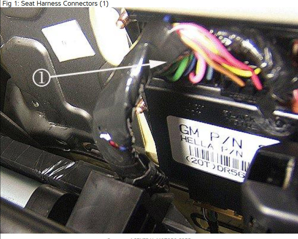

thee is a tsb on this very problem as far as heater may effect control problem as well it's 10-08-50-008B I'm sending pics of problem before and after. the seat has to be removed and re route the harness . you should have rpo AN# KA1 or KB6 for this don't know if they will charge for this or not though. the RPO number should be on glove box door inside.
Feb 16, 2015 at 4:22 AM
HMAC300
  • 48,601 POSTS
One other thing, if air bag has deployed then the memory module has to be reprogrammed will also cause the memory problem.
