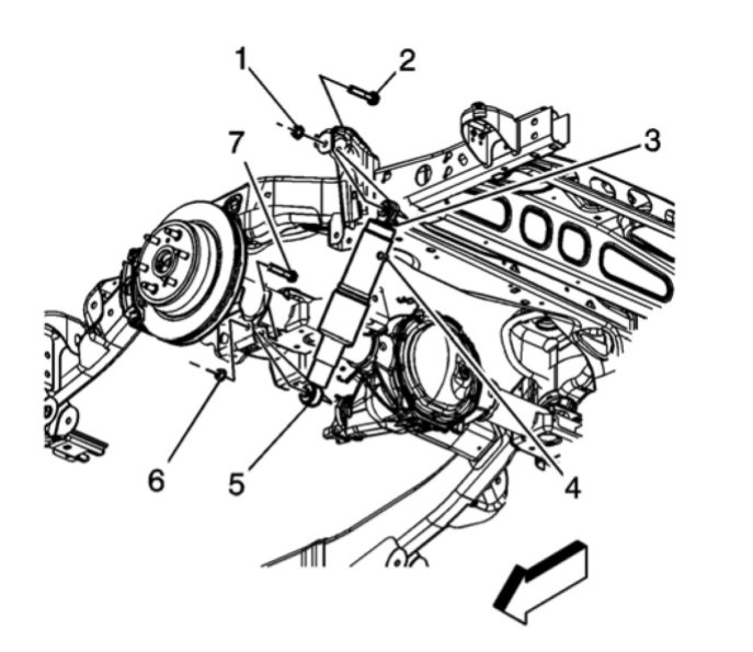

Hi dear Sirs,
On the display there is a notice that lightens saying: Service suspension, What does it mean? Is it necessary to check the suspension system? How can the notice be removed? Thank you very much for the help in advance.
As for this signal I have I want to specify the following things:
1. To have this error displayed there must be obviously something wrong with the suspension, but could you please tell me what are the items I should pay attention to? Is it possible to have a list of the car parts, that can be damaged to get this mistake displayed? The problem is that I cannot have my car diagnosed, I live in Belarus and here we do not have Cadillac Service Centers. That is why I only can count on you to help. :)
2. Is there a way to get rid of this notification on my display? Can it be done by myself?
I highly appreciate your help.
Wish you a nice day!
Regards,
Anna

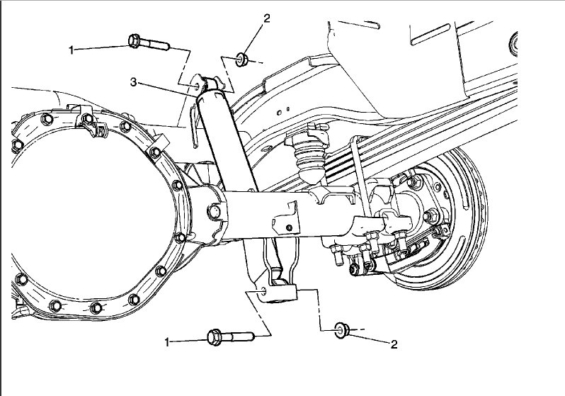

There is a fault within the suspension system which is usually the rear shocks are leaking and the system times out which then makes the codes you are seeing today.
Here is a guide that will give you an idea of what you are in for when doing the job.
https://www.2carpros.com/articles/replace-shock-absorber
you will need to use a jack as well to lift the car up.
There are some guides below that will help you on your car.
If the shocks are okay you will need to have the system scanned and checked for codes.
Here is some additional info - (Dont forget to check the images below)

These were just some examples of what I am trying to convey. You really need a diagnostic code, if at all possible, it will point us in a direction, and avoid frustration and unnecessary part replacement. Upon further investigation, an automatic level control system fault can also display the message. You can check to see if the compressor comes on when loaded with some weight, or that the bladders on the rear shocks have some firmness to them, that should be the case at any time, they should not be flat. A fault in this system could be the case, since you are not getting a speed limited message as well, or at least you have not mentioned one.
