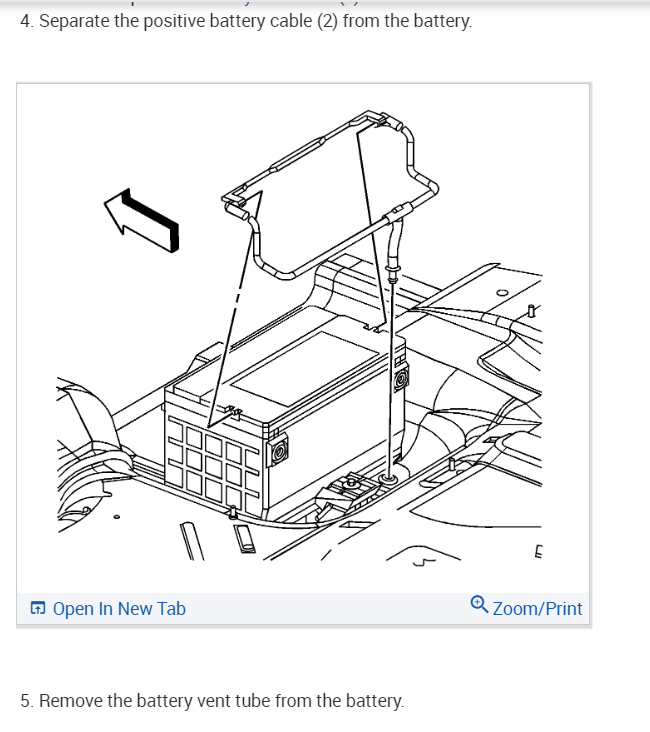

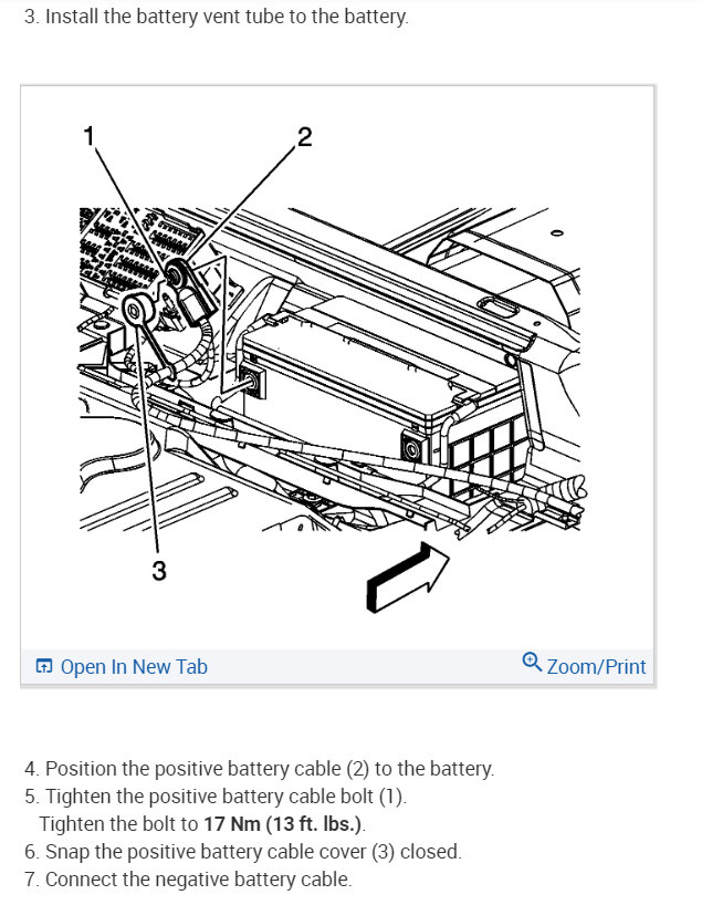

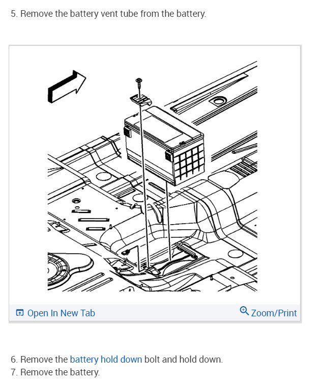

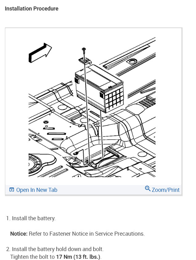

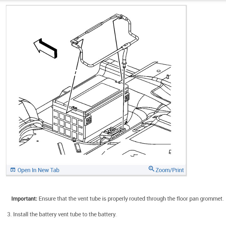

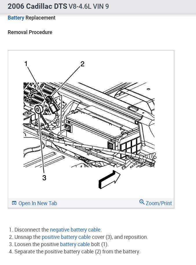

The fact that the battery read 11 volts after charging is not good, it is telling us the battery needs to be replaced. To be sure let's use this guide:
Here is how to change the battery out in case it fails the load test. Check out the images (below). Let us know what happens and please upload pictures or videos of the problem so we can see what's going on.
