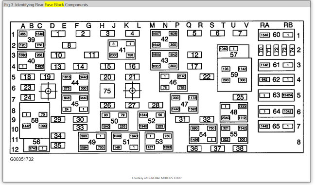

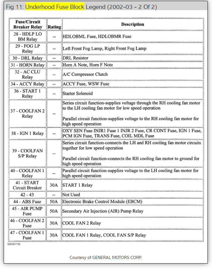

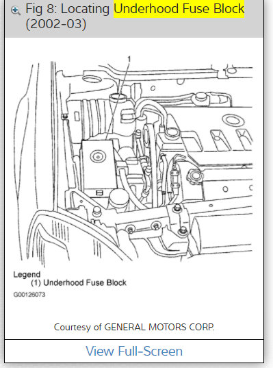

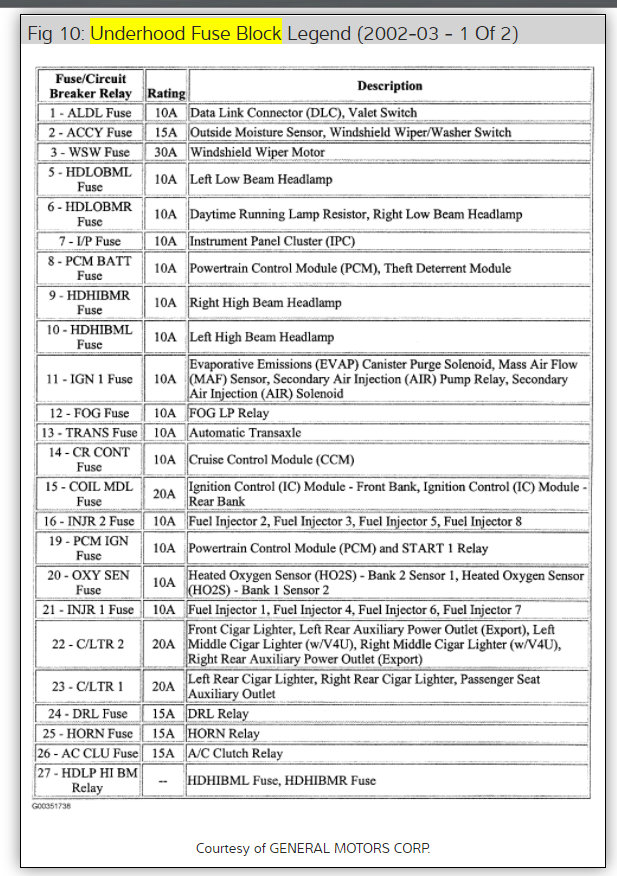

where do I locate the fuel relay pump on my car?
Sep 9, 2008 at 6:28 AM
  • 55,433 POSTS

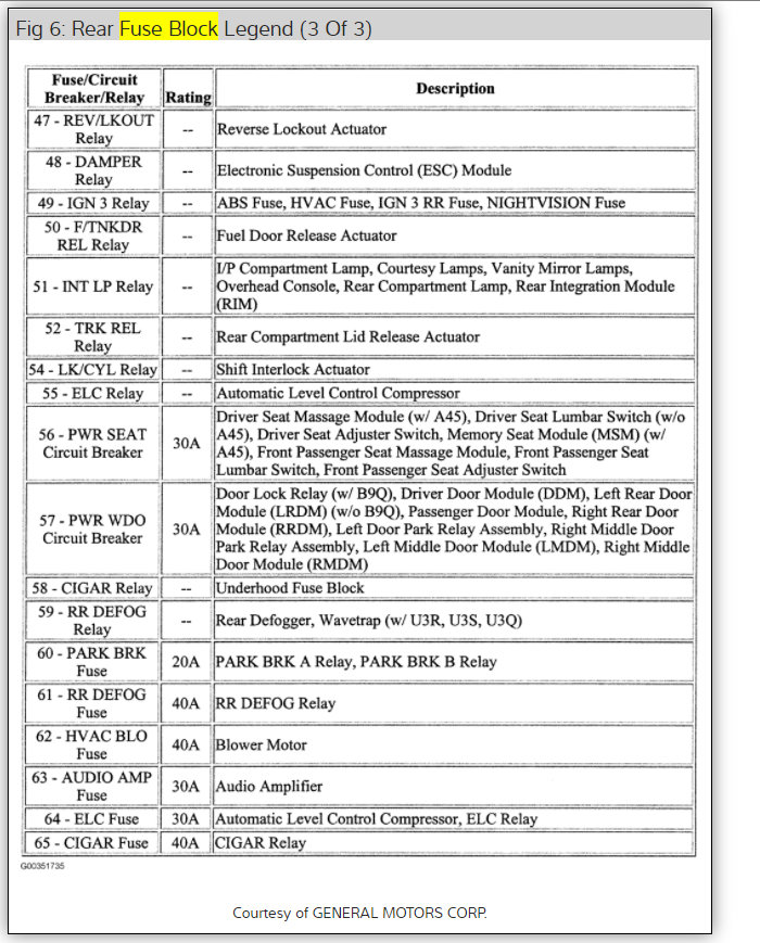

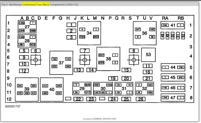

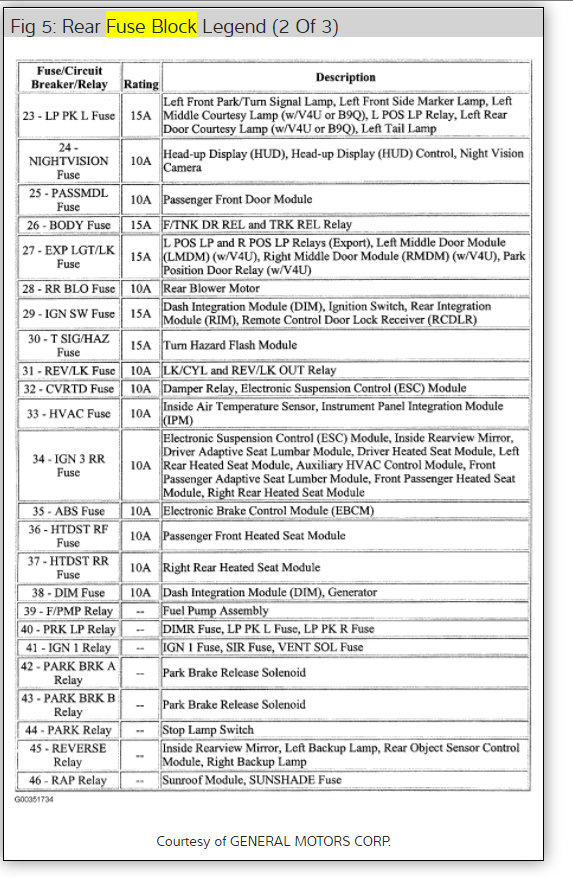

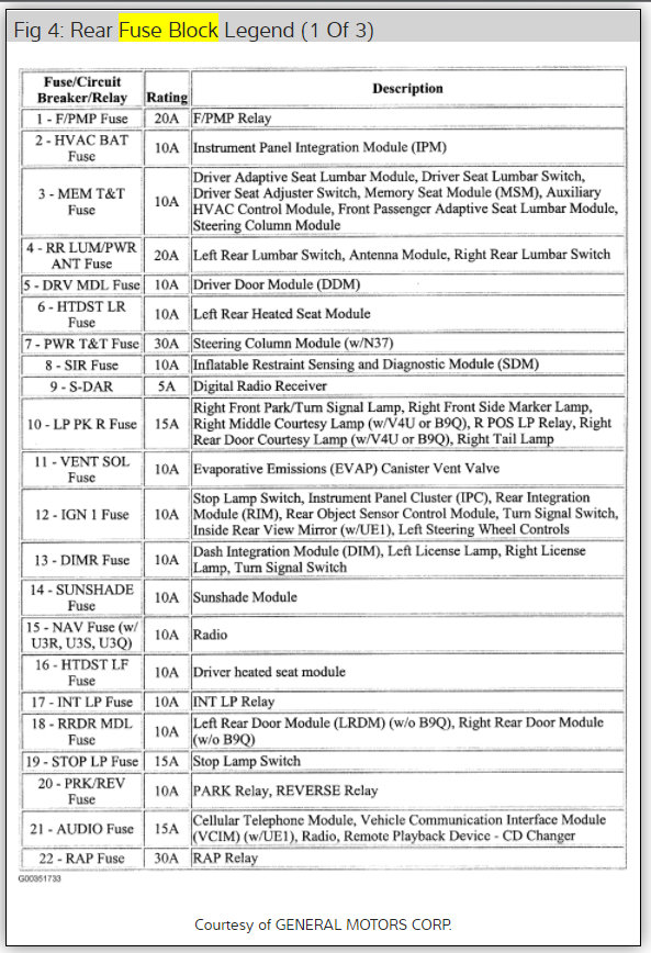

Here is a guide to help you test the relay so when you find it below.

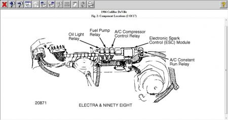

RICH001
My Cadillac runs perfect on all short trips, but after a longer trip (60 min. or more), it will not start and is not getting fuel. I replaced the filter, and am now trying to locate the fuel relay switch. I have a manual that says it is beside the fuse box, which it isn`t. I went to the GM dealer, and they said it was on the firewall, which it isn`t.. so I have a new relay and nowhere to put it..
Jan 6, 2020 at 7:10 AM (Merged)
MERLIN2021
  • 17,250 POSTS
Check engine compartment relay block near the washer fluid reservoir...

BUZZSAW
  • 1,198 POSTS
[quote:fc99173667="Rich001"]Electrical problem
1986 Cadillac Deville V8 Front Wheel Drive Automatic 140000 miles
My Cadillac runs perfect on all short trips, but after a longer trip (60 min. or more), it will not start and is not getting fuel. I replaced the filter, and am now trying to locate the fuel relay switch. I have a manual that says it is beside the fuse box, which it isn`t. I went to the GM dealer, and they said it was on the firewall, which it isn`t.. so I have a new relay and nowhere to put it..[/quote:fc99173667]
its on the firewall, under a black cover made of plastic,
there are 3 of them there, and some fuses, I dought this is your prob, is there a ck engine lite on? need codes, push off and warmer on heater controls, and they display on heater assy, write them down, with out looking at it I would say your prob is in the distributor, cam sensor or pick up coil
RICH001
Thanks for your advice.. I tried the codes the last time my car wouldn`t start.. I got a BCM code 32 and 48.. The code 32 is my MAP sensor circuit open. Should I be replacing it instaed of the relay?. I found the relay behind the glove compartment..

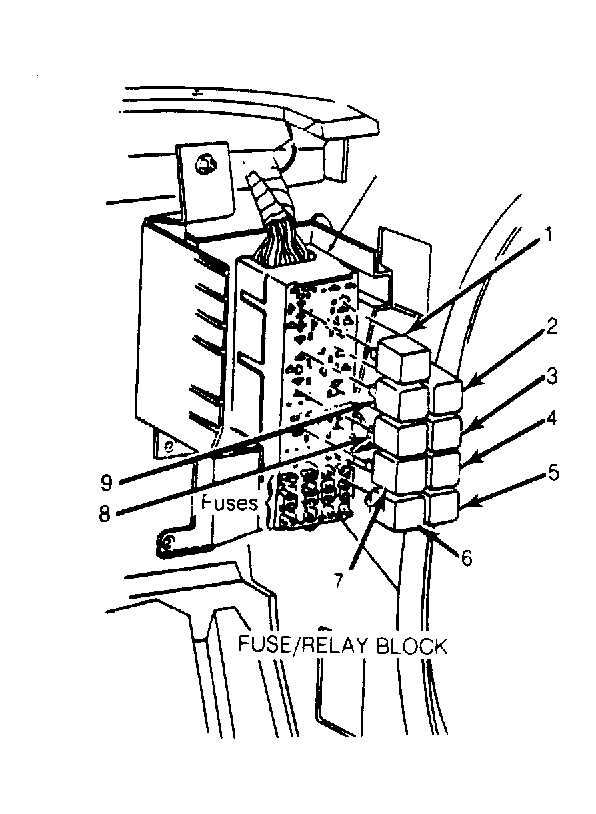

FIXITMR
  • 9,990 POSTS

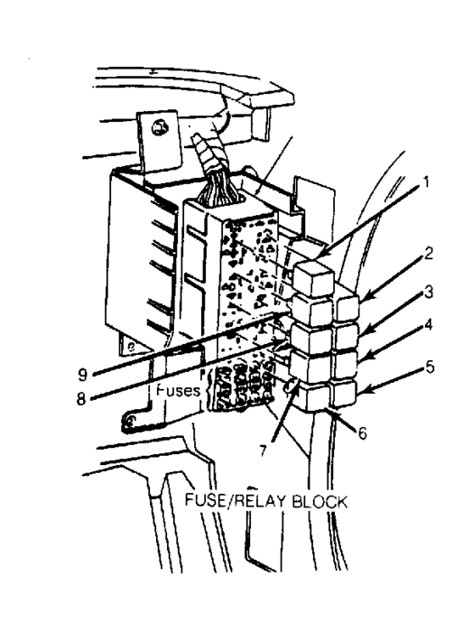

Did you look for it underhood in a fusebox or on a bracket? here's a pic from book. #3 is the pump relay.
FIXITMR
  • 9,990 POSTS
looks to be under dash pass side interior.

POPROCKS6301
  • 13 POSTS

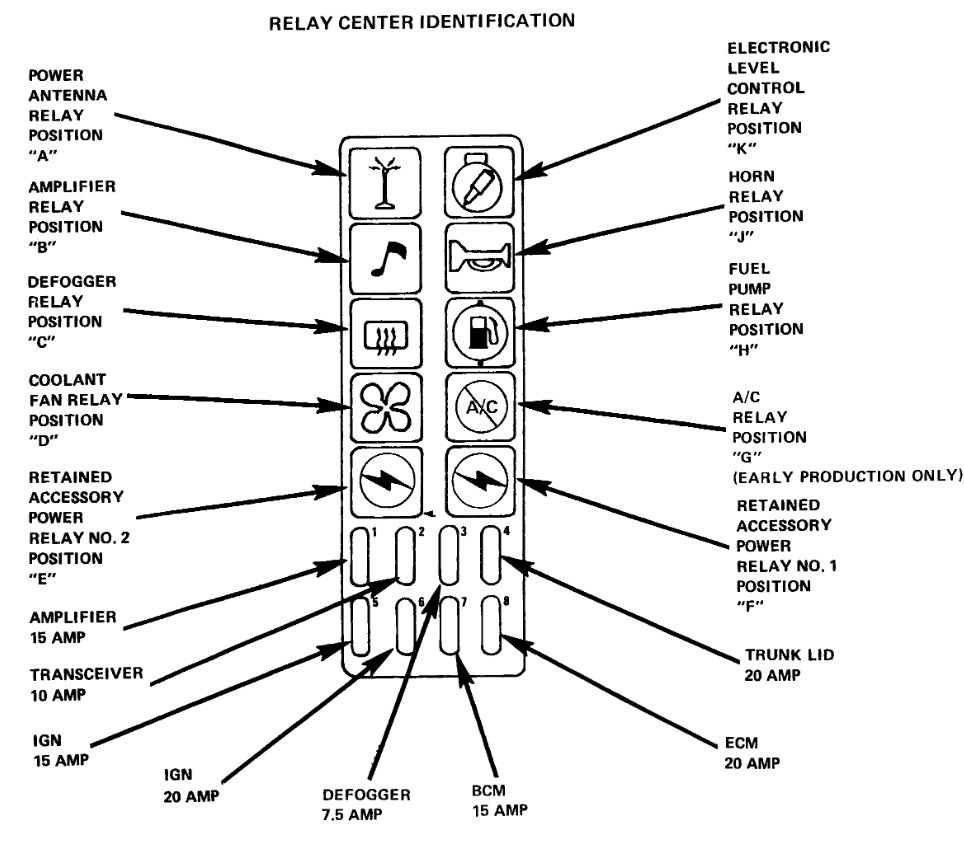

I need to find out what the fuel pump relay looks like. i found all of the relays under the dashboard and i don't know how to tell which ones which. i have got a 4.1 L V8 Cadillac Coupe Deville 1983 model. its got digital fuel injection if that makes a difference. thanks for your time.
it is on the rely center under the dash as you were describing.
why are you looking for this?? what is the issue??
