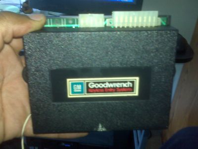

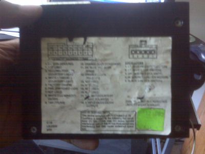

SOOPERMAN64
  • 5 POSTS
I just purchased a new keyless remote and my car has the gm goodwrench keyless entry system installed, how do i program this system?
https://images.2carpros.com/forum/automotive_pictures/362385_IMG00002_1.jpg
https://images.2carpros.com/forum/automotive_pictures/362385_IMG00003_1.jpg

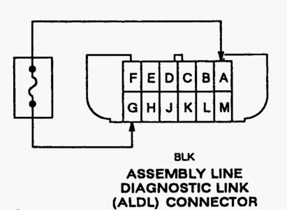

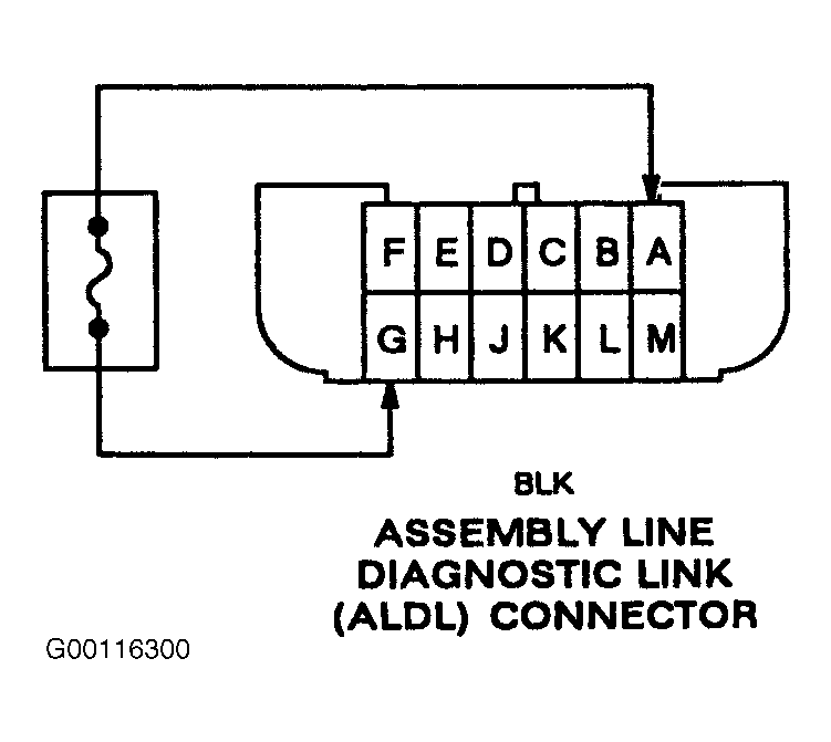

MERLIN2021
  • 17,250 POSTS
KEYLESS ENTRY PROGRAMMING Perform the following when replacing Keyless Entry Module or either Transmitter: Turn ignition switch OFF. 1. Jumper ALDL terminal G (PPL/WHT) to terminal A (BLK/WHT). Door locks will lock and unlock and trunk release will activate in approximately 2 seconds. See Fig. 29 . 2. Press any button on one transmitter. Door locks will lock and unlock and trunk release will activate in approximately 2 seconds. The first transmitter is now programmed. 3. Repeat previous step with the other transmitter. If only one transmitter is being used, go to next step. 4. Disconnect jumper from program connector. 5. Fig. 29: Identifying ALDL Connector Terminals Courtesy of GENERAL MOTORS CORP. Page 1 of 1 KEYLESS ENTRY SYSTEMS -1993 Cadillac DeVille 5/30/2009
https://images.2carpros.com/forum/automotive_pictures/62217_devkeyless_1.jpg

SOOPERMAN64
  • 5 POSTS
Thanks for the suggestion but my aldl connector does not have that keyless entry slot in it. Therefore the person who previously owned the car put in the aftermarket gm goodwrench keyless entry system that i have pictured. I need to knoe how can i manually program this box?

SOOPERMAN64
  • 5 POSTS
I am not the originator of the question but i do have the gm goodwrench factory installed keyless entry system, do you know how to program that box for a keyless remote?
https://images.2carpros.com/forum/automotive_pictures/362385_IMG00002_2.jpg
https://images.2carpros.com/forum/automotive_pictures/362385_IMG00003_2.jpg

  • 75,988 POSTS
Try this:
PROGRAMMING
