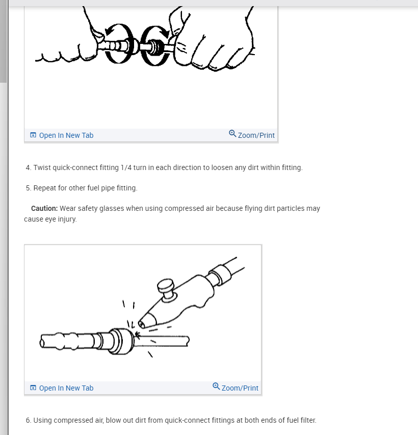

Car turns over but wont start. If you ether it it will run off of the ether?
PAPPYFRANK
  • 1997 CADILLAC DEVILLE
Tuesday, February 9th, 2010 AT 5:30 PM

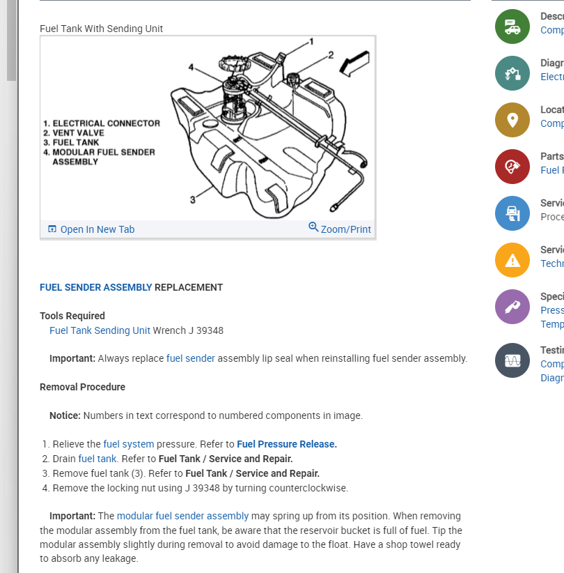

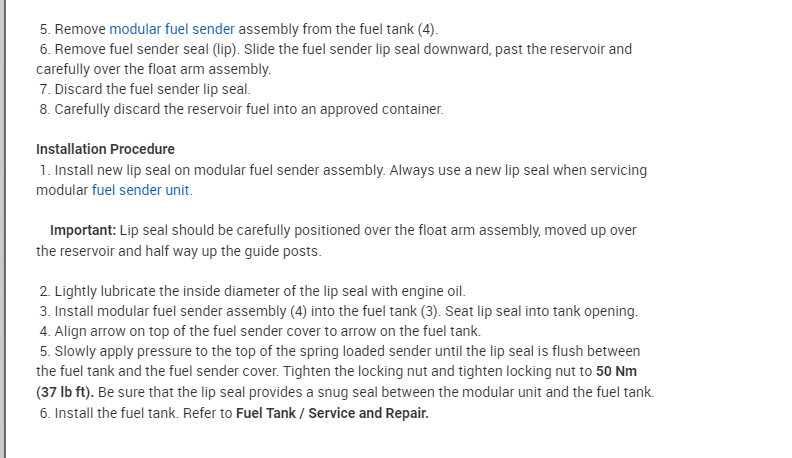

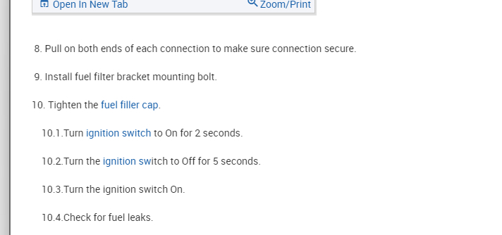

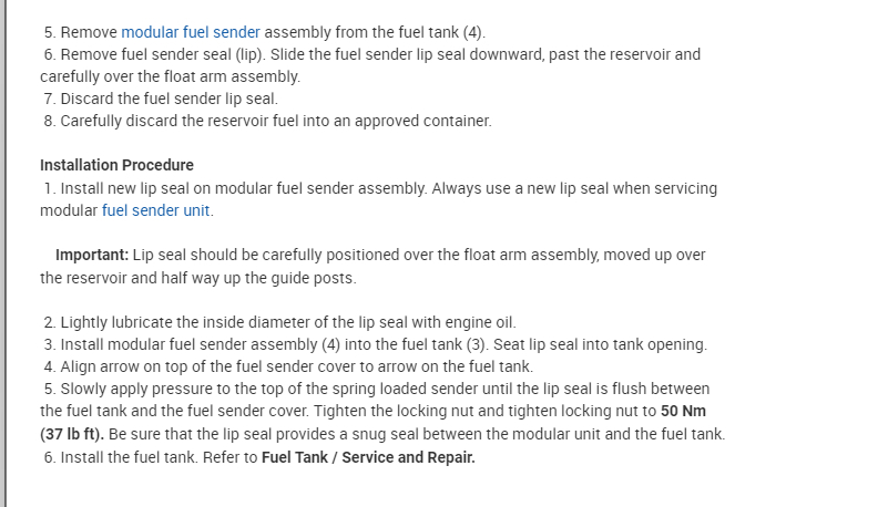

Due to it running off the starter fluid we have a fuel issue. This means we need to start with a fuel pressure check and find out what the pressure is.
Here is a guide that will help with this:
Once we know what the pressure is, we will have a better idea but more than likely the pump is the issue.
https://www.2carpros.com/articles/how-to-replace-an-electric-fuel-pump

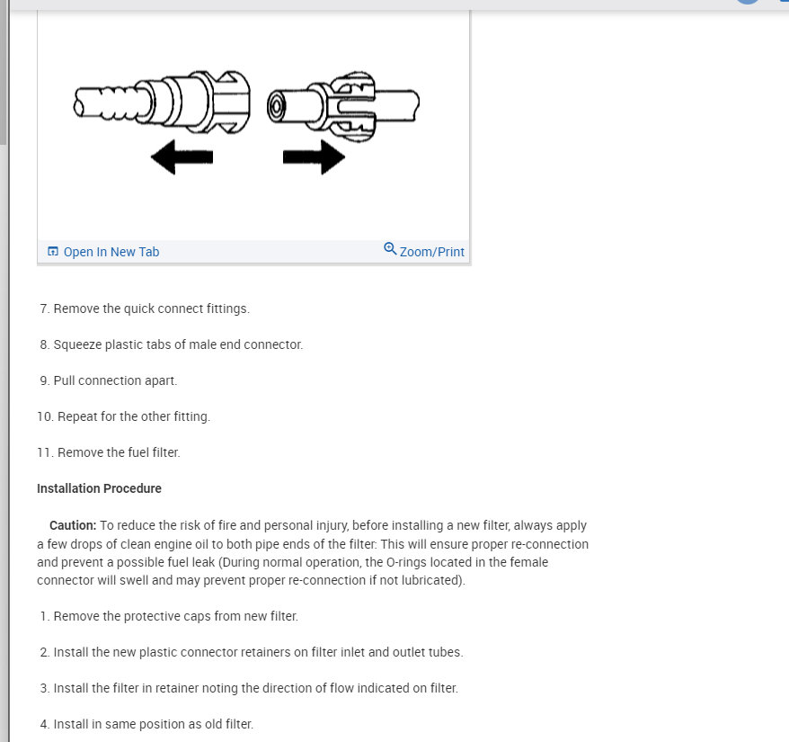

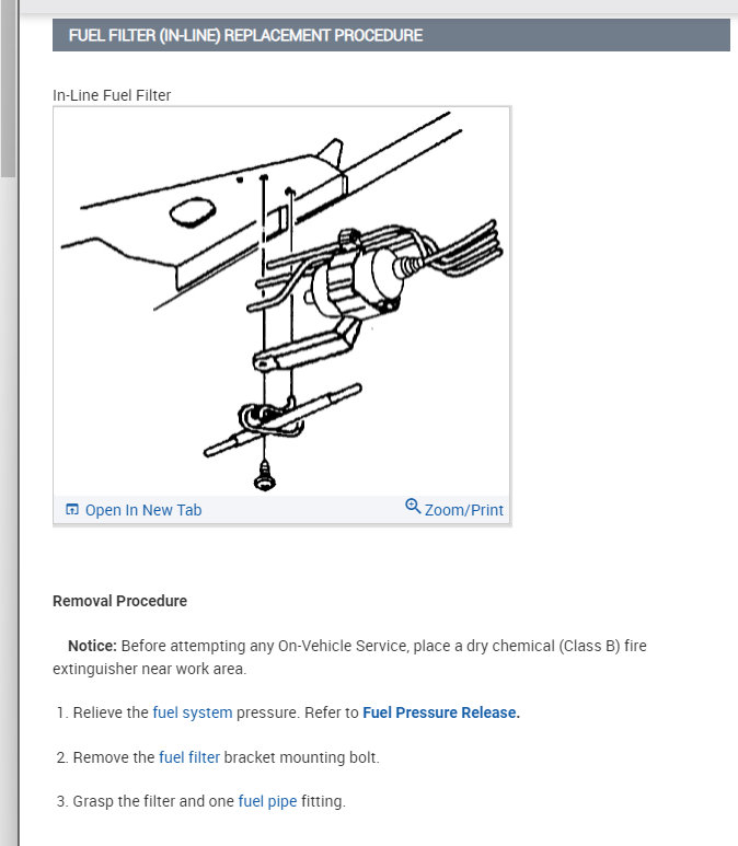

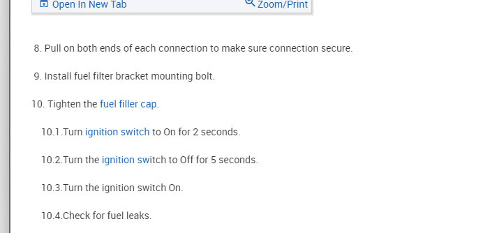

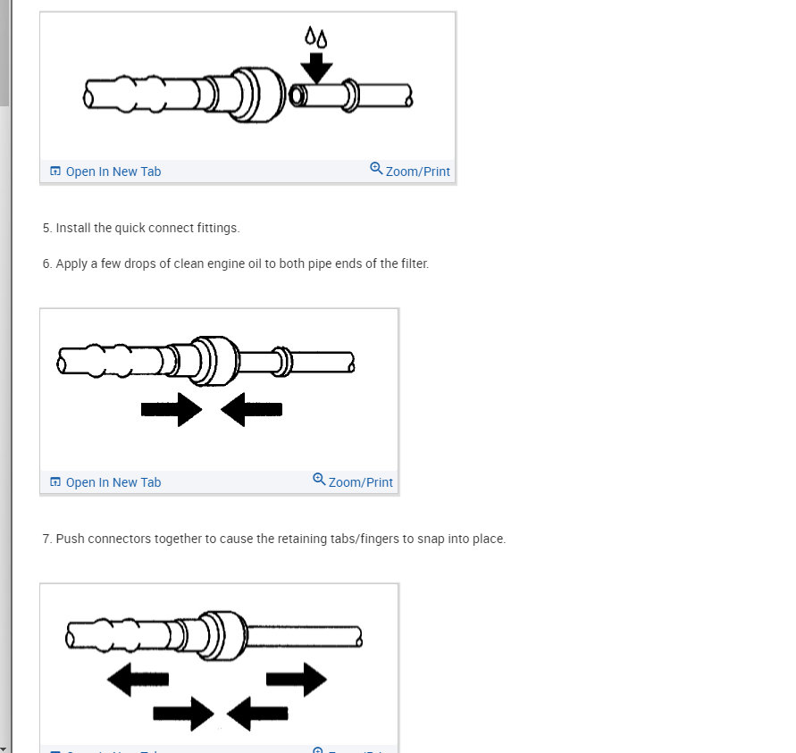

We also need to change the fuel filter before we replace the pump if you have not changed this in a while.
https://www.2carpros.com/articles/how-to-change-a-fuel-filter
I am attaching the process below for the pump and filter from the manual, so we need to run through all this and let me know what questions you have.
