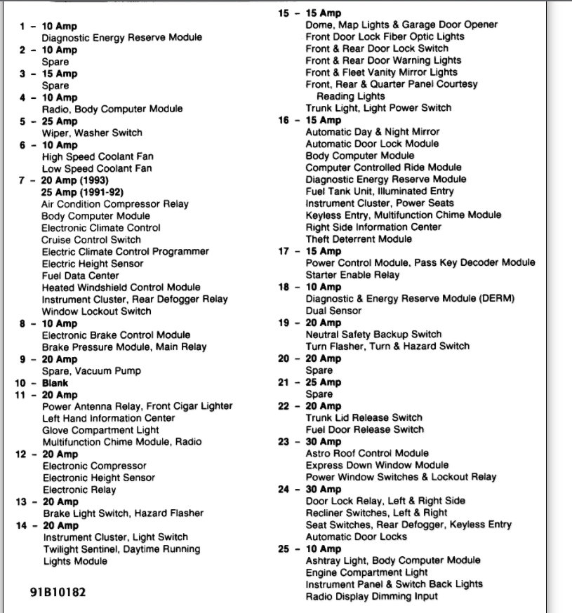

Everything on my car works fine except the two power outlets in the two back door (formerly called cigarette lighters). I assume it may be a fuse problem, so how do I find the right fuse?
In fact, where can I find a fuse diagram for all the fuses in this car. Fuses in the fuse box under the driver's side of the dash are mostly marked, but some have no label. And I can find no label to identify any of the fuses under the passenger's side of the dash.
Somewhere I read that there are also fuses under the hood or in the trunk, but I can't find either.

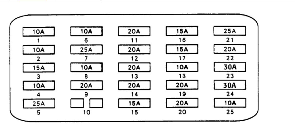

Here is a guide that will help you test the fuses
Some vehicles are equipped with fuses under the hood or trunk as well, but not all. If you do not see a black box (usually beside the battery) under the hood then you do not have fuses under your hood. My sources show your fuse panel behind the passenger side dash, behind glove compartment..A fuse diagram is below for your vehicle.

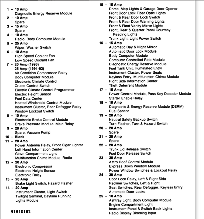

Check out the diagrams below.
