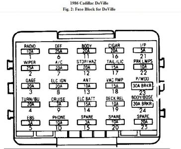

i changed a radio on in my car and blew a fuse. so i changed the fuses. but my digital gas and a/c gauges dont turn on. so iv done some research and i cant find the third the fuse box? Im needing to know where its located and how it looks like?

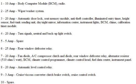

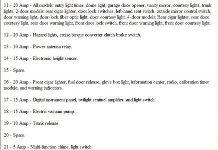

There is no extra fuse panel for Deville... Fuse number 17 --15Amp fuse-- is the fuse for the digital inst. panel.

If the fuse is good the dash cluster need to be replaced this is a common problem. Thanks for using 2CarPros.com!
