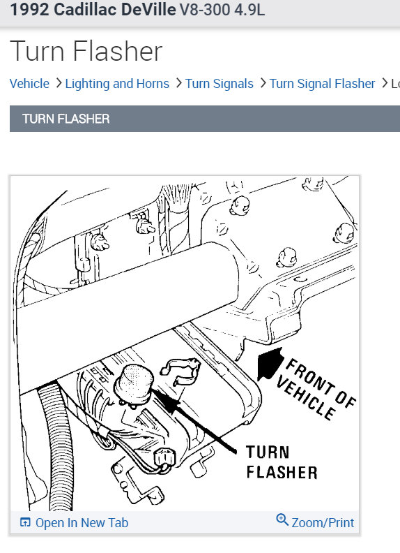

please help....1992 cadillac deville..150,000 miles.....no turn signals... front ones will comes on but not flash...nothing in back or on dash...hazards work fine. I do not have a fuse diagram so if you would suggest a fuse can you tell exactly which fuse?

Probably not a fuse, more likely a turn signal flasher. There is a hazard and turn signal flasher under the dash. You can swap them to see of the problem moves to the hazards. I "think" it should look like a 1 1/4" diameter, silver cylinder about 1" long here is a diagrams below. Check out the diagrams (Below). Please let us know what you find. We are interested to see what it is.

92 Cad sedan deville,165k miles,I have had problem w/blinker earlier this year and replacing the turn signal flasher worked for several months.Again the blinkers are staying on,not flashing,and the bulbs are ok.I replaced the flasher again but this did not fix this time.Both sides,LF and RTand dash lights just stay steady lit. Please share your thoughts.

Try swapping the turn signal flasher and the hazard flasher and see if there is a change.

You said the turn signal flasher is located under the dash on the 1992 Deville it took awhile to find but once I replaced it the signal are working again! I love this site.

Niether side is working? Try replacing the turn signal flasher first.

Thanks for the help, I replaced the flasher and they are now working again but without the sound to let you know your blinkers are on which is fine with me.

It should be the flasher that creates that noise. If it works for you thats good.
