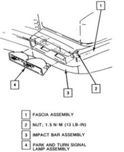

HOW DO YOU CHANGE A FRONT TURN SIGNAL BULB ?

1.Disconnect the lamp monitor fiber optic cable. 2.Remove the retaining nut, then pry the inner release tab upward, and push the assembly forward. 3.Remove the bulb and socket from the lamp assembly. 4.If replacing the bulb, remove the bulb from the socket.
https://images.2carpros.com/forum/automotive_pictures/261618_0900c1528025eec7_1.jpg
To install: 5.Installation is the reverse of the removal procedure. Tighten the nut to 13 inch lbs. (1.5 Nm).
