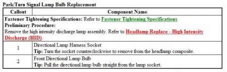

how do i get to turn signal bulb ? owners manual said to to take to dealer for all bulb replacements !

Hello- the cadilac is a 2006 DTS , the left front turn signal bulb is burned out , I found two bolts in top of light assm. are there more bolts or does the assm. pull up ?
Thanks in advance

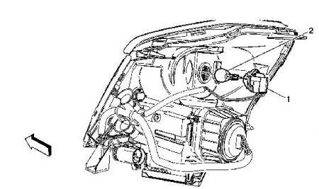

Thanks for that info. There will be one more bolt before you can pull it out and disconnect wiring.
https://images.2carpros.com/forum/automotive_pictures/261618_Noname2_17.jpg
HID REMOVAL:
https://images.2carpros.com/forum/automotive_pictures/261618_Noname_48.jpg
https://images.2carpros.com/forum/automotive_pictures/261618_Noname_47.jpg
