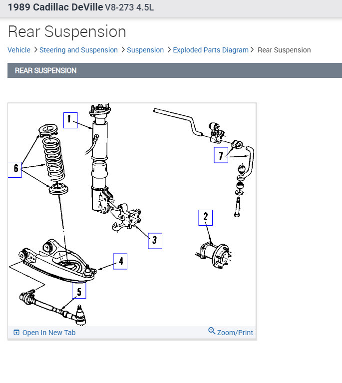

I put new wheels on my car and had to get the rear lifted so the wheels would not be rubbing, but now my rear right wheel is leaning in. Is there a cheap solution i can do to get the wheel back to normal?

It sounds like the lift has changed the camber for the wheel.
Depending on how severely it is off the camber can be corrected using camber correction bolts.
However, when the suspension has been altered in this manner it is typically not possible to simply fix it without doing major modifications. It still might not be at the factory specifications.
If you can upload some pictures, it could be helpful.
