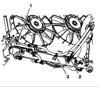

How do you remove radiator?
Monday, October 25th, 2010 AT 12:41 PM
  • 75,992 POSTS
Radiator Replacement
Tools Required
J 38185 Hose Clamp Pliers
J 44827 Transmission Cooler Quick Disconnect
Removal Procedure
Drain the coolant.
https://www.2carpros.com/forum/automotive_pictures/12900_r1_15.jpg
Remove the radiator support brackets.

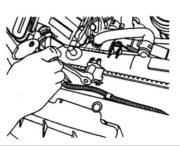

Notice: The transmission oil cooler lines use a quick connect fitting at the radiator. The quick connect fitting must be removed using a special tool. Removing the transmission oil cooler lines without the tool will result in damage to the radiator and the transmission oil cooler, and may damage the transmission due to mixing of the transmission oil and coolant.
https://www.2carpros.com/forum/automotive_pictures/12900_r2_15.jpg
Using the J 44827 (2) disconnect the lower transaxle oil cooler line from the radiator.
Using the J 38185 disconnect the lower radiator hose (1) from the radiator.

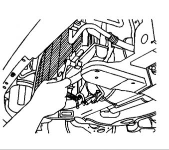

https://www.2carpros.com/forum/automotive_pictures/12900_r3_5.jpg
Remove the lower condenser mounting bolts.
Remove the radiator side seal push pins.
Separate the side seals from the radiator.
Lower the vehicle.
Remove the radiator.
Installation Procedure
Install the radiator into the insulator in the frame.

Raise the vehicle.
Install the lower condenser mounting bolts. Tighten the bolts to 6.5 Nm (58 inch lbs.) .

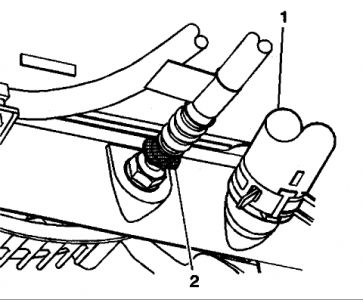

Push the lower transaxle oil cooler lines into the radiator until you hear it engage.
Gently tug out on the transmission oil cooler lines to verify that the lines are engaged into position.
Connect the lower radar hose to the radiator.
Using the J 38185 slide the clamp into the original position on the hose.
https://www.2carpros.com/forum/automotive_pictures/12900_r4_4.jpg
Connect the auxiliary transmission oil cooler line to the radiator (3).

Install the cooling fans.
Install the radiator supports.
Fill the system with coolant.
