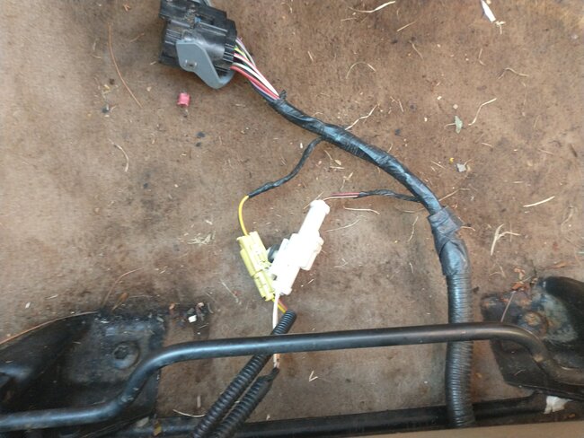

My latest question is can you help me determine what this cable is?
I see it has a yellow connector in middle for airbags, but I don't see where the connector at end connects to.
I looked under the seat and cannot find.
Here are some pics.
Thanks again!

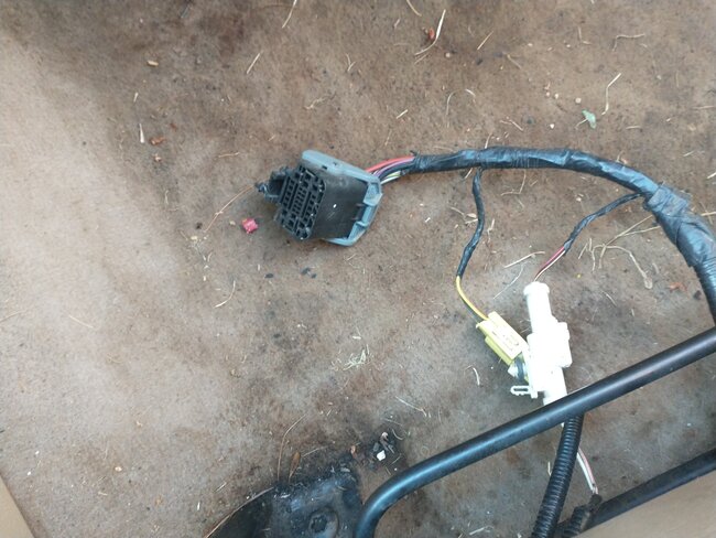

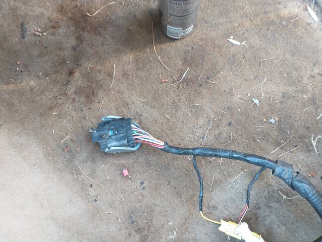

2 more pics.

Do you mind sending me your entire 17-digit VIN? I want to see what options came with this specific model originally.
My thoughts are someone replaced a power seat with a manual one or maybe the seat had a pressure sensor to detect if someone was sitting in the seat to turn the passenger side air bag on or off.
Just a thought since it has the airbag wire included in the harness.
Also is this the passenger or driver side seat?
Once I get the VIN from you, I can look up some wiring diagrams and see if we can determine what that harness is for.
Sometimes power seats are changed out for less expensive manual seats to save money. Then they sell the car and let it be someone else's issue. Not saying that's what is going on exactly but once I get the VIN I will know more and be able to help better.

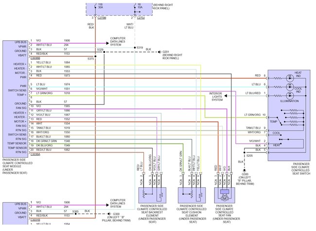

BRENDON S
  • 653 POSTS

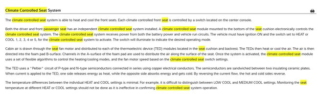

I found some interesting information. Apparently, these seats have a climate control module underneath them. Coincidently, there is one ground on the bottom of the b-pillar and the rest as well as a junction are behind the kick panel at the bottom of the a-pillar.
If it's rusted in those areas, then my thought is a previous owner had issues with the seat and removed the module.
There are also a few Technical Service Bulletins (TSB) for this exact system. It refers to system failure and replacement of this module. I assume it was very expensive or not available.
I hope this helps.

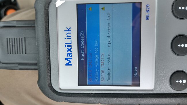

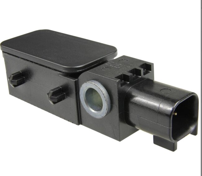

Here are codes for air bag I got from OBDII
Scanner see image.
Mar 7, 2023 at 5:47 PM
BRENDON S
  • 653 POSTS
Good morning, Oreo101,

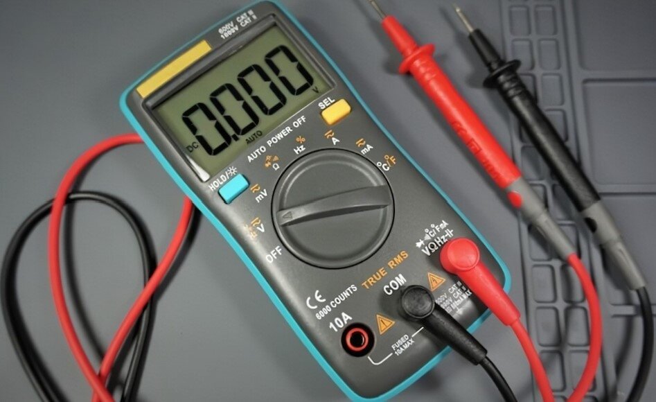

I would visually inspect the front impact sensor located in the front center of the vehicle as well as its harness. If you don't see anything obvious, then disconnect the battery and allow sometime for the capacitators to lose voltage. Then remove the sensor from the vehicle and unplug it. Using a multi meter on the sensor only checks for resistance shown by the omega symbol. See if it reads OL which would indicate high resistance and could cause the low voltage code as well. The system will set the low voltage code if it senses less than 8 volts.
This is essentially a switch and switches should have little to no resistance. So, if you do, I would replace the sensor. Reconnect the battery and turn the key to the on engine off position and let the module run its self-test and see if the codes return.
Do not check for resistance or continuity on the vehicle harness side as you may deploy the air bags.

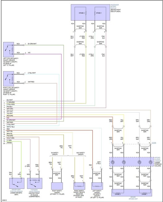

I am adding a picture of what it looks like. I found one on Rock Auto but it's over $100.00.

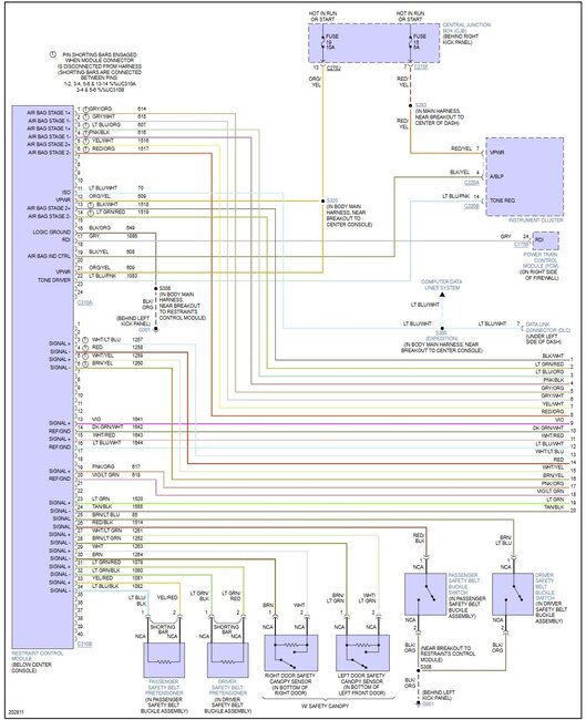

I have also added wiring diagrams for the Air Bag System to aid in diagnostics, but it also will tell you where the components are located.
I think that air bag wire on the floor you sent a picture of is for the passenger side buckle. If you follow the wire, does it look like it goes to it?
Anything that is tested in the system must be isolated from the rest of the system to prevent air bag deployment even if the battery is disconnected.
