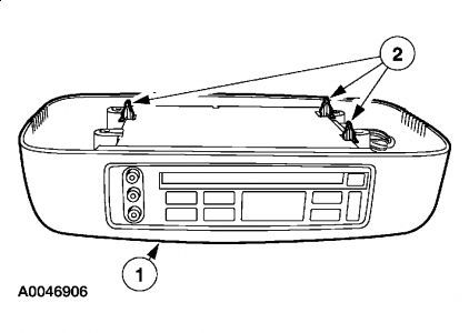

2005 Ford Expedition V8 Two Wheel Drive Automatic
How do you take down the DVD player from the headliner?
I have taken out the bolts and two rubber plugs.
It still hasn't moved.
Thanks.

After removing the screws then you close the door and disengage the clips see pic below.
https://images.2carpros.com/forum/automotive_pictures/249564_Graphic_158.jpg
