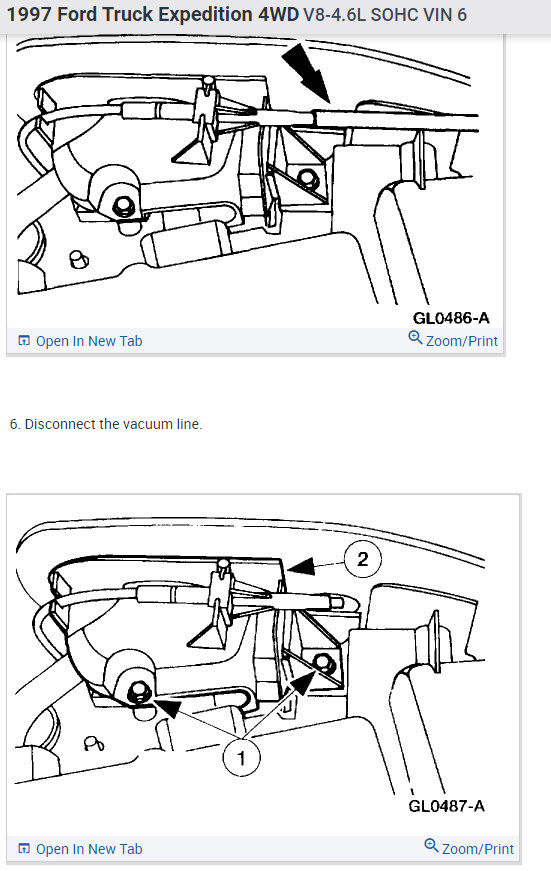

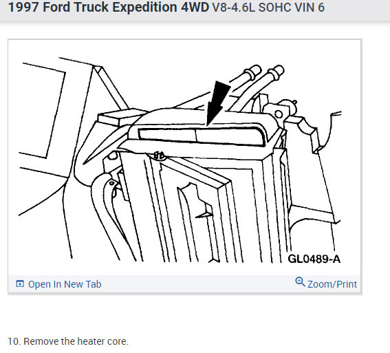

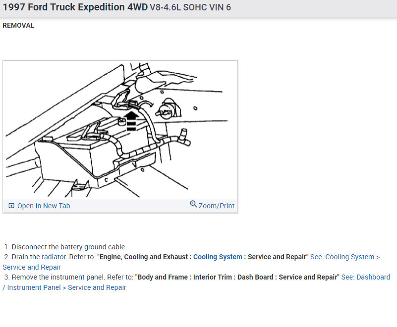

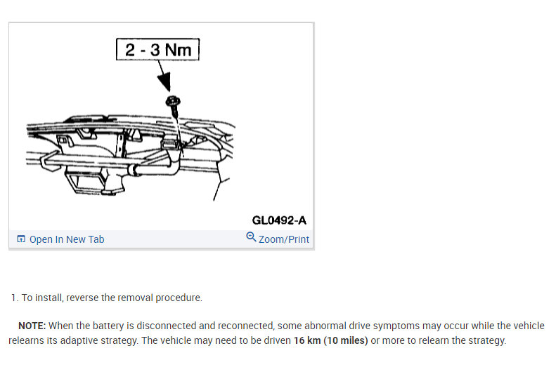

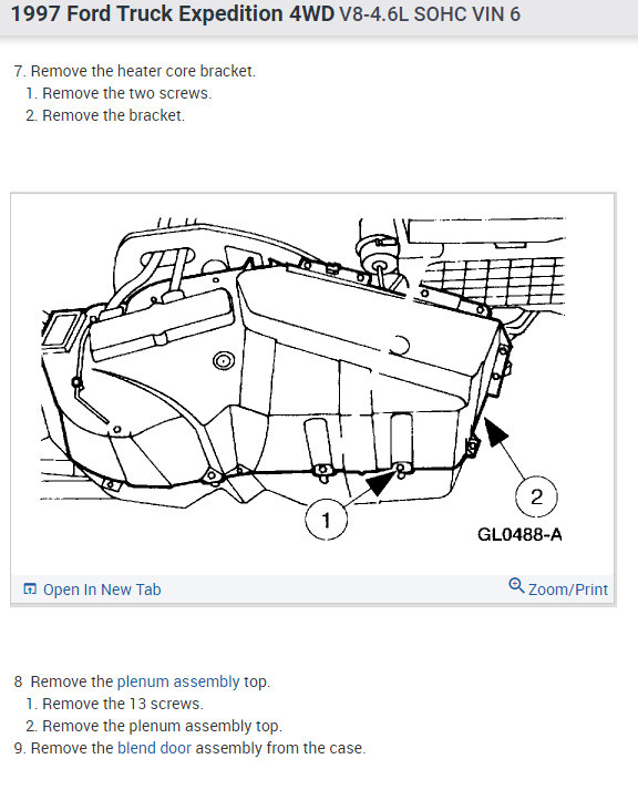

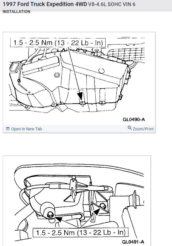

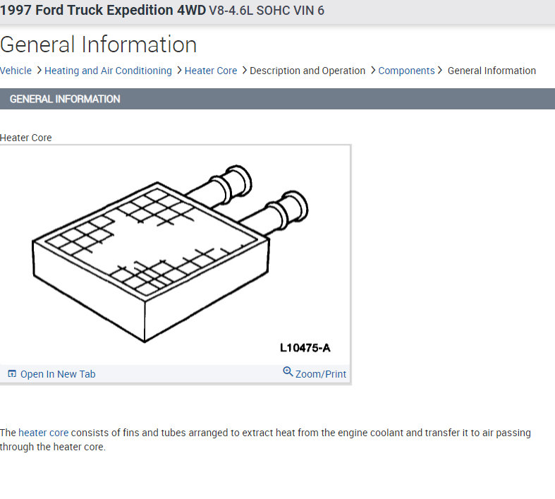

I recently had to make a quick stop and I noticed the water was leaking from the passengers side dash why?
Jan 18, 2009 at 10:28 AM
SQM
  • 6,383 POSTS
When you notice the water, was it raining?
If it leaks in rain then you could have a windshield or window seal that is leaking.

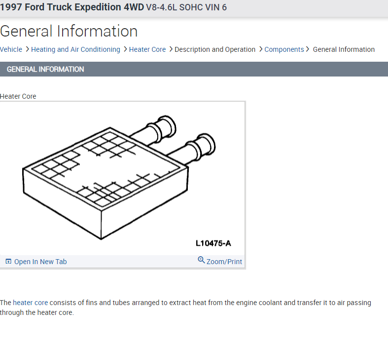

If you notice water without any rain, then it could be leaking from the heater core.
Is there a sweet smell to the fluid?
If so then it is coolant.

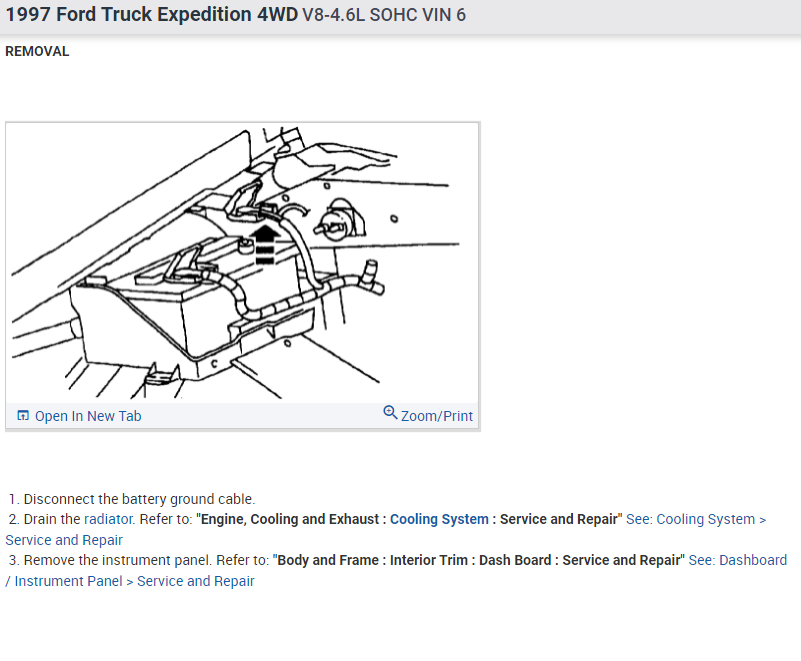

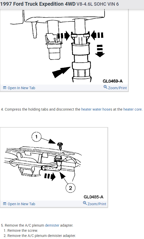

In order to access the heater core you will have to remove part of the dash.
https://youtu.be/SNRb6pSwYuU
I have attached diagrams for the heater core.
