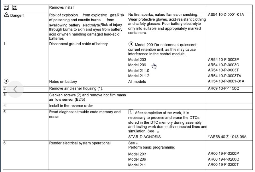

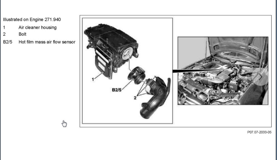

Here is a step by step guide to do so but as an engineer I am sure this will be a walk in the park. Let me know what happens. Thanks.
https://www.2carpros.com/articles/mass-air-flow-service
