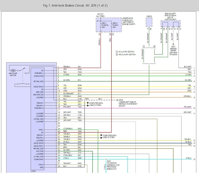

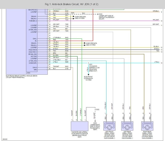

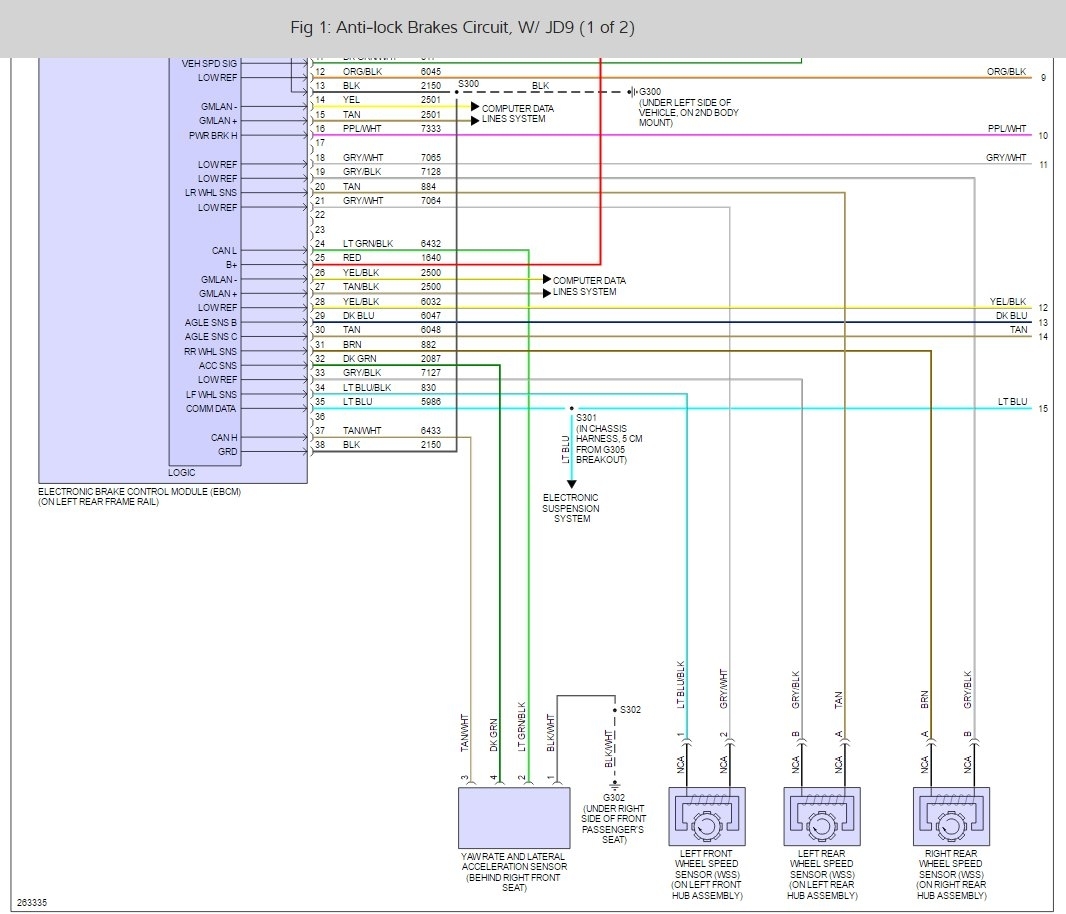

Must be missing something, Here is the wiring diagram for the circuit. Double check the connector to make sure one of the terminals has not pulled out of the connector.
I assume the light was on before changing the hub with sensor?
Apr 9, 2017 at 12:19 PM
