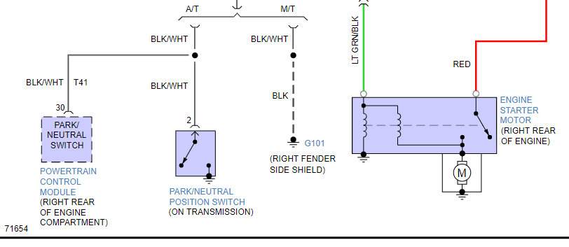

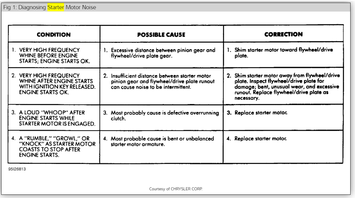

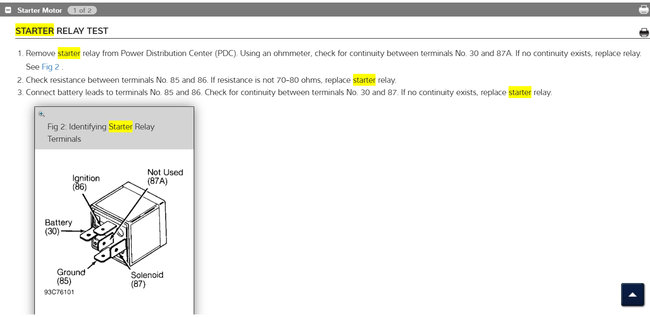

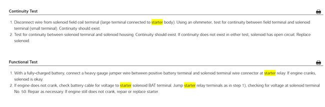

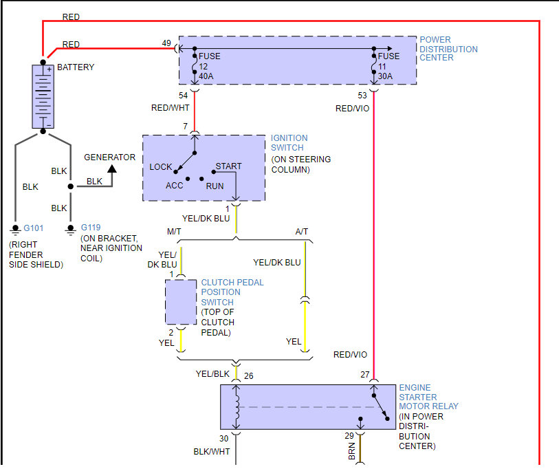

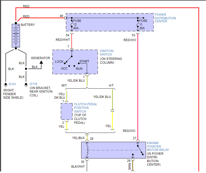

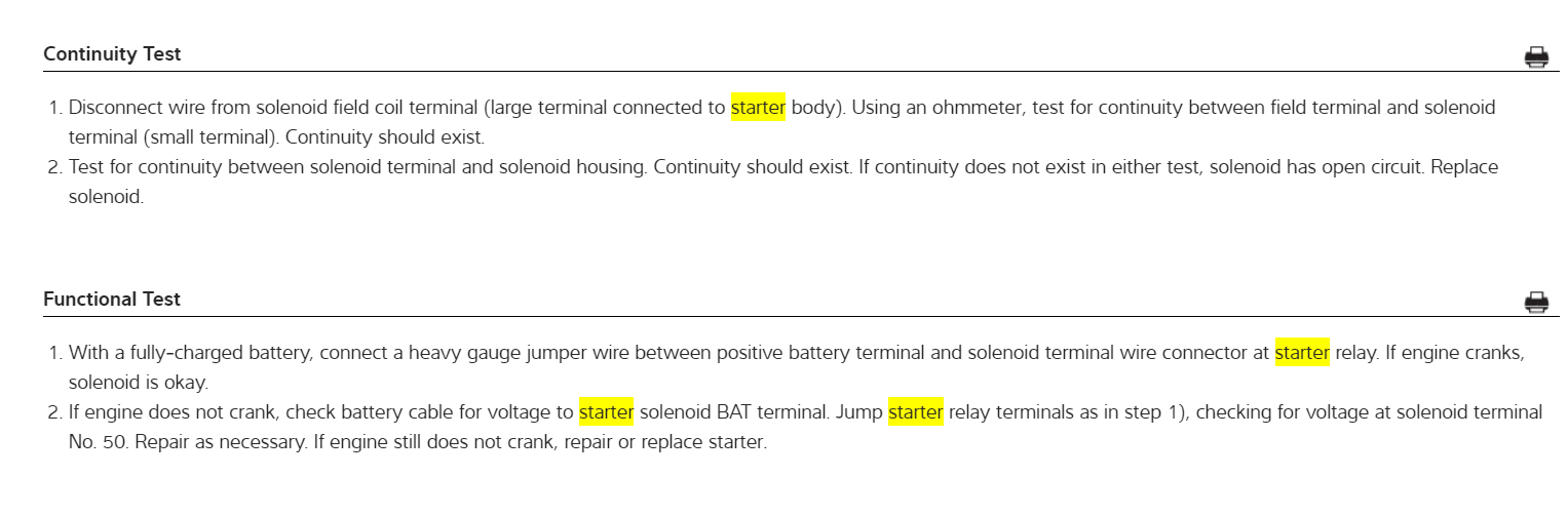

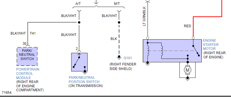

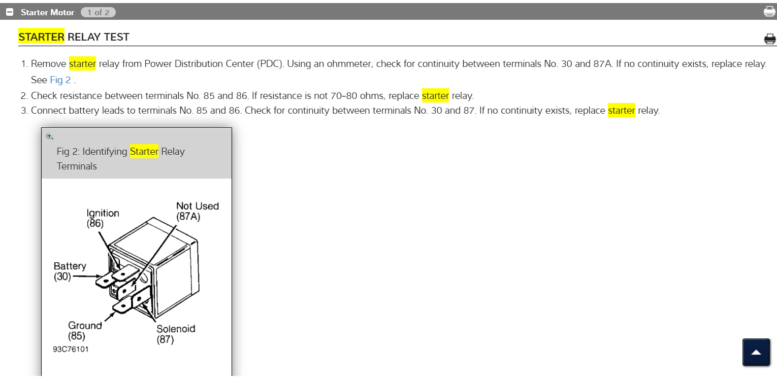

I'll get you the wiring diagrams for the whole circuit. What sub-model is this? Laredo, Limited, Orvis, or SE?
The diagrams for the starter circuit are below, I would use a multimeter if you have one for just checking that you have a full 12-volts on the starter wires. and check the connectors at the starter too, make sure they're not corroded or rusted up, a bad connection will act as resistance on the circuit and produce heat. Overheating the relay, the solenoid, any connections. Since it draws such heavy current during start up, especially cold start up, you can see how this would cause problems. It's never a good idea to bypass circuits. They're designed the way they are for a reason. And yes, the relay is to energize a high current circuit with a low current circuit. Even a new starter can be bad, they are just remanufactured parts. I've gotten bad parts that were new countless times.
